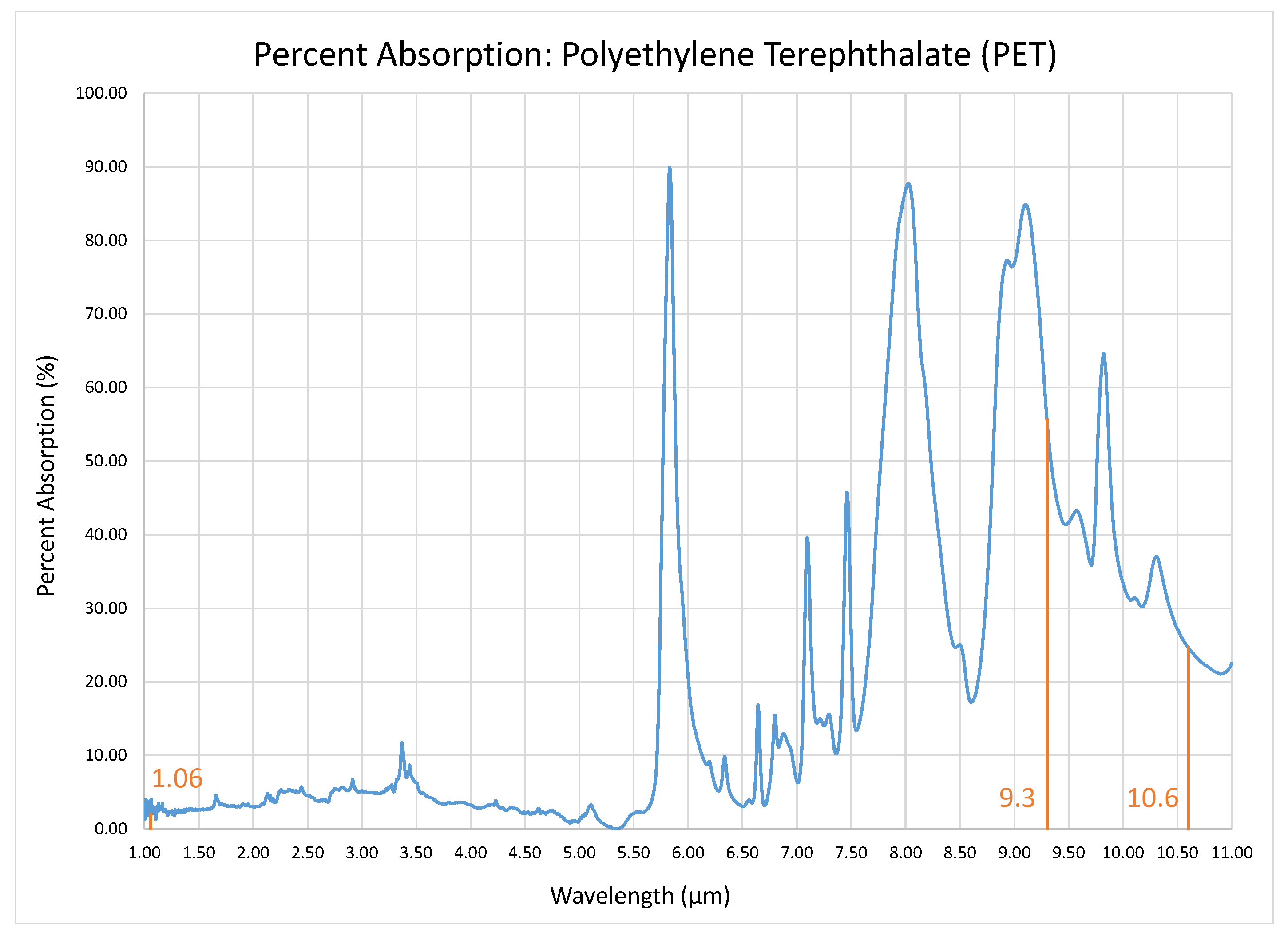

Investing in the right digital laser technology not only streamlines workflow, but also increases manufacturing flexibility. Advanced laser systems are able to process a wide range of materials by allowing users to select the ideal combination of power and wavelength for each application. The best choice or combination of CO2 or fiber laser source, power and wavelength(s) will of course vary depending on the material being processed, due to each material's optical wavelength absorption characteristics. In the example of PET below, a laser wavelength of 9.3 µm (CO2) is more easily absorbed than 10.6 (CO2) or 1.06 µm (fiber).
PET optical absorbance of laser energy is higher using a 9.3 µm wavelength over 10.6 and 1.06 µm.
