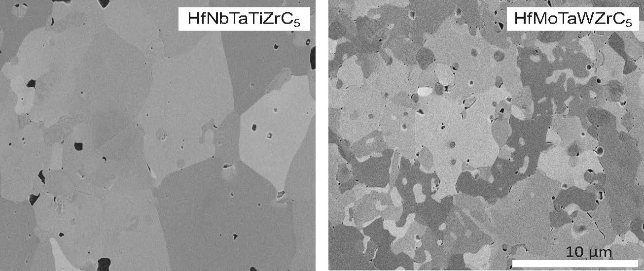

A microscopic look at the structures formed in two of the potential new carbides. The material on the right forms large blocks of similar structures making it unstable, while the material on the right forms a broad range of structures, giving it stability. Credit: Kenneth Vecchio, UC San Diego

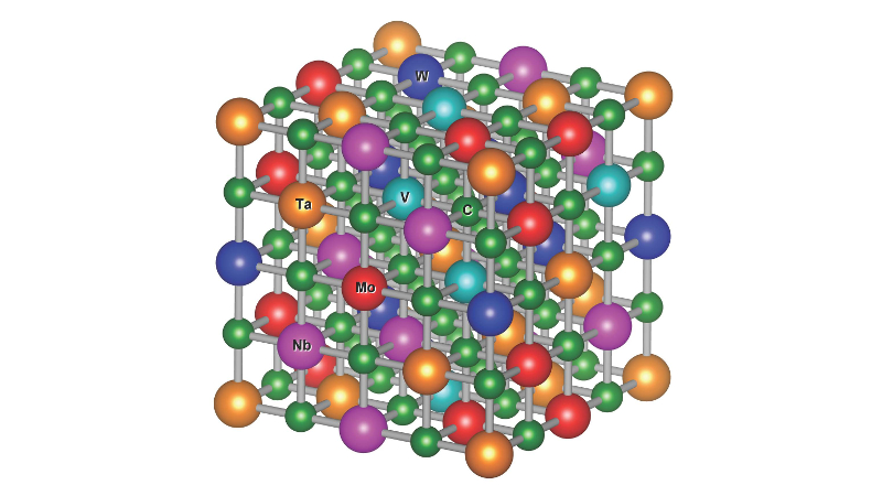

When students learn about molecular structures, they're shown crystals like salt, which resembles a 3-D checkerboard. These materials gain their stability and strength through regular, ordered atomic bonds where the atoms fit together like pieces of a jigsaw puzzle.
A computer model of the atomic structure of one of the new carbides. The jumbled mess of carbon and five metal elements gives stability to the overall structure. Credit: Pranab Sarker, Duke University

The new class of five-metal carbides takes this idea to the next level. Jettisoning any reliance on crystalline structures and bonds for their stability, these materials rely completely on disorder. While a pile of baseballs won't stand on its own, a pile of baseballs, shoes, bats, hats and gloves just might.

The team first narrowed the field of ingredients to eight metals known to create carbide compounds with high hardness and melting temperatures. They then calculated how much energy it would take for a potential five-metal carbide to form a large set of random configurations.
If the results were spread far apart, it indicated that the combination would likely favor a single configuration and fall apart--like having too many baseballs in the mix. But if there were many configurations tightly clumped together, it indicated the material would likely form many different structures all at once, providing the disorder needed for structural stability.
