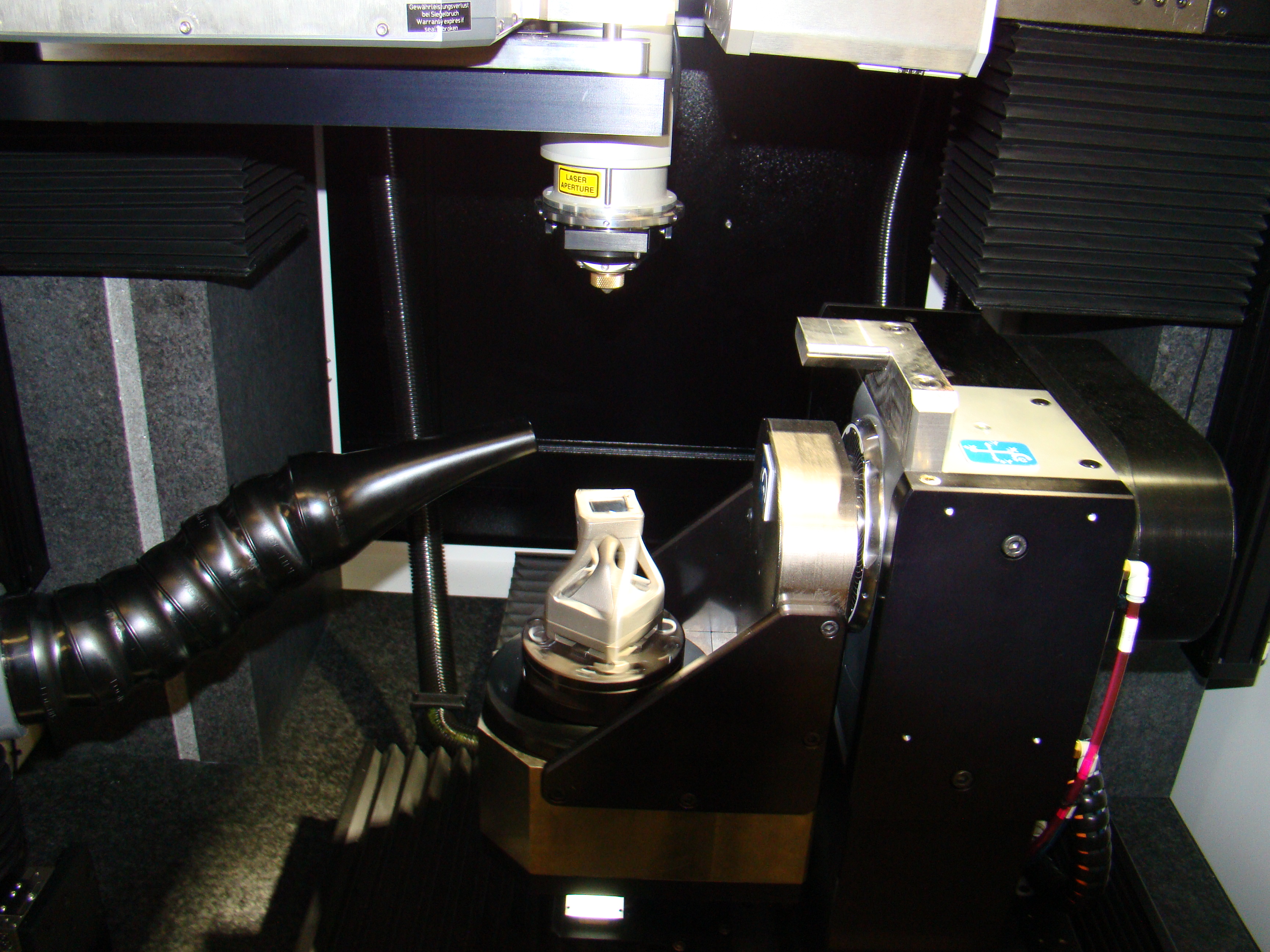

Microlution has four main product lines. The ML-5 is a 3- or 5-axis micromachining platform that's optimized for producing small parts, according to the company. The ML-10 is a larger 5-axis laser machine that is suitable for producing small features on big aerospace parts. The MLDS dual-station/dual-part machining center uses a femtosecond laser, and the auto industry is one of its targeted markets. The MLTC targets the medical industry and uses an ultrafast laser and offers microscale tube-cutting capabilities. Microlution introduced the MLTC and ML-10 at the event.
The Microlution ML-10 laser micromachining platform can process parts up to 1' tall and has a repeatability of +/-0.5µm.
