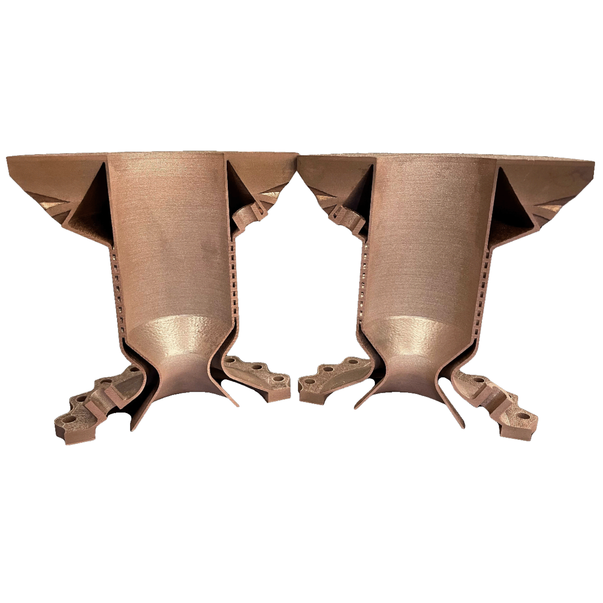

But it wasn’t until LPBF became available—and with enough laser power to work with copper— that copper powder found its ideal match in advanced AM technology. Carried out in an airtight build chamber, LPBF is the manufacturing process that can deliver the extremely complex internal geometries being developed for the latest rocket combustion-chamber designs, or for cold-plate applications in electronics.
These AM-enabled complex geometries are of particular interest to engineers designing lighter-weight rockets with novel propulsion configurations for launch vehicles, hypersonics, and other applications. A rocket’s thrust chamber needs to have material properties that can withstand the thermal and pressure extremes of ignition. But because it is essentially functioning as a heat exchanger, the chamber must also withstand a surrounding flow of super-chilled rocket propellant. Such a fluctuating environment can be balanced with extreme precision by 3D printing intricate cooling channels in the surrounding walls of the thruster—with geometries that cannot be achieved via any other type of manufacturing. The best material for this kind of system? Copper, of course, lining the combustion chamber.
