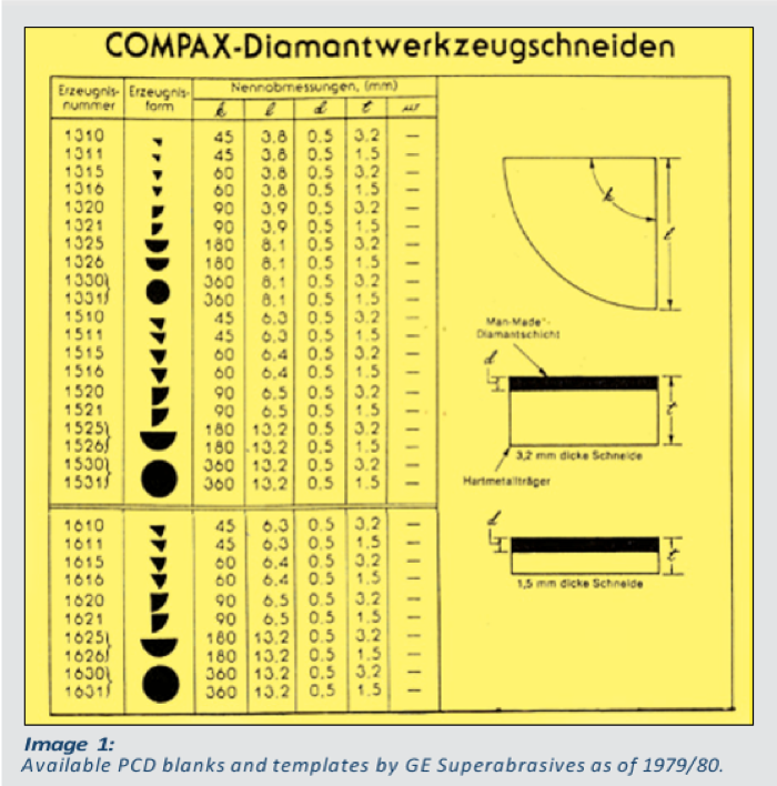

At the time of LIGNA 1979, the international trade show for machines and equipment for the wood industry, polycrystalline diamonds had only been available to the tool industry for six years – and polycrystalline boron nitride cutting edges only for five years – both from the manufacturer General Electric Superabrasives. The diameter of a PCD blank was 13.2 mm maximum (see image 1).

Employees of GE Superabrasives who visited the stand were able to gladly report back to the U.S. that now more PCD than before could be sold. This was also thanks to the discovery of spark erosion which initially made the commercial production of polycrystalline milling tools possible. Now they could focus on the production of higher quantities - and where appropriate even invest in larger diamond presses. To date, we had to use PCD blanks with 13.2 mm diameter and stack them according to the width of the milling machine.
In any case, for GE these news must have been pointing the way into the future. Consequently, the blanks supplied became larger in diameter – e. g. from 13.4 mm and 30 to 52 mm up to 58 mm today.

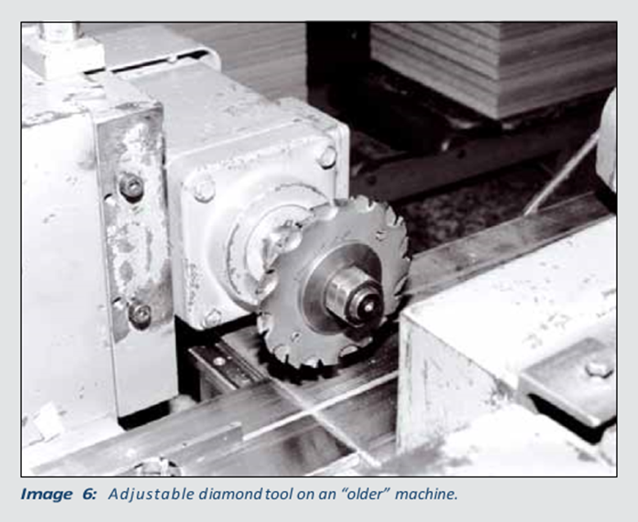

In retrospect, it was not easy at times to face the arguments of competitors. Lach quickly realized these long-lasting diamond tools needed a stable, compact seating and securely soldered the PCD to the steel base. This was an opportunity to warn potential users of dangers to life and limb – also for the machine – due to detaching, chipping diamonds.
This might also have been the reason that all shown diamond tools on double end tenoners in the Lach-Spezial videos (www.vimeo.com/206233393 and www.vimeo.com/206231829) were all mounted on older machines (see image 6).

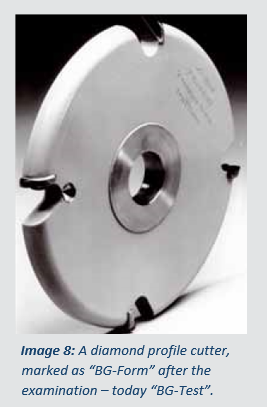

To guard against such argument, which would impede the market introduction, Lach-Spezial had a profile milling machine 180 x 15 x 30, R = 6.5, polycrystalline diamond as cutting material, Z = 2 + 2 (soldered) examined by the testing center of the occupational association for wood machining tools. The test certificate BG-Form #81016 is still available today. This also applies to the examination according to BG Test (ZU-8701) (see images 7 and 8).

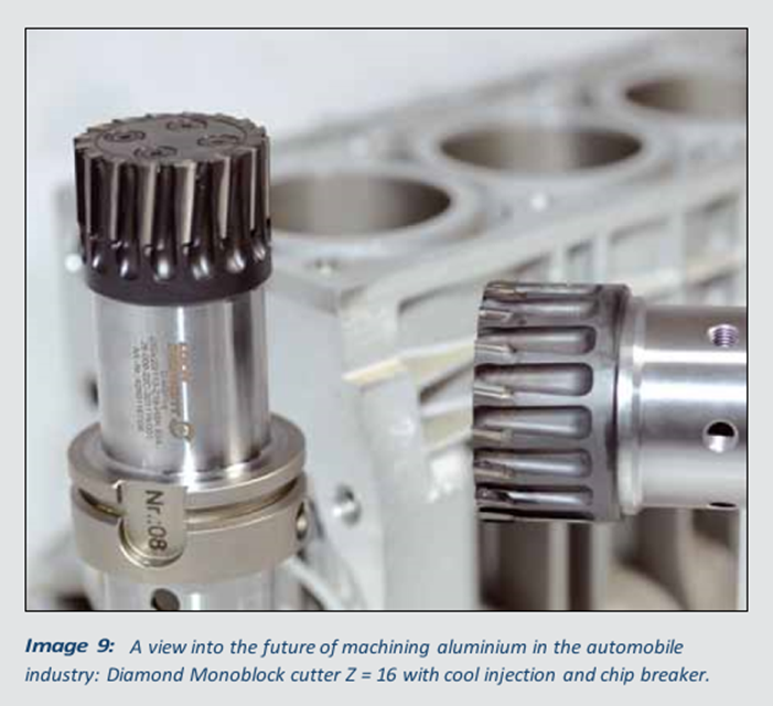

The demonstrated use of PCD as a superior cutting edge material for wood and plastic machining was only the mere beginning of their future potential (see image 9).
These results soon lead to the implementation of polycrystalline diamonds in the automobile and aviation industry, and even the later adoption in the wind energy industry – just to hint at a few future topics. You might also be curious how diamond tools changed the furniture, parquet and composite industries, especially in Europe and U.S. up to this date – even the milling of conventional grinding wheels will become a topic among possibly many other topics.
