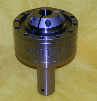

Northfield Precision Instrument Corp. introduces their special 5 inch diameter diaphragm chuck with morse taper number three female bore for locators.
March 13, 2013
Northfield Precision Instrument Corp. introduces their special 5 inch diameter diaphragm chuck with morse taper number three female bore for locators. The chuck has a built-in pneumatic hammer to expel morse taper locators. The diaphragm centers the work piece and pulls it onto the MT-3 stops.
The MT-3 type stops (not shown) are hardened and ground to 60-63 RC and ground between centers to guarantee concentricity.
