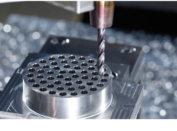

Last year, the Hoffmann Group introduced the new three-flute Garant MasterSteel Feed solid-carbide drill for the first time. The drill produces a 50 percent higher feed rate per revolution, even in long-chipping steels and stainless steel materials, and it also offers extraordinary durability. To achieve this, the shape of the point geometry, the capacity for precise chip breakage and chip evacuation have been optimised in particular. The design of the point geometry is crucial when it comes to evacuating the chips away from the working zone quickly and reliably. The Hoffmann Group has achieved this goal with a new, patent-pending point geometry. As a result, the chips are sufficiently compressed in the area of the point geometry and are even broken when processing ductile materials.
To evacuate the chips discharged by the three cutting edges as part of a reliable process, particularly large chip flutes are required. The Garant MasterSteel Feed drill has therefore undergone core tapering. This enables larger chip flutes towards the end of the twist section, combined with sufficient stability of the core. The importance of the twist section design was also demonstrated by the structure of the longer 8xD and 12xD drills. The development of these tools took a particularly long time. As part of this, the spiral angle had to be optimised multiple times and was modified until the necessary process reliability was achieved. The new three-flute drills with the world's largest L/D ratio therefore came onto the market a year after the market launch of the first Garant MasterSteel Feed solid-carbide drill. The chip evacuation is now so efficient that it functions as part of a reliable process in various materials. It was possible to demonstrate this in internal tests with materials such as St37, C45, 42CrMo4, X155CrVMo12.1, X5CrNi18-10.
To increase tool life, the Hoffmann Group has also transferred the convex cutting edge design from the classic two-flute drills, known as the "S-cutting edge", to a three-flute tool for the first time. With a convex cutting edge, the cutting force acts towards the tool in the area of the cutting edge corner – this stabilises the cutting edge corners. With a concave cutting edge design, the opposite is the case, and the cutting edge corners are therefore more susceptible to breakage. This was demonstrated by practical tests using the new Garant MasterSteel Feed solid-carbide drill and conventional three-flute drills, including tests with alloyed heat treatable steel 42CrMo4. In the test, drills with a diameter of 8.50 mm and an overall length 6xD competed against each other. They were clamped in hydraulic chucks and drilled at a feed rate of 0.44 mm/rev and a cutting speed of 140 m/min. The result: Tool breakage during spot drilling and tool life travels that were too short for the conventional three-flute drills; longer tool life travels for the drills with an adapted point geometry and concave cutting edge shape; 2,702 holes and a tool life travel of 102 m with the new drill concept. The new drill was therefore the clear winner in this test.
