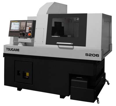

REM Sales LLC, the exclusive North American importer of high-precision Tsugami machine tools, announced that select 20mm models will now be equipped with a new higher torque main spindle.
The new 10,000 rpm higher torque spindles will boost metal removal and productivity without sacrificing the renowned Tsugami precision. Affected models include the B0203/204/205, S205/S206, BH20, BE20-V, SS20, and the S207. Previous to this announcement those models were equipped with a 12,000 rpm main spindle.
Tests have shown the new higher torque spindles provide three times the metal removal capability of previous models in certain applications. Turning cutting area has been increased from 0.15mm2 to 0.50mm2. Drilling and tapping power has also been boosted. Tapping capability has been increased from M8 in Swiss configurations and M6 in chucker configurations to M10 in both.
