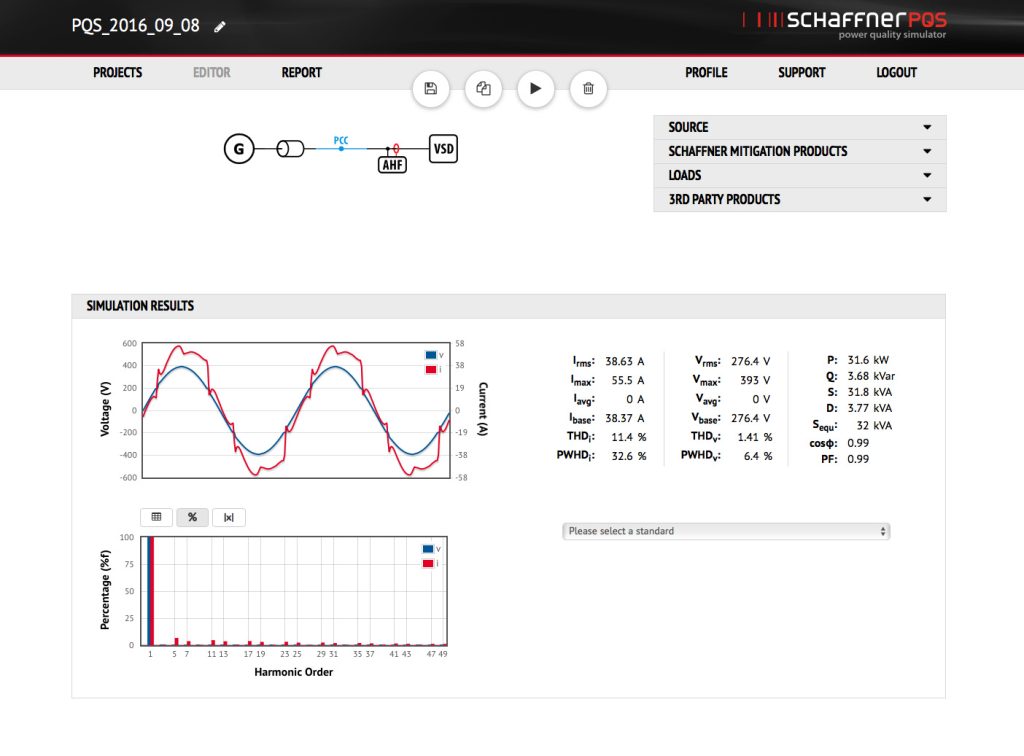

Schaffner EMC presents PQS3, an update to their acclaimed Power Quality Simulation tool that allows planners, consultants and application engineers to accurately model and simulate low-voltage, 3-phase network topologies. With this online tool, users can simulate complex power networks and receive rapid answers to challenging power quality issues. Drag and drop convenience, drop-down menu-driven functionality and fill-in-the-blanks simplicity make this program easy to use.
New upgrades include more robust active filter simulation, engine power and accuracy enhancements, refreshed GUI design featuring wiring by left-click and delete by delete button functionality, enhanced sharing functionality – simply copy the URL link, generator model included, customer-specific AC line chokes functionality now available, and Schaffner 18-pulse autotransformer "Mitigator" included.
PQS3 simulates power, current and voltage at all network modes, and supports the proper selection of harmonic mitigation technologies. It then verifies compliance with virtually all relevant international power quality standards, including IEEE 519 (2014), and it provides easy to understand reporting features. It is for application engineers, planners, consultants, plant managers and others responsible for the power quality within all industries.
This enhanced tool allows users to select medium and low-voltage transformer parameters (voltage, power, short circuit current, and impedance), specify cable (length, diameter, and material), and then add loads and harmonic filters. With drag and drop convenience, users can select common loads such as furnaces, motors, resistive loads, DC motors/battery chargers, and variable-frequency drives. When these elements are added to the circuit, PQS prompts the user to fill in applicable parameters for each component.
If the system design will not support the load, for example, a message will be generated suggesting that a larger transformer may be required and then stay illuminated until the power supply issue is rectified. PQS supports all Schaffner harmonic mitigation technologies, including active and passive harmonic filtering, and chokes, as well as power factor correction.
