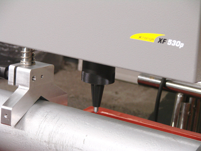

Technifor meets the identification and traceability demands of the heavy equipment manufacturer with the powerful XF530 micro-percussion machine. The XF530 is one of Technifor's versatile, portable direct part marking systems. This system marks all types of metal components anywhere, at any time.
A tough and very reliable system, it offers a large marking area (7.87" x 1.96"/ 200x50mm), with large character marks penetrating as deep as .016"/.4mm. This capability makes the XF530 ideally suited for marking before/after painting and before part treatment.
The adjustable, V-shaped universal feet stabilize the XF530 (40lbs/18k) for marking on any flat and curved surface. The included balancer, when coupled with the ergonomic handles (with built-in start buttons) makes marking in a vertical position as easy as marking horizontally. The controller, with its graphical interface offers fast creation of marking files thanks to the integrated, intuitive and user-friendly software.
Operating with or without a computer, marking data can be entered via keyboard, USB, bar code reader or via Ethernet connection. A universal power supply means the XF530 will operate in any country.
