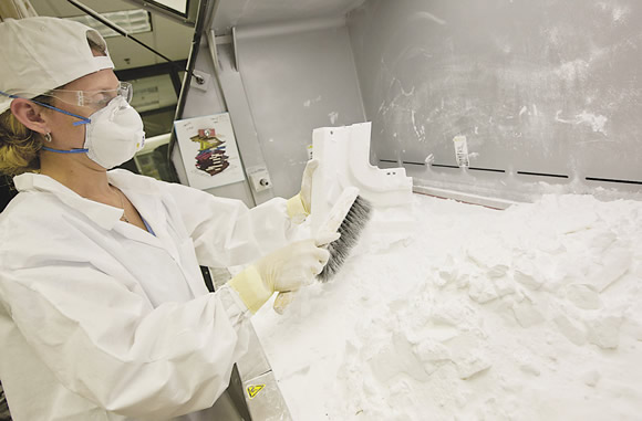

GM%20RP%20Lab%20Pic%202.tif
Courtesy of General Motors
GM Global Design’s rapid prototyping laboratory team reclaims and repurposes the powder material used in selective laser sintering, an AM process.

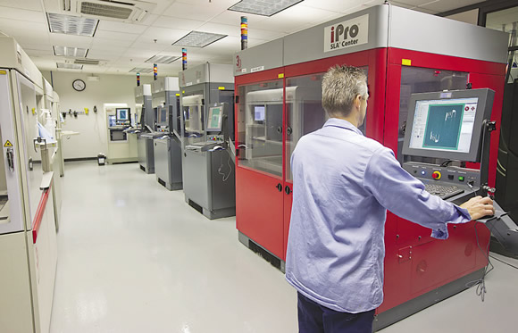

GM%20RP%20Lab%20Pic%201.tif
The Rapid Prototype Laboratory at the GM Global Design Center operates on a 24/7 schedule for a continuous flow of receiving, scheduling, manufacturing and express shipping of more than 25,000 rapid prototyping components a year using stereo lithography apparatus and selective laser sintering.

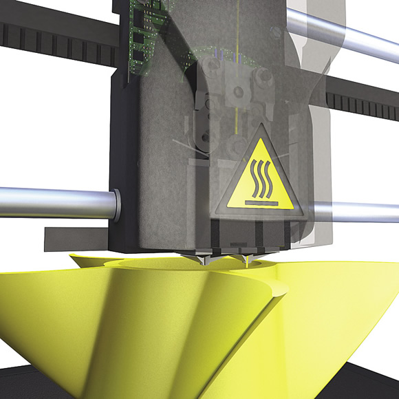

printerHead-detail-part-buildT1-yellow1.tif
Courtesy of Stratasys
A 3-D printer building a part layer by layer. The printer head is visible below the triangle-shaped logo.

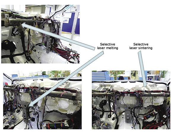

Beispiele%20AM%20Modelle%20UT%20.tif
Courtesy of Daimler
Parts in an assembly that Daimler produced using selective laser melting and selective laser sintering.

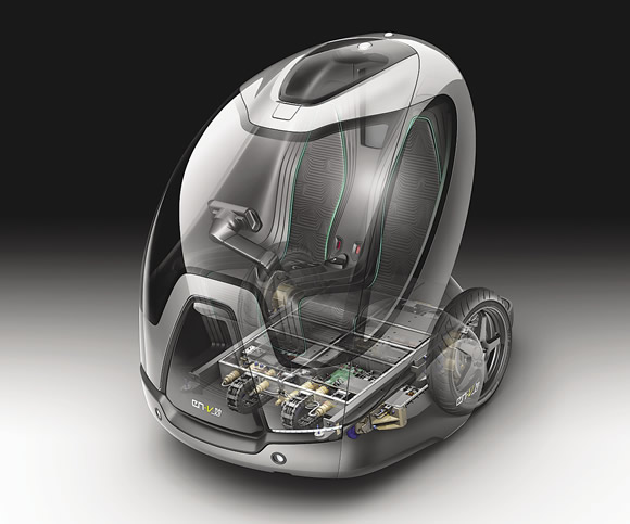

GM%20EN-V%20cutaway.tif
The GM Global Design Center’s rapid prototyping capabilities fast-tracked the EN-V (Electric Networked-Vehicle) concept program, which includes this Miao model.

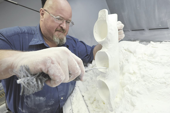

SKV_0906.tif
Courtesy of Sam VarnHagen/Ford Motor
Ford Technologist Mark Smith cleans a 3-D printed part at Ford’s 3-D printing facility. The technology allows engineers to quickly create a series of testable pieces with slight variations, a process that helps Ford develop the most fuel-efficient vehicles for mass production.

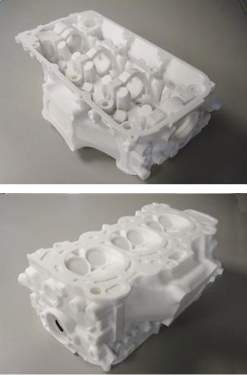

Stratasys1.tif
This polycarbonate cylinder head model is for CNC training and was produced on a Stratasys Fortus 400mc machine.

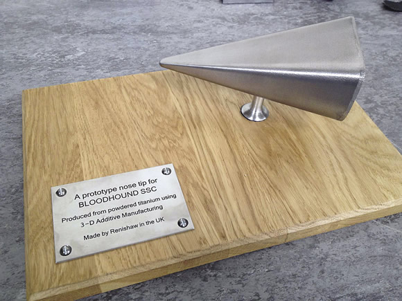

The nose tip is subject to forces as high as 4,915 lbs./ft.2. To cope with such loads, the team designed and built a Ti6Al4V prototype tip. It will be bonded to the car’s carbon fiber monocoque body, which forms the front half of the car.
The team produced the nose tip with a Renishaw AM250 laser melting machine, which fuses 50µm-thick (0.002 “) layers of fine, gas-atomized metallic powders to form complex parts. The equipment can also build with 25µm layers. The team will use the prototype to evaluate possible manufacturing processes and conduct further engineering analysis.
Bloodhoud%202_.tif
Courtesy of Renishaw
During his visit to the Bloodhound Technical Center, U.K. Minister for Universities and Science David Willetts received this commemorative plaque with a prototype nose tip, produced via additive manufacturing, for the Bloodhound SSC (inset).
Bloodhound%201.tif
“We believe that the key benefit of using an additive manufacturing process to produce the nose tip is the ability to create a hollow, but highly rigid titanium structure, and to vary the wall thickness of the tip to minimize weight,” said Dan Johns, lead engineer at Bloodhound SSC. He is responsible for materials, processes and technologies. “To machine this component conventionally would be extremely challenging, result in design compromises and waste as much as 95 percent of the expensive raw material as swarf.”
According to Renishaw, wall thickness averages 3mm (0.12 “), with the freedom to create geometric features to aid the bonding process. If the part were to be machined from a solid piece of titanium—which would require milling instead of turning because it does not have a circular cross section—the freedom to create bonding features would be limited. In addition, workholding is challenging because of the part geometry.
