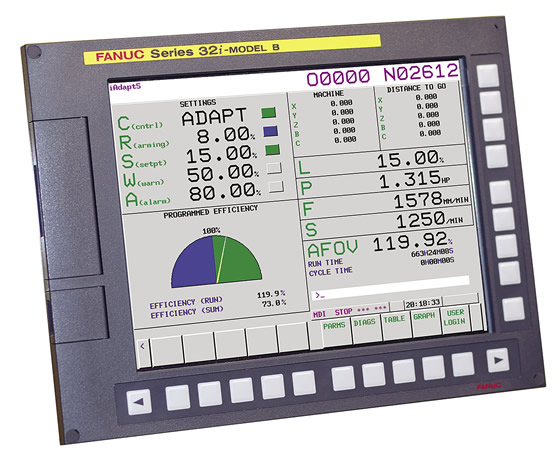

One company offering a standard AC package is FANUC America Corp., Hoffman Estates, Ill. As Engineering Manager Paul Webster explained, FANUC’s iAdaptS AC option for its controls decreases roughing times by sensing spindle loads and increasing programmed feed rates where possible. “The current draw at the spindle motor is directly proportional to the cutting load. By constantly monitoring that current, we can compare its value to a predetermined range, adjusting the feed rate up or down accordingly.”
According to the company, iAdaptS reduces cycle times up to 40 percent and compensates for variations in material hardness, tool wear and DOC. Once installed, the only requirement is teaching the AC what to expect. This is done one tool at a time, for a maxi- mum of 64 tools in the library. Webster said the learning process is no big deal. “You basically run the tool once in teach mode, then set realistic values on how much that tool is allowed to speed up or slow down from the programmed feed rate.”
Courtesy of Okuma America
Keeping an eye on chatter, Okuma’s Machining Navi option adjusts spindle speed to break harmonics during cutting, so machining is performed in a range that doesn’t cause chatter, as shown on this stability lobe diagram.
It’s not a cure-all, Webster pointed out, because the AC primarily protects the cutters and reduces cycle time during operations with heavier cutting loads, such as when roughing. So, for example, don’t expect to monitor the load from a 1⁄8 "-dia. cutter mounted in a 40-hp spindle.
Still, the iAdaptS is a no-brainer in terms of cost, with a list price of about $1,100. Better yet, it also works on older FANUC controls all the way back to the 16i and 18i series, Webster said.
Another advantage of iAdaptS is a feature called dithering. One issue with dynamically adjusting feed rates is that doing so can create a feedback loop, or resonance, leading to uncontrolled axis movement and broken tools. FANUC gets around this problem by slightly varying the set feed rate (dithering), which cancels the resonance. “If you’ve ever seen an operator tweaking the feed rate override to kill chatter, it’s similar to that,” he said.

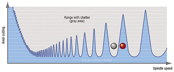

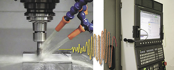

Chatter is another problem solved by adaptive control technology. Director of Technology Brian Sides of Okuma America Corp., Charlotte, N.C., noted the company’s “Machining Navi” option is one solution.
“There are two flavors to this,” he said. “During machining, Navi M-g uses a microphone to listen for chatter and recommends a range of spindle speeds to eliminate it. The Navi M-i option uses vibration sensors in the spindle and automatically optimizes the spindle rpm in real time.”
Sides said there is also a Machining Navi version for lathes, which uses G code to break harmonics that lead to chatter. When executed during setup, the control commands the spindle to rotate in alternating directions. This determines the inertial qualities of the part setup and, when activated during cutting, oscillates the spindle speed to break the harmonics that lead to chatter.
