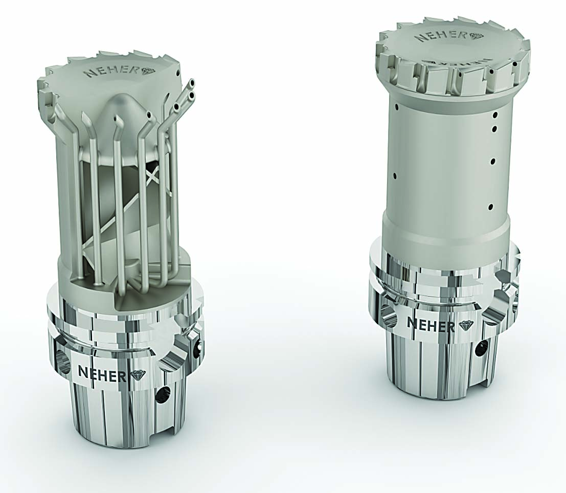

He said Neher purchased its first 3D printer in 2016 and began printing tools in 2020 on DMG Mori Lasertec 30 Dual selective laser melting machines. Nearly all of Neher’s 3D-printed tools are specials focused on large interpolating tools, such as reamers and milling cutters. Similar to Kennametal, one targeted application is machining stator housings for electric vehicles.
By 3D printing those tools for finishing large diameters, as well as other large cutters, Dunneback said Neher can reduce tool weight by up to 30%.
“It still maintains its torsional stiffness,” he said, “so the performance of the body is intact. Lightening up can be very important, especially in the aerospace business where they specify the actual max weight that a tool can be that they’re using in their process, and sometimes it is a struggle trying to get those weights.”
Dunneback said weight reduction primarily is achieved by creating a honeycomb internal lattice structure in tool bodies.
“The inner structure is where we lighten the product more than anything,” he said.
Dunneback said less tool weight means that less weight is exerted on the machine spindle, which helps with overall preventive maintenance for the spindle. In addition, when an end user has a machining center with an HSK 63 spindle interface, for example, and it should be an HSK 100 based on the weight of a conventionally manufactured tool, running a lighter 3D-printed tool can make the machine more capable.
“The worst case that we’re seeing is a tool getting dropped because of its weight,” he said, “falling out of the toolchanger because it slips from the spindle.”
In addition to being able to accurately place coolant channels of any size at any direction and anywhere they are needed in a tool body, Dunneback said additive manufacturing enables toolmakers to optimize those channels for minimal quantity lubrication applications. For both MQL and high-pressure coolant applications, consistently and correctly targeted coolant delivery can extend tool life.
“We’ve reported improvement in tool life up to 50% in some cases,” he said.
When a 3D-printed tool body becomes too worn, Dunneback said it can be reconditioned many times like any conventional body. Star Cutter reconditions tools at its facility in Farmington Hills.
“We will remove the diamond that was originally manufactured, install new diamond and finish the tool to the original condition,” he said.
