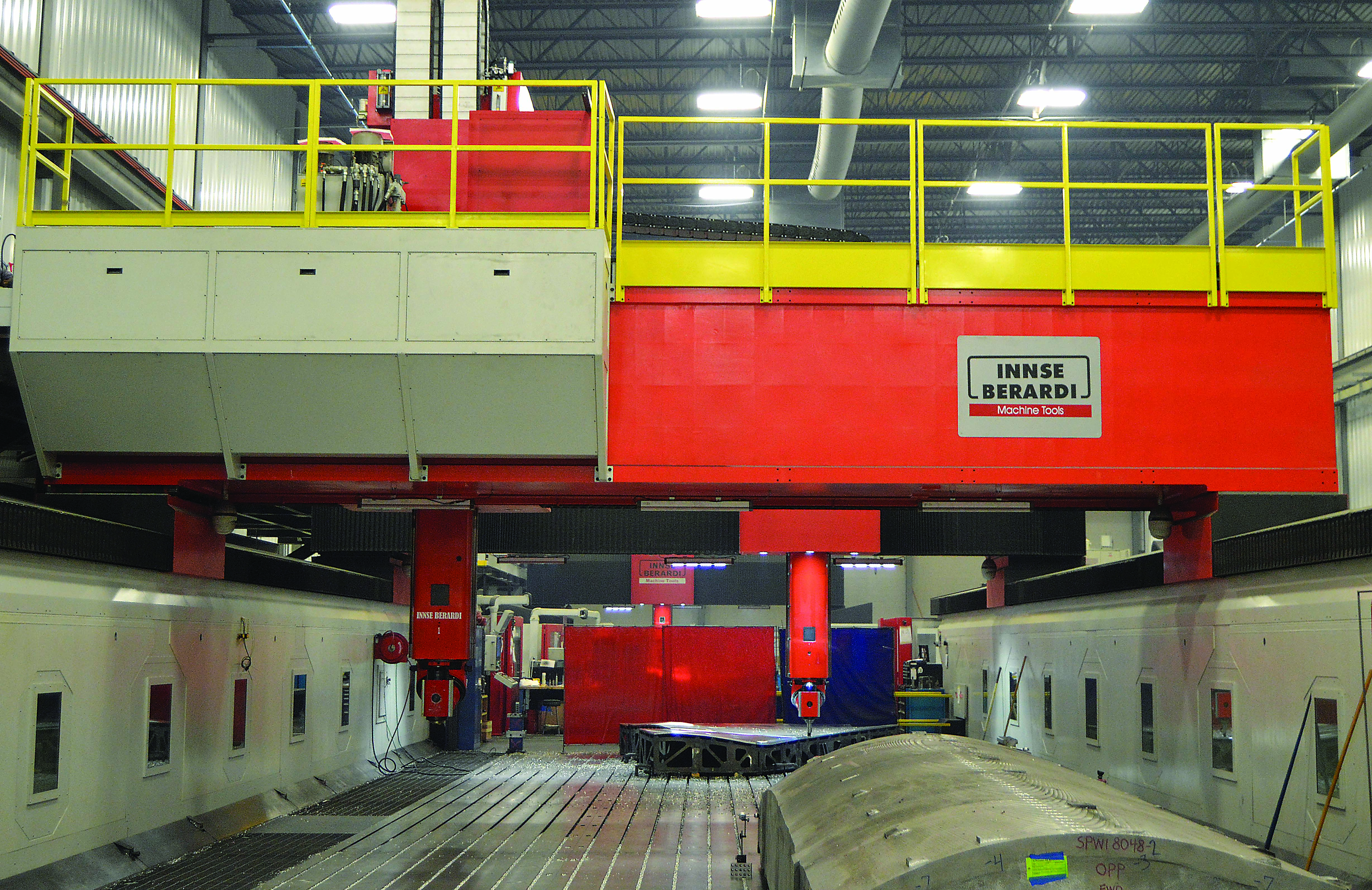

Equipment at the new facility includes two new large-table Innse Berardi contour milling machines. The larger of the two machines is a dual-gantry, 5-axis system with a machining envelope of 975"×273"×117" (24.8m × 6.9m × 3.0m). The other machine features a single gantry and a 390"×234"×117" (9.9m × 5.9m × 3.0m) work envelope. Both are accurate to ±0.002" (0.051mm).

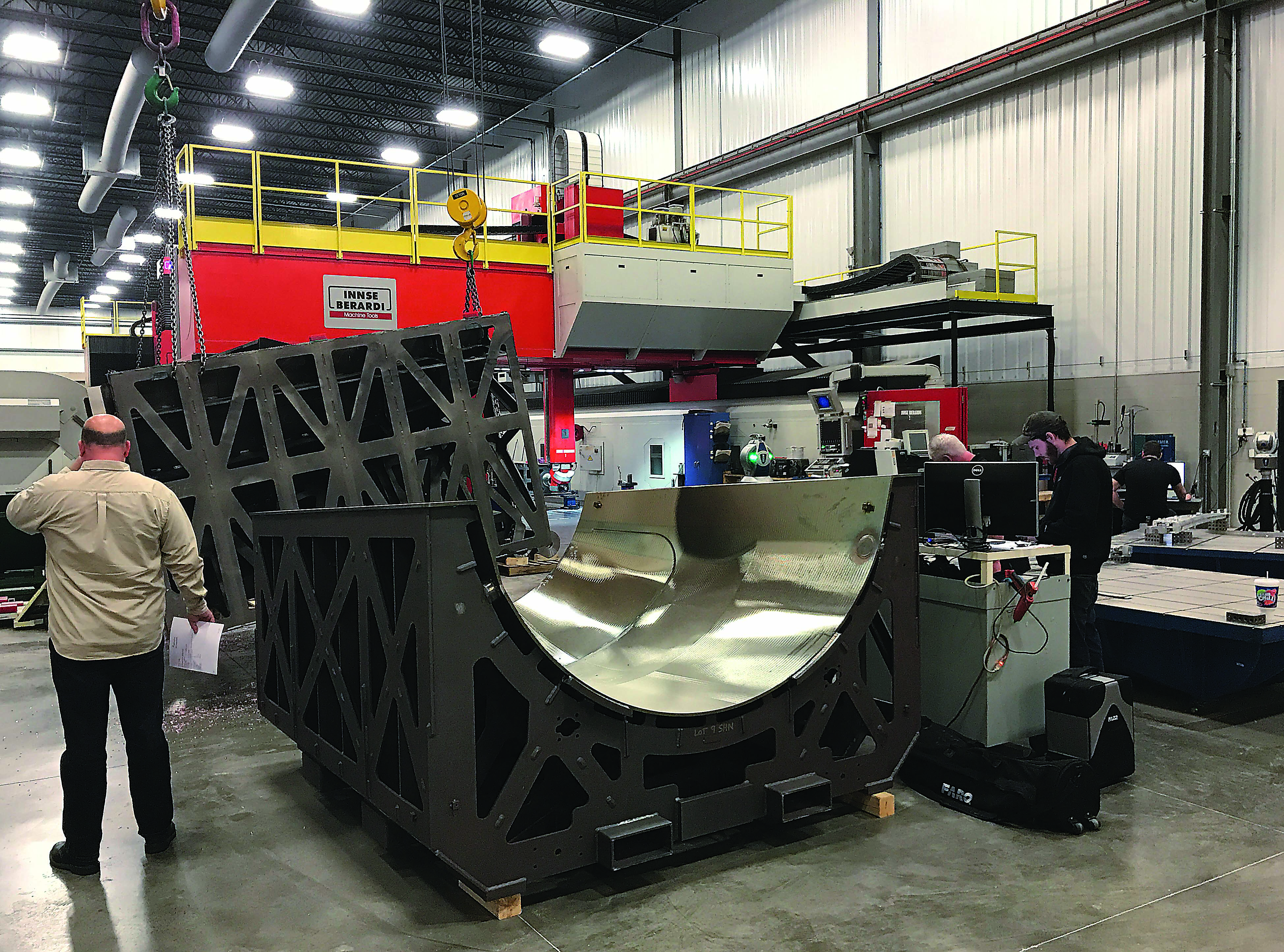

Last year, the company put the dual-gantry machine to the test by manufacturing three Boeing 777X vent stringer lay-up molds—two 108' (32.9m) tools and one 88' (26.8m) tool. “The tooling requirements were so large that the stringers had to be constructed out of multiple Invar pieces and welded together prior to finish-machining the tool surface,” Elmes said.
The machine operators used the dual-gantry spindles simultaneously during the final machining phase of producing the stringer tooling. “By using the dual-gantry machine, we were able to machine each half of the tool at the same time,” cutting machining time in half on a date-critical program, Elmes said.
This Innse Berardi contour milling machine has a machining envelope of 975"×273"×117".

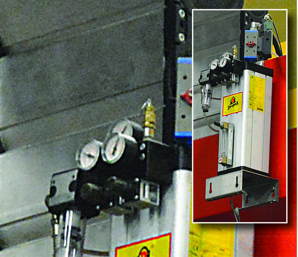

The DropsA MQL system on a Innse Berardi milling machine.

Schienke wanted to try a system without injectors or moving parts. As an experiment, he worked with lubrication-system company DropsA USA, Sterling Heights, Mich., to equip a couple of machines with a minimum-quantity-lubrication, or air-oil, system, which operators could try while retaining the option of applying coolant.

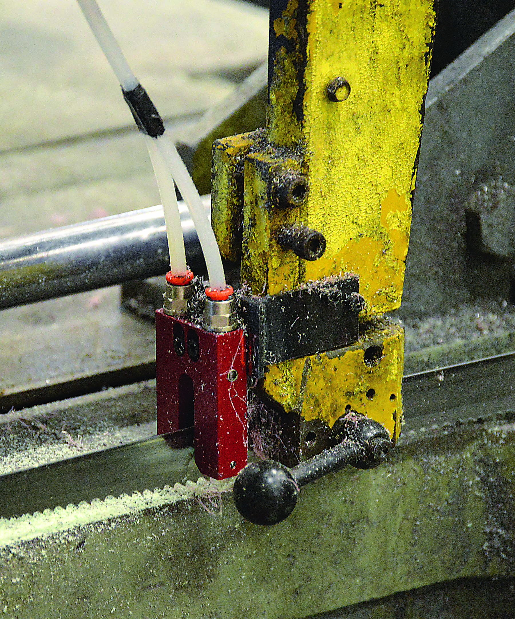

The challenge in developing MQL was in getting it to be easily adapted to all kinds of cutting equipment, said DropsA’s Jason Craft. Here, an external MQL system has been added to a bandsaw at Visioneering.

MQL systems have much more finesse, he said, whether they are an external or through-spindle system. DropsA’s MQL system transforms the lubricating oil into an aerosol made up of droplets no larger than 0.5µm in diameter.
“If the droplets aren’t that small, they get pushed together and you get big drops” that will create a mess, Craft said. But when that 0.5µm size is maintained, the result is an easily directed, minimal spray entirely consumed by the lubricating process, and the air stays clear.
In a through-tool MQL system, the aerosol spray goes right into the cut and no farther before it burns away, he said. In the external system, “the oil is a solid in the tube, and the air is there to push it down at a constant velocity.” In each system, “your unit is metering the amount of oil, and it’s a very small amount.”
