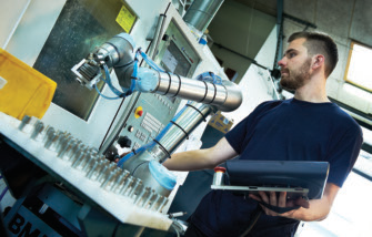

A robot from Universal Robots loads steel workpieces into a CNC lathe at Nymann Teknik, a machine shop in Hobro, Denmark. Below: A UR robotic arm comes with a controller and touch panel.

Visti explained that users can graphically program the robot using a touch-sensitive screen with a graphic user interface or with a teach function. Programming the latter way involves manually moving the arm to show the robot the movements it needs to make, which the robot then remembers.
According to the company, a significant benefit is the robot’s ability to operate without safety shielding as long as the end-of-arm tooling isn’t carrying something that can injure a worker, such as a knife. As soon as a worker comes into contact with the robot arm and a force of at least 150 newtons is exerted, the arm automatically stops operating. The 150-newton force is also the arm’s maximum gripping force.
