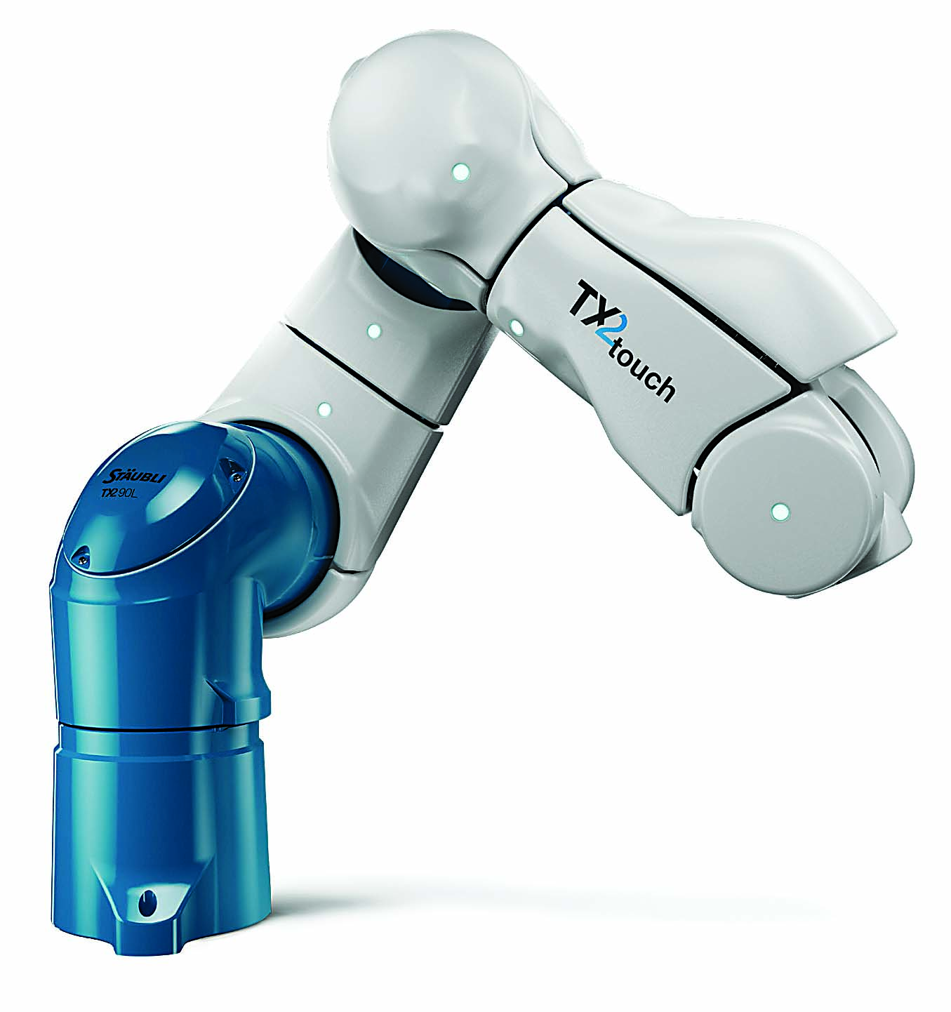

![Stäubli reports that its TX2touch-90L cobot offers safe operation thanks to its advanced skin technology, quick reaction times and embedded modular safety functions.](/sites/default/files/inline-images/TX2touch-90L.jpg)

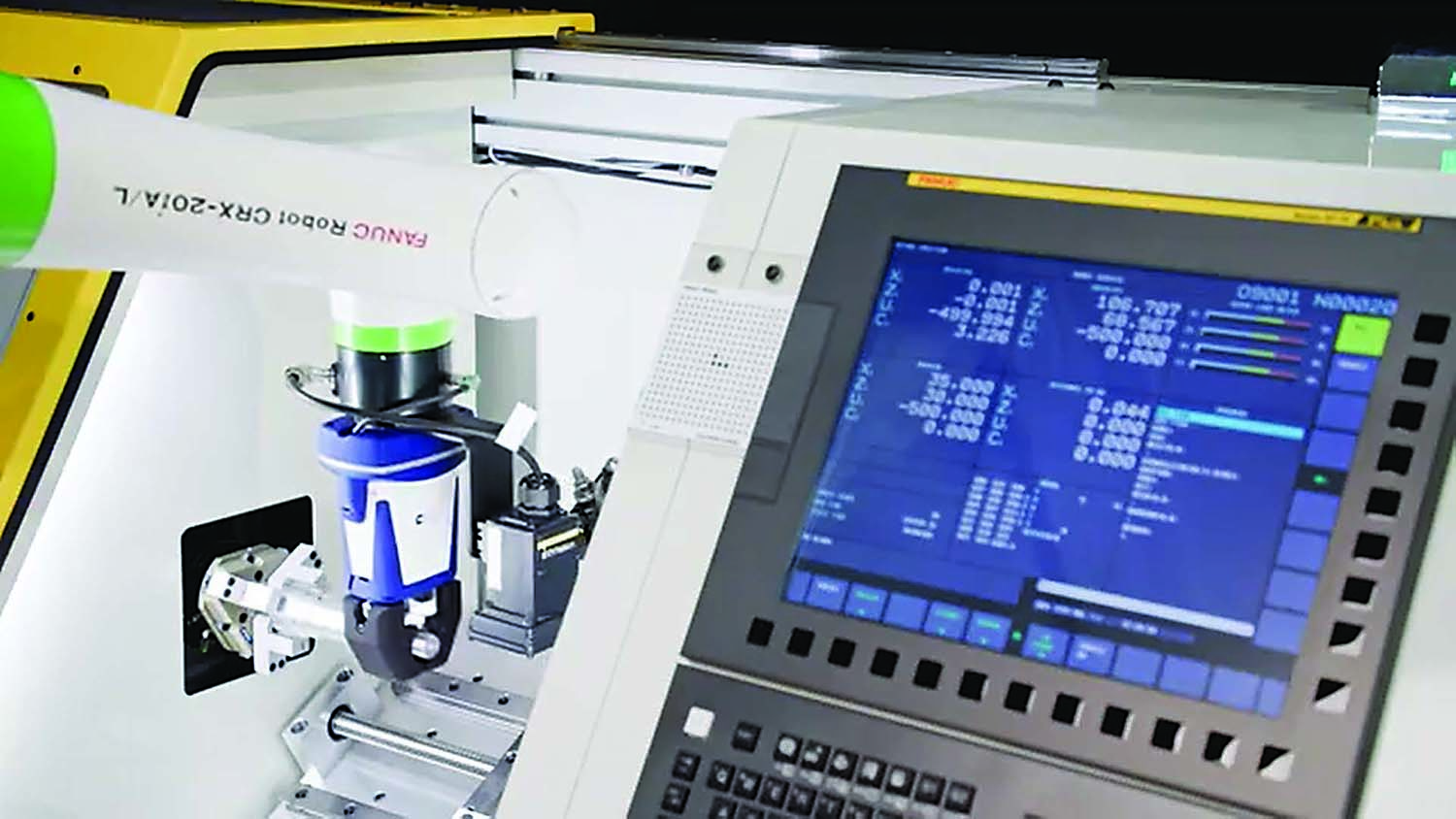

![Fanuc America A CRX cobot is connected to a machine with Fanuc controls, and software simplifies robot integration and startup.](/sites/default/files/inline-images/QSSROnsite2.jpg)

End users are looking for more ease in programming, agreed Gilles Le Quilleuc, head of general industry for North America at Stäubli Corp. in Duncan, South Carolina. It’s important to get a cobot up and running quickly and achieve a fast ROI because job shops don’t typically have an engineering team and it’s becoming more difficult to find and hire application engineers.
Stäubli offers a host of robotic equipment, including industrial robots, mobile robots, automated guided vehicle platforms and cobots. According to the company, its TX2touch Power cobots offer safe operation around workers thanks to advanced skin technology, quick reaction times and embedded modular safety functions.
Le Quilleuc added that ease of programming enables end users to quickly reprogram cobot positions for machine tending.
“The capacity to plug or connect this robot to one machine and the day after to be connected to another one —this is clearly what end users are looking for,” he said.
In addition, Le Quilleuc said they understand that a cobot is a flexible, stable automation solution based on four reasons: the need for speed, worker safety, maintaining part quality and an increased capacity to produce on the same type of machine.
“In the end, the cobot is not so complex,” he said. “Today, any kid 8 to 10 years old can program the robot.”

Tuohy noted that a Fanuc robot is connected to a machine with Fanuc controls and software, which simplifies robot integration and startup. This allows an end user to use one Ethernet cable connection and some software in the background on the robot and on the CNC to potentially decrease the time to integrate from days to hours.
“The ROI is greatly improved when you have a Fanuc-controlled machine and a Fanuc robot working in tandem,” he said.
