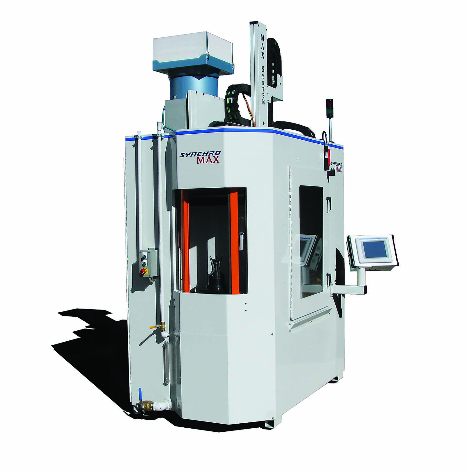

James Engineering in Broomfield, Colorado, builds an automated alternative with its 11-axis Max System CNC deburring and chamfering machine that includes proprietary compliant technology to speed and simplify programming, setup and operation. Compliant technology enables deburring and chamfering tools to maintain a constant force on a part as they follow its features.
Gearing Up
James Richards started the company in the early 1980s. At the time, he developed precision deburring and chamfering techniques to finish gears used in Formula One race cars. He went on to create hundreds of custom gear deburring and chamfering machines for advanced applications in automotive, aerospace and myriad other industries. His most recent development, the Max System, allows the process to be applied not only to gears and shaft components but to prismatic ones.
This machine consists of two five-axis heads and a c-axis rotary table. Servos position the heads via an x/y/z overhead gantry using hardened chrome, ground shafts and carriers with multiple pre-loaded bearings. Movements as fast as 1,500 ipm are possible. Plus, the overhead design means that swarf and abrasive material won’t work their way down into the carrier or onto the gantry shafts. In addition, the machine features nozzles that deliver water-based coolant with rust
inhibitor at 200 gpm not only to keep parts and tools cool during operations but to wash parts and the machine work zone. The two heads can concurrently perform finishing operations using various brushes and abrasive tools to minimize overall cycle times.
Richards also developed a compact 4,000 psi hydraulically driven motor for the heads, providing up to 25,000 rpm using only one moving part and no vanes. Twelve types of tools are available. These install into heads using one bolt.
The heart of this process is the compliant technology, which he likens to the front suspension of a car. Using pneumatics and a damping agent enables a tool to maintain a constant force on a part as the tool follows the contour of the features ahead of it to be finished. This means that no change to a programmed toolpath is required to adjust for a perishable tool, such as a brush that might start at 1.25" in diameter and be reduced to 0.75" over its life. (Another compliant technology analogy is the way that a record player needle follows the grooves in an album.) This also simplifies programming and setup.
Programming any deburring system is part manual teach-in and part conversational at the machine’s control. No 3D model of the part is needed. Because of the compliant technology, a tool, such as a brush, does not have to be positioned as precisely as, say, a cutting tool on a milling machine would. An operator would capture the brush’s initial x/y/z coordinates, jog it to the part and record that position — commonly the midpoint of the tool’s range of compliant travel. This is performed for all tools and operations. Values like feed rate and compliant force also are entered — these vary depending on burr size, chamfer accuracy and more — and fine-tuning of tool positions can be performed as well if necessary. Programming Richards’ Max System, for example, is made easier with the machine’s Mitsubishi control.
He said the best programmer at a machine shop is likely the person who has been hand deburring for many years and knows precisely what angle a tool needs to approach a part. The control can store as many as 100 part programs, and programs can be added and removed from a USB as well. James Engineering refers to these as recipes to distinguish them from the operating system running in the background. Individual operations can be chained together much like a word processor’s copy and paste function to further speed programming. Plus, the chosen operations enable what the company calls focused deburring so only the part features requiring such finishing operations are touched.

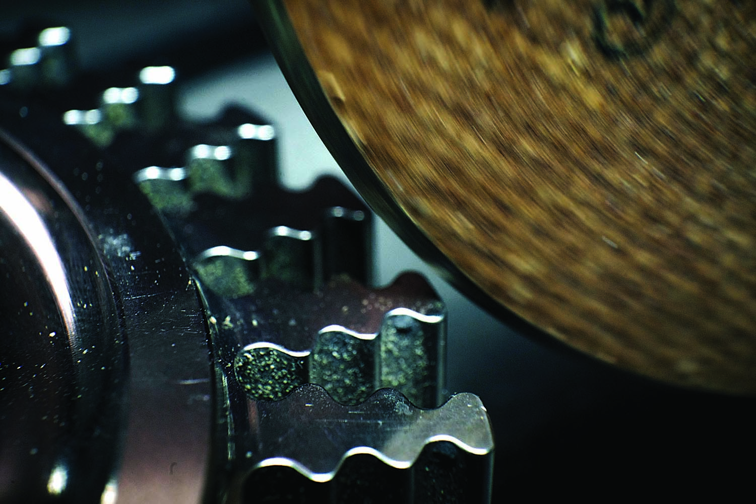

Why Not Chamfer Generation Machines?
These types of machines create bruising, swelling and mounding due to the impact of the rotating cutter against the gear surface. Bruising and swelling are common side effects of chamfer generation machines and will increase as the cutters wear out, and secondary burrs will increase as the cutters wear out. The most important takeaway here is that chamfer generation is a diminishing process: The cutter always is wearing out, part after part.
That’s why grinding wheels and brushes are used. These kinds of media renew constantly. With each revolution and each granule removed, a new, fresh cutting surface is revealed. This constant renewing means that the results are always the same, part after part.
