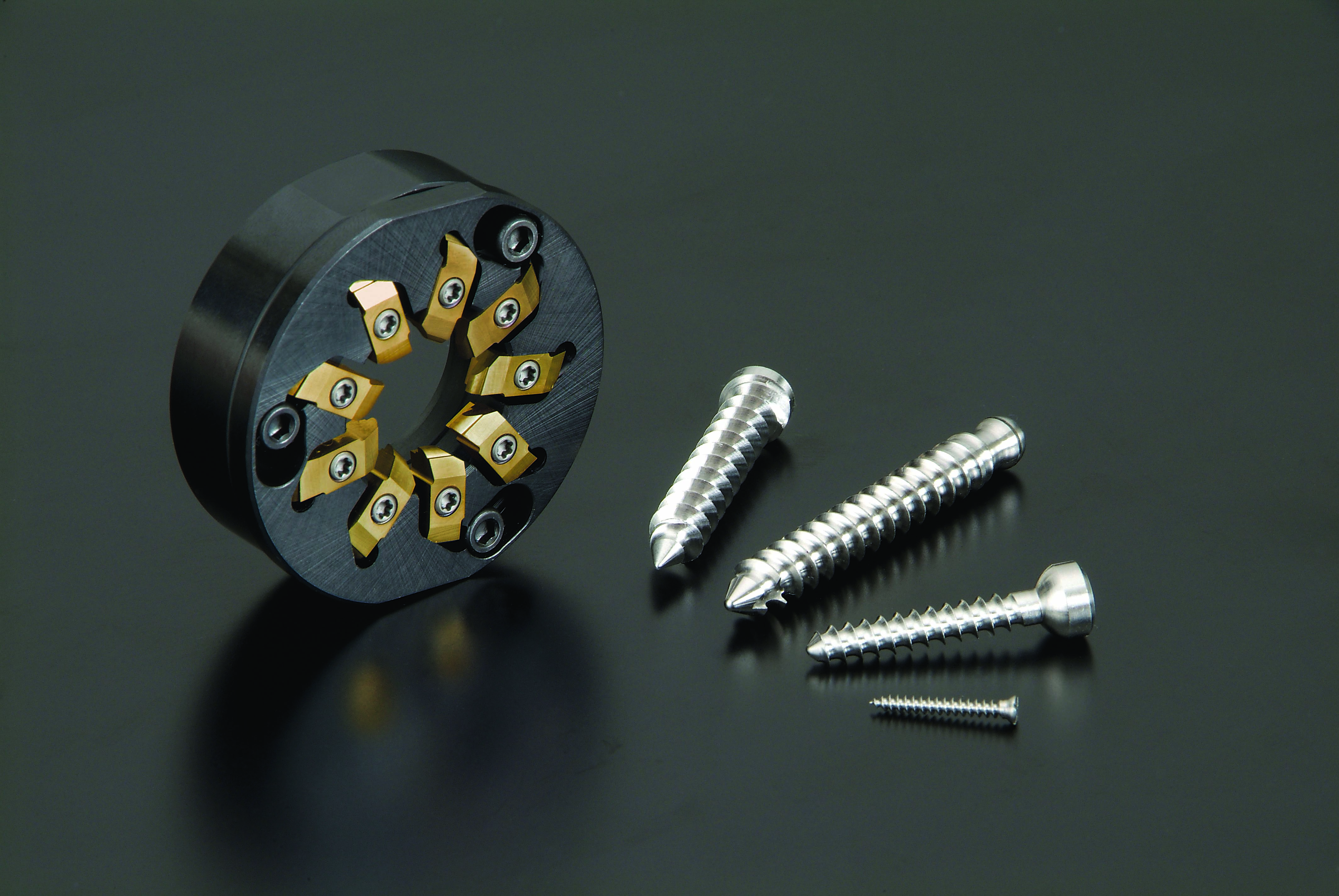

NTK Cutting Tools focuses on multilayer physical vapor deposition tool coatings for hard-to-cut materials. Although a thick titanium nitride coating might do the job for titanium thread whirling, Easterday said it wouldn’t suffice for cutting abrasive BioDur or nitinol.
For tools that will be used to machine these materials, “we might do a TiN coating and then layer it with a titanium aluminum nitride coating to give it more wear resistance,” he said.

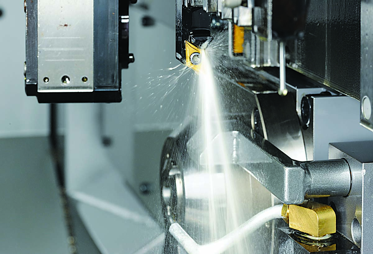

In medical and other applications, high-pressure coolant directed at the cutting edge helps evacuate chips and increase tool life. Image courtesy of NTK Cutting Tools
Another possibility is to use supercritical carbon dioxide for cooling and lubrication. A fluid state of CO2 held above its critical temperature and pressure, supercritical CO2 looks like a gas but is as dense as a liquid. When used as a coolant, supercritical CO2 leaves no residual contamination on medical parts, said MacArthur, whose company has partnered with firms that use supercritical CO2 to machine medical parts.

NTK Cutting Tools applies TiN coatings to thread whirling cutter systems. image coutesy of NTK Cutting Tools
