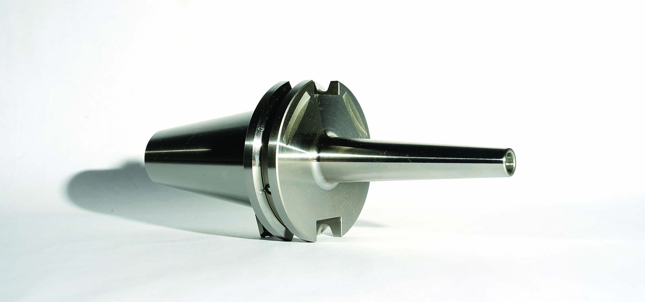

According to Hansen, a technology that fits the bill in both areas is shrink-fit tooling. Shrink-fit “is a very accurate way of holding an endmill in a toolholder and helps with running under high-speed imbalances,” he said. “We even sell shrink-fit collets that go into live tools. It’s a technology that can be used right across the spectrum of machining.”
When it comes to accuracy, Hansen said, shrink-fit toolholders can keep runout down at around ±0.0001" even at the highest spindle speeds machines are capable of today. A major reason for that, he noted, is that, unlike competitive systems, shrink-fit is a one-piece toolholding solution.
“We just quoted some tools to a customer who wanted a 16" long toolholder,” he said. “That's very long, but (with shrink-fit) we can make it all in one piece so it’s rigid and accurate.”
The long reach of shrink-fit tooling makes it a popular choice in the mold business, allowing manufacturers to get down into mold cavities to mill the required profiles. “The longer the reach, the more stress you get — and the easier it is to push tools off-center,” Hansen noted, adding that shrink-fit provides the firm grip necessary for accurate machining in those situations.
Another big advantage of shrink-fit is that it allows the use of very thin tools that can get into small spaces. Hansen reported that his firm produced a shrink-fit holder for a 1/8" diameter tool, with the holder itself measuring around 1/4" in diameter.
On the downside, Hansen pointed out that the creation of shrink-fit toolholders requires machines that range in price from around $15,000 all the way up to about $50,000. He also noted that capabilities of shrink-fit are not necessary for every toolholding application — good news for machining firms on a tight budget.

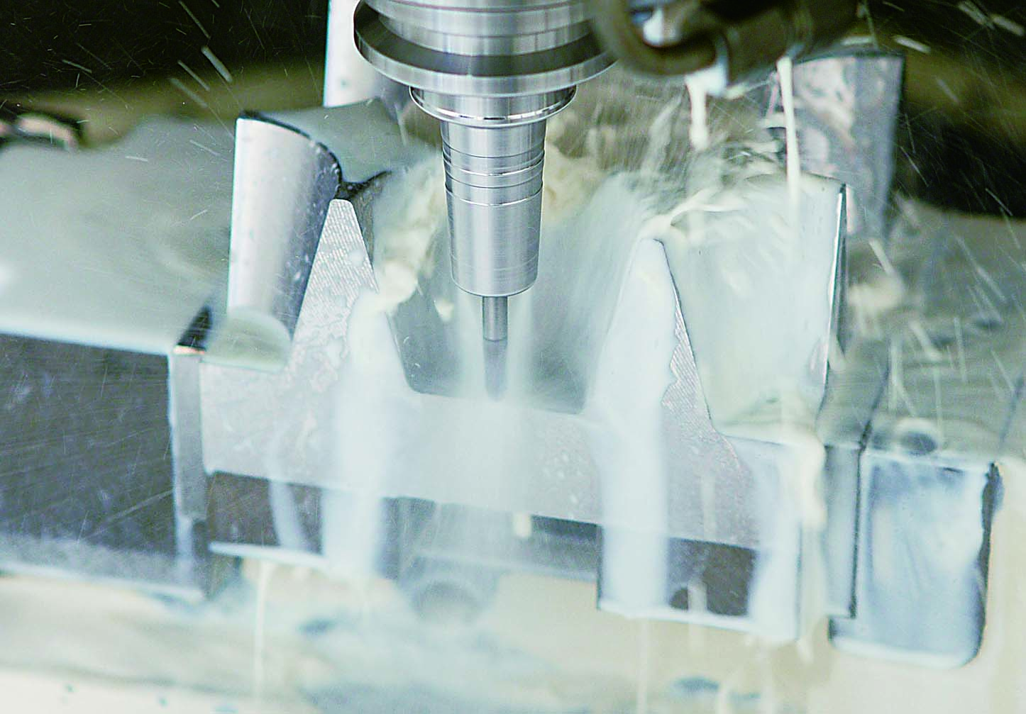

Coolant-delivery features can be found in many of the latest toolholding products, according to Alan Miller, senior manager of engineering at BIG DAISHOWA Inc. in Hoffman Estates, Illinois. The company offers chucks with coolant-delivery capabilities that supplement flood and center-through coolant systems. “We're giving coolant that extra path to get exactly where it needs to be for improved tool life, better finishes, and all the other things that come with better coolant delivery,” Miller said.
One example is BIG DAISHOWA’s Jet Coolant hydraulic chuck toolholders, which direct coolant down the shaft of a tool to the tip. Miller described this product as a middle-size holder, in between larger standard hydraulic chucks that are mostly reliant on flood coolant and the company’s smaller Super Slim hydraulic chucks, whose walls aren’t thick enough to accommodate coolant ports.

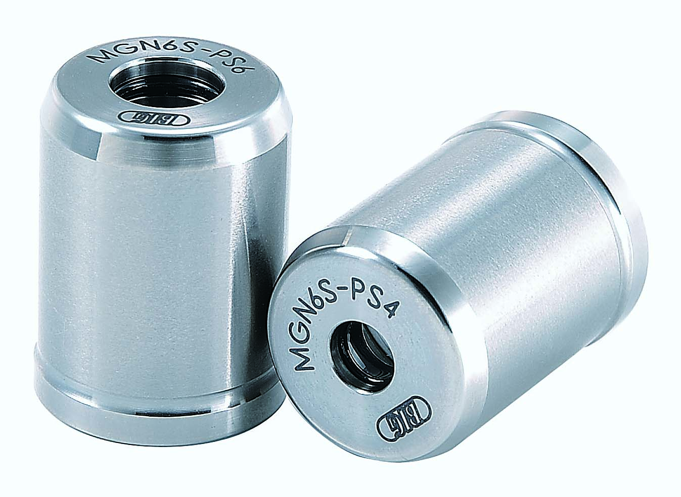

Similar capabilities come with two versions of the company’s Mega Micro product. This collet chuck features a notch-free nut design developed to prevent vibration and noise, while also offering good balance and concentricity. A sealed nut for directed coolant delivery is available with the product’s 6S and 8S body sizes.
According to Miller, effective coolant delivery isn’t simply a matter of adding some ports to a toolholder. “It is a patented thing,” he said, involving “compound angles that are designed to get the coolant to the right spot and at the right pressures and speeds.”
