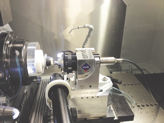

Micro-LAM%20Setup%20on%20DTM.tif
A Micro-LAM system installed on a diamond turning machine is ready to machine a ceramic lens. Image courtesy Micro-LAM Technologies.

One company working on commercialization of laser-assisted machining is Micro-LAM TechnologiesInc., which has a manufacturing facility in Battle Creek, Mich., and a research facility at Western Michigan University. As Chief Technical Officer Deepak Ravindra explained, the company is collaborating with machine builders and users of diamond turning machines to improve precision-optics manufacturing.
"Diamond turning is a very efficient way to produce optical-quality parts, especially ceramic ones," he said. "However, these materials are so hard that extensive tool wear is a problem, as is fracturing the material under heavy cuts. We've developed a hybrid system that shines infrared laser light directly at the point where the cutting tool contacts the workpiece, thus softening the material."
Micro-LAM treads a "Goldilocks" line of not-too-hot, not-too-cold laser energy, one that if not controlled can easily turn hard, brittle ceramic into a taffy-like mess. Ravindra said the thermal sweet spot is material-dependent, but typically hovers around 700° to 1,000° C (1,292° to 1,832° F). "It's pretty hot, but you have to remember that the soft area is small—20µm to 100µm across—and the heat falls away with the chips. There are no negative effects on the material. The results are much lower cutting forces, improved surface finish and significantly enhanced tool life."
Ravindra said Micro-LAM temporarily reduces the hardness of ceramic by 50 percent or more without affecting its post-machining strength or material properties. Micro-LAM also shows promise in reducing machining times on Inconel and other superalloys, although initial results—while impressive—are not in the same league as they are for friable materials, such as ceramics.

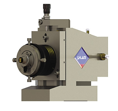

Micro-LAM%20Next%20Gen%20Tool%20Design.tif
CAD drawing of a commercially available Micro-LAM system that can be retrofit to a diamond turning lathe in less than 20 minutes. Image courtesy Micro-LAM Technologies.

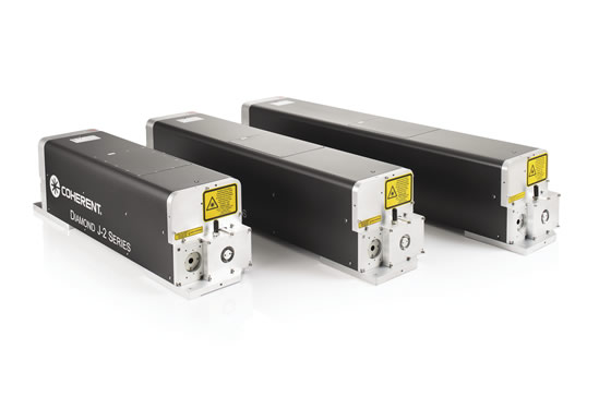

Coherent_Diamond%20J%20Series%20267-hi.tif
CO2 lasers are used in numerous LAM applications. Image courtesy Coherent.
"We haven't done extensive testing with superalloys, only because the overwhelming response from the ceramics industry is consuming most of our efforts," he said. "The value proposition here is significantly higher than that of other materials. Given the potential for quick payback on investment, it's a massive market."
That return on investment may be as fast as 6 months for some high-volume manufacturers on an investment of less than $200,000, Ravindra claimed. And, compared to other industrial lasers that consume kilowatts of electricity to operate, Micro-LAM uses less power than a 60w lamp.

Someone who knows laser power is Frank Gaebler, marketing director for laser provider Coherent Inc., Santa Clara, Calif. Gaebler agreed there's substantial interest in LAM, particularly among those manufacturers processing ceramic materials, but the environment in a machine tool presents some obstacles.
"There are cutting fluids and debris that may contaminate optics or even damage them if protective measures aren't taken," he said. "This is not much of a problem with industrial cutting lasers because the optics are shielded with a gas stream or protective window, making them less delicate and prone to environmental interference. It's far different than the controlled and delicate heating of material that occurs with LAM."
Another consideration is the variety of materials many shops process. As Gaebler explained, the cutting lasers used in sheet metal shops require a shielding gas to create an exothermic reaction, similar to flame or plasma cutting. The same laser can cut stainless steel, brass or aluminum by simply changing the gas. Not so with LAM, which relies on the correct wavelength and power level to heat and, therefore, soften the workpiece.
Nor are there general-purpose, tunable-frequency lasers available, except for scientific applications. "As a rule, you would need to change lasers to process substantially different materials," Gaebler said. "Despite the challenges, however, I've seen LAM used successfully with special alloys and ceramic materials that are very difficult to process otherwise."
