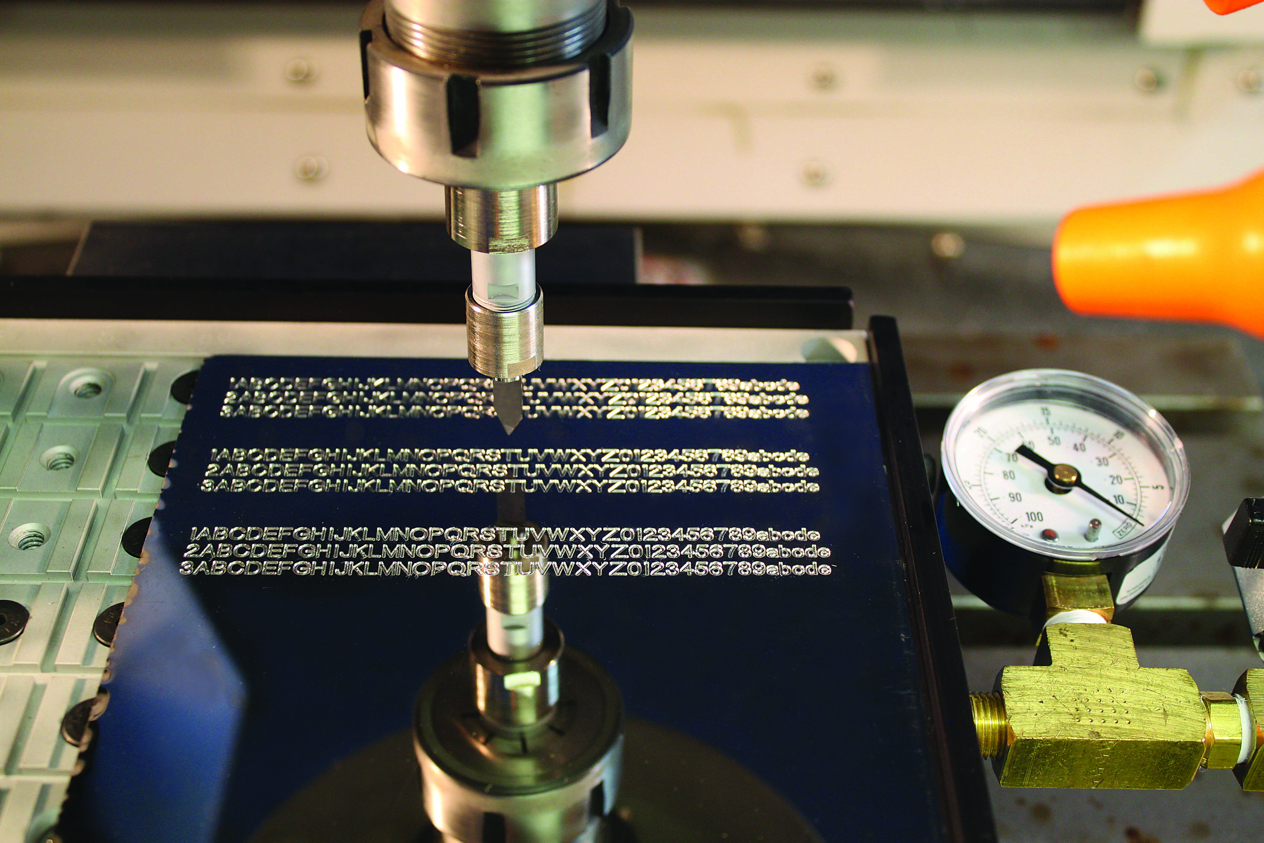

A 2L engraving tool in the company’s spring-loaded engraving toolholder, which allows fast plunging into hard alloys. Image courtesy of 2L.
“We have large aerospace customers who have all the parts-marking technologies they could want—dot-peen, laser and cutting tools like ours,” said Lance Nelson, president of 2L Inc., Hudson, Mass. “There are reasons for them to use each one.”

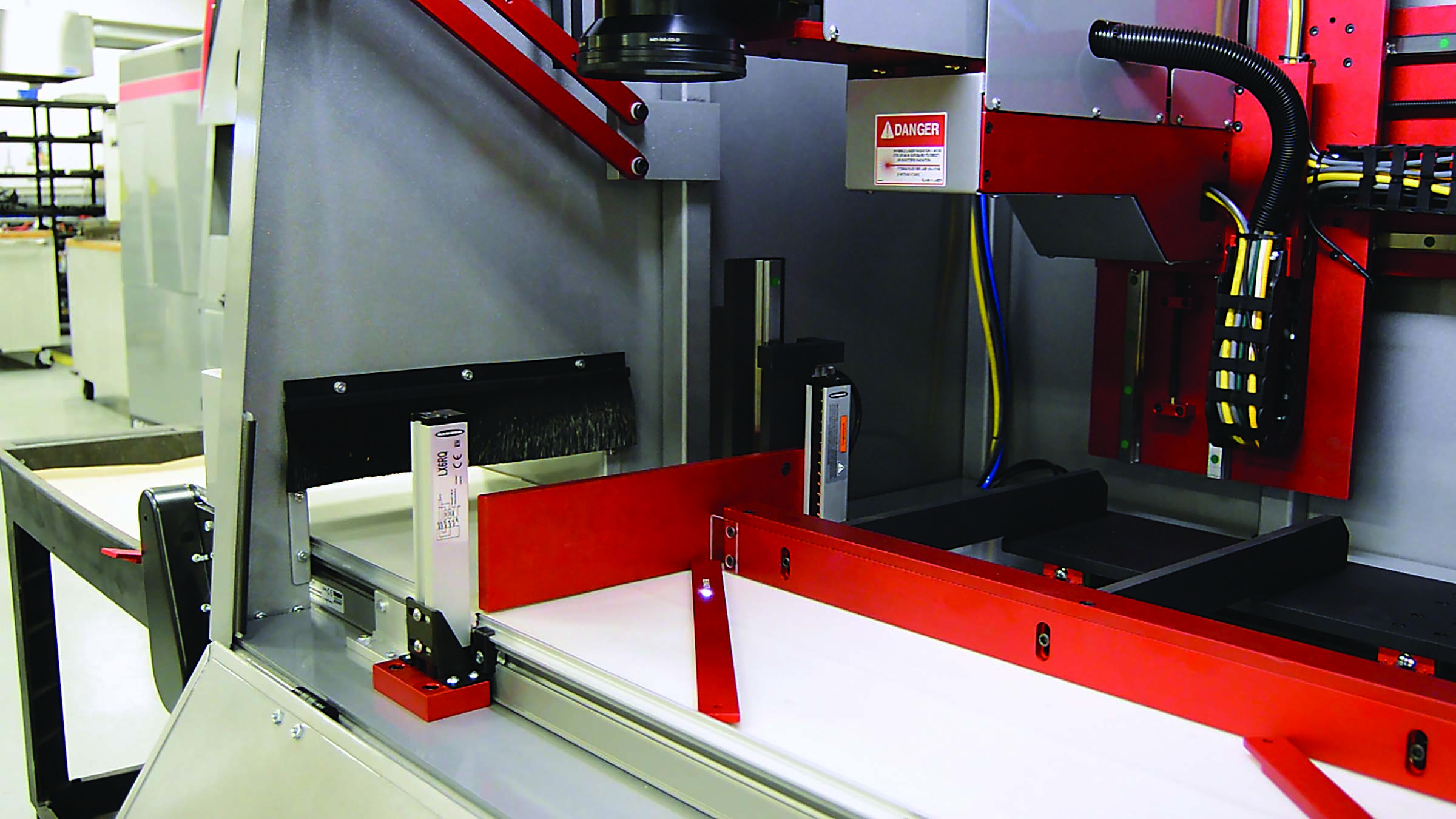

Aerospace is a big part of the business conducted by Beamer Laser Marking Systems, Flushing, Mich., said Brian Bittner, the company’s national sales manager. “We do a lot of aerospace and medical parts, as well as [serve] lower-mix, higher-volume areas such as automotive, where the speed of laser marking is a big advantage.” Laser marking cutting tools is another of the company’s niches—and is a high-volume area too, he noted. Along with making, selling and servicing seven series of laser-marking systems, Beamer provides marking services on a contract basis to customers that aren’t ready to purchase a system of their own.
Shining a light on an object is generally a faster process than physically cutting it with a blade or hitting it with a hammer. It would seem, therefore, that using a laser must be a faster marking method than impact marking, such as dot peen or engraving. But that isn’t necessarily true.
“Don’t get me wrong—impact marking is very fast as well,” Bittner said. Laser has other advantages, however, including its minimal effect on the part being marked. Because the beam spot size is down to 20µm and the pulse length is so short (measured in nanoseconds), there’s a negligible heat-affected zone.
Choosing a parts-marking method depends on the application
The operator can simply scan a work order or bar code to have job-specific data autopopulate in a Beamer laser-marking system. Image courtesy of Beamer Laser Marking Systems.
Moreover, laser marking common materials, such as stainless steel, is done by a process called annealing. The beam heats the metal enough to draw carbon to the surface, creating a dark spot (think of burned toast) but without melting the metal or changing its dimensions. Bittner contrasts this process with the danger of stress fractures that can be introduced from impact marking and burrs from engraving systems.

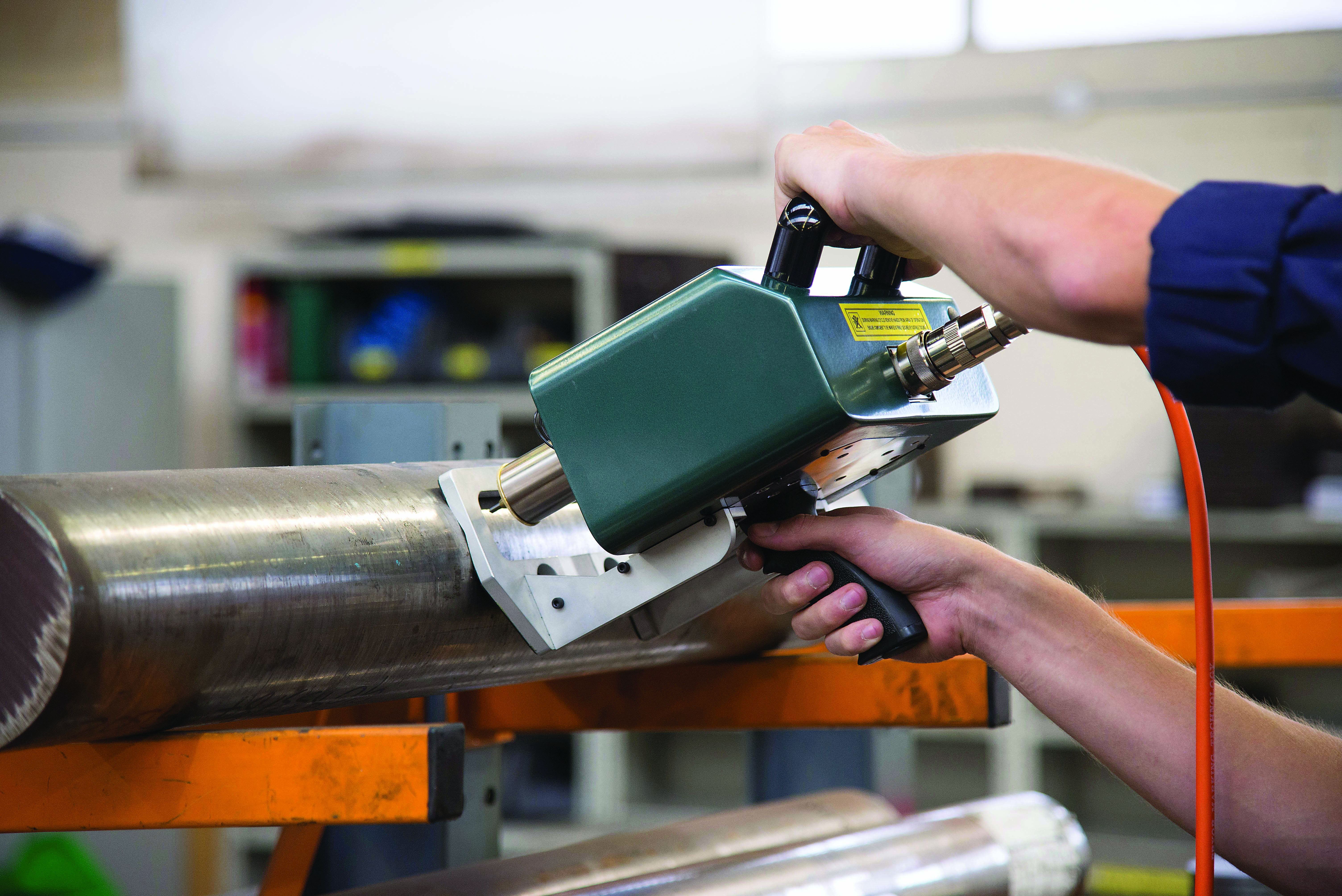

In dot-peen marking, a carbide- or diamond-tipped stylus is driven into the part to make a matrix of small but permanent indentations—dots. This process results in markings that resemble the characters created by the once ubiquitous dot-matrix printers.
The process, which was carefully managed to minimize stress in aerospace parts, caught on in other industries. A flood of inexpensive, pneumatically driven imitations were used in industries such as automotive, where speed mattered more than concerns about stress fractures, Pentz said. “It’s these systems that are now being replaced by laser-marking systems.”
Scannable 2D dot-matrix code and tracking numbers created with a Dapra dot-peen marking system. Image courtesy of Dapra.
Dot peen is still a valued part-marking method in other industries, however. Pentz mentioned aerospace, oil and gas, and construction. In those industries, part volumes tend to be lower than in automotive. “For a 10- to 25-person machine shop, dot peen is still a very good method. It’s economical, and it can do basics such as serialization and date coding that you need for traceability.”
The technology has evolved over the decades. Pentz said there are still pneumatically driven systems, but for the most part the norm is now electromechanical solenoid—an all-electric system. Where the technology has changed the most, he noted, is in how data is sent to a marking system and then returned. “There’s more and more focus on database connectivity and communication now—basically aiming to eliminate the need for an operator to input data. That and making the systems more compact have been the biggest movements in the technology.”

Dapra’s PryorMark is a portable, hand-held, fully programmable dot-peen system. Image courtesy of Dapra.
There are many kinds of engraving tools, Nelson said, with different radii at the end, different conical-included angles and lots of different tip sizes, depending on the size of the marks to be engraved.
2L also makes a spring-loaded engraving toolholder. Instead of setting the engraving tool in a rigid toolholder, the engraving tool fits into the collet of a spring-loaded device, which in turn fits into the spindle. The toolholder pushes the tool into the part with the spring. “It’s not rocket science—it’s a fairly simple, low-cost device,” Nelson said. “But it’s useful because it allows faster engraving than with a rigid toolholder.”
People generally plunge pretty slowly with engraving tools, being wary of the damage that can come from quickly pushing the tool—with its small, sharp point—into a hard material, such as tool steel, Nelson explained. Because the spring has give, the spring-loaded tool allows faster plunging into the part.
As multiaxis machining equipment and software have improved, 2L has had to innovate to “jog alongside them in order to keep up,” Nelson said, to ensure that its tools and systems can take optimal advantage of those improvements. For example, 2L offers a CAM program that lets users enter whatever data needs to go into a 2D data matrix code, Nelson said. After typing the data, “you push a button, and the software generates the G code to create the 2D data matrix. We’re trying to keep traceability and parts marking as simple as possible.”
