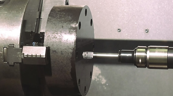

OSG%20-%20XPF003.tif
Courtesy of OSG Tap and Die
OSG's OIL-S-XPF form tap creates threads in 4120 alloy steel bar stock used for testing. The tap can be applied in steels up to 40 HRC.
A form tap has a larger tool cross-section than a comparable cutting tap. This means form taps are more rigid and less prone to breaking. Form taps are more stable when threading than cut taps, which must have large flutes to evacuate chips. "If all the variables are in place, a form tap can outlast a cut tap 30, 40 or even 50 to 1," YG-1's Zaitoon said.

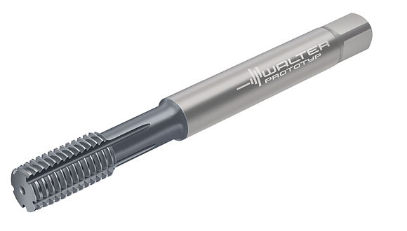

Walter%20Prototyp%20Protodyn%20S.tif
Courtesy of Walter USA
Walter Prototyp's Protodyn S HSS-E thread former for blind- and through-holes is available in sizes M1 to M24.
