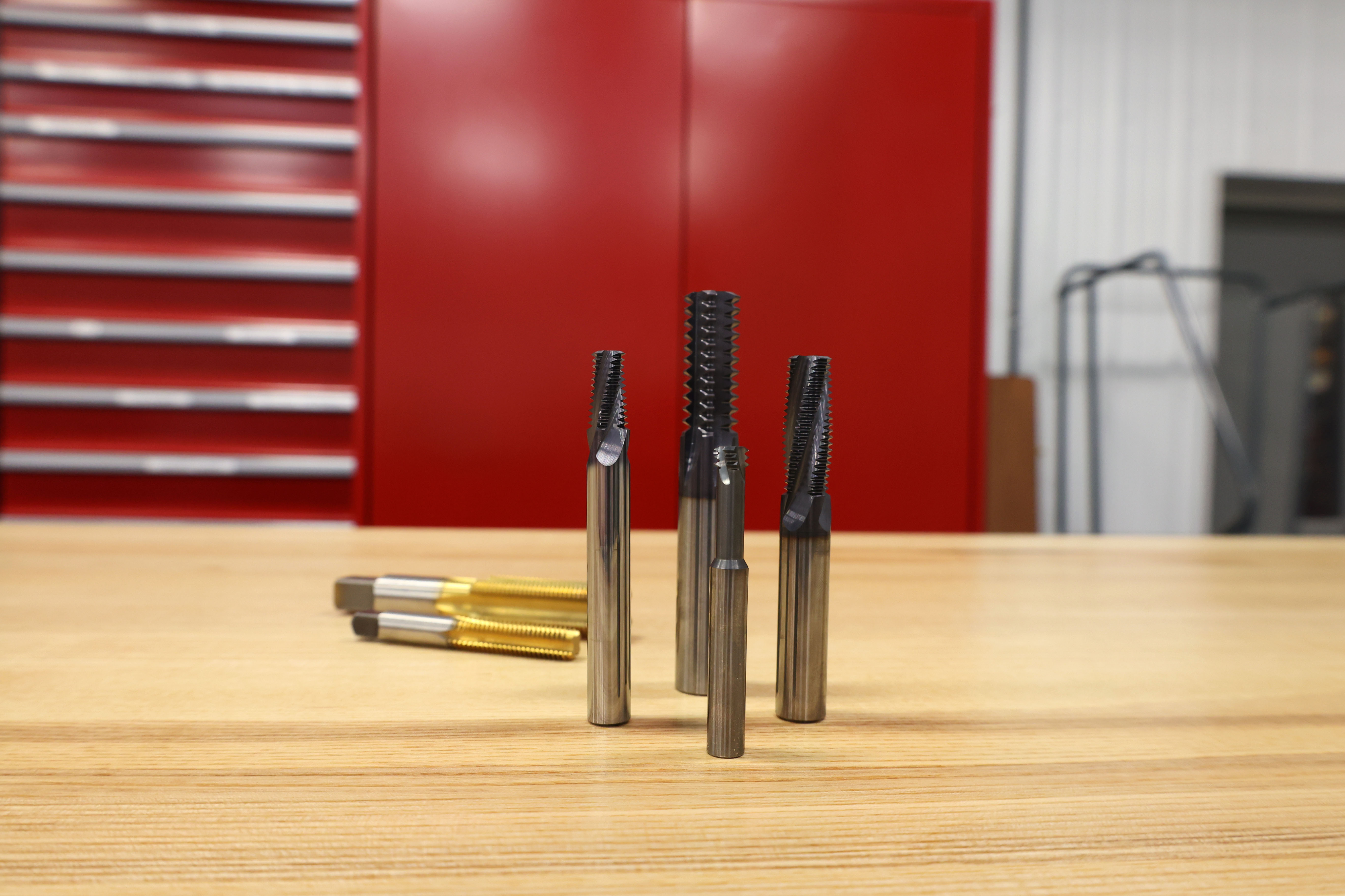

When to thread mill instead of tap?
There are many instances where a user would want to consider using a thread mill instead of a tap. In numerous cases, this comes back to one common issue: taps break. Because the tap is the exact same size as the hole, there is a lot of pressure when a user forces the threads into the hole—even more so in difficult-to-machine materials. Additionally, a tap’s cutting edges are constantly in the cut, thus generating more heat. A thread mill on the other hand has little contact with the material, and the heat generated is much lower—an added benefit in any manufacturing process. Finally, when using a tap, chips are more difficult to form and remove.
All of these things mentioned above lend themselves to tool failure. When the tap breaks off, it often results in a scrapped part, so using a tap works better when it is an inexpensive part being made. If it is a more expensive part and the tap breaks, the user is now faced with the challenge of trying to remove the tap and salvage the part. This is a time consuming operation that impacts the  part’s quality and manufacturing cost.
Not only would the manufacturer want to thread mill whenever the part is expensive, but they would also want to thread mill when working with a large hole diameter. Of course, a tap is just as large as the hole, so for a 4 in. thread diameter, a 4-in diameter tap is needed. Instead of buying this expensive, large piece of metal or storing taps for every thread size, the company could buy an off-the-shelf thread mill and interpolate the thread into multiple thread sizes including those large diameters. Lastly, thread mills consume significantly less power from a machine in the instance of large diameters.
Other advantages of thread mills include the ability to hold tight tolerances by controlling the tool’s cutting path. As the tool shrinks slightly from wear, it is easy to compensate this at the machine by using tool diameter offsets.
Nevertheless, there are occasions where tapping may be the better choice over thread milling. For example, a user would want to use a tap when machining long lengths of thread. Due to the lack of radial load, there is no concern about the tap’s stability or tool deflection. In addition, when speed is preferred over thread quality, taps are again the better choice. In many applications, a tap will have a shorter cycle time than a thread mill. However, this still comes with the risk of breaking the tap and spending valuable time to get it removed.
