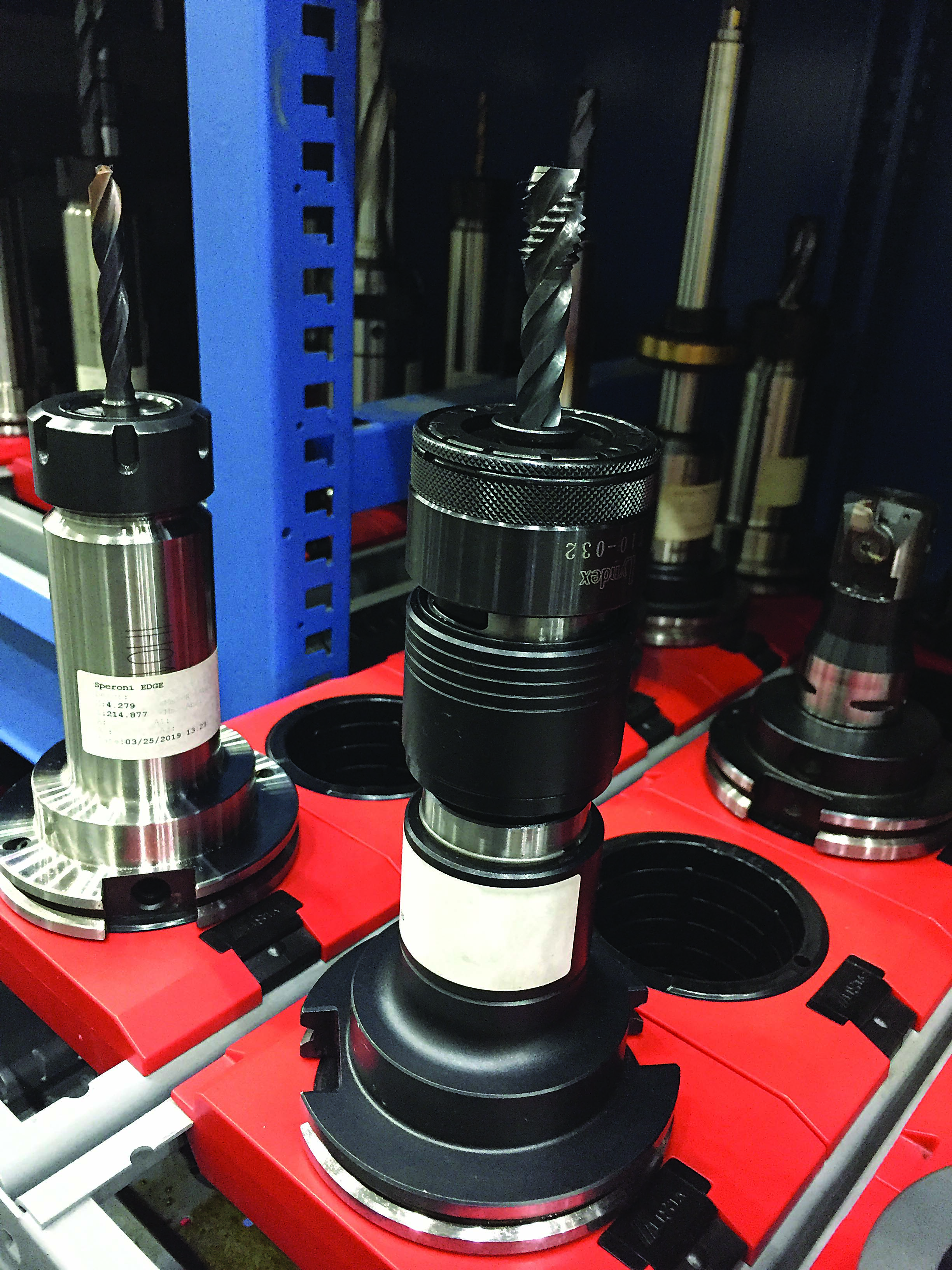

Mitsubishi Hitachi Power Systems Americas has the rigid tapping option on its controls but uses tension compression holders like this one to give another level of protection from errors in programming or setup. Image courtesy of C. Tate

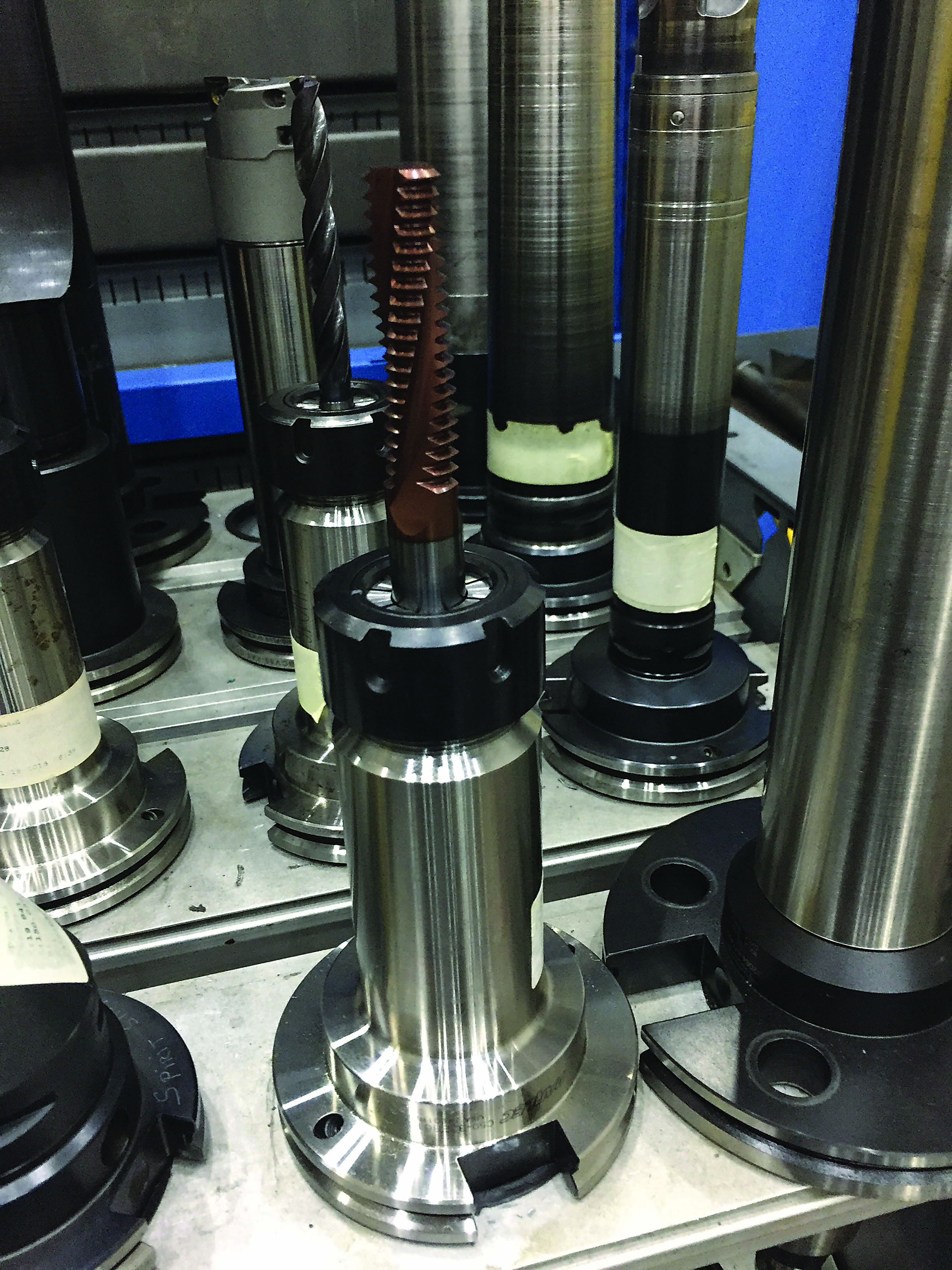

Thread milling is the first choice for threadmaking at Mitsubishi Hitachi Power Systems Americas. Making threads that have a large depth-to-diameter ratio can be much easier with a thread mill than with a tap. Image courtesy of C. Tate
The second setup incorporated a standard double-angle collet, which worked much better until the tap started to wear, increasing cutting forces to the point that the tap began to slip in the collet. The result was poor thread quality and a grimace as I wondered how much of the tap was going to exit the hole. I tried a few other methods and finally found relief when my tap salesman suggested I use a tension compression holder.
Tension compression holders are spring-loaded and allow axial movement of the tap, which mitigates undesirable effects associated with tap movement. These holders also are designed specifically for holding taps, so they don’t have issues with movement in the collet. Technically, a tension compression holder is not needed for rigid tapping. However, the holder does protect against small inaccuracies in the system. Because the holders are easy to use and one size accepts a variety of tap sizes, I started using them all the time.

I learned many lessons about tapping, but the most valuable lesson was how to thread mill. Thread milling can be a far better way to thread holes than tapping. I became familiar with thread milling at a trade show. I tried thread milling on my machines, and now I reach for the thread mill before the tap. With thread milling, I do not need to reverse the spindle. There are typically no coolant or toolholder issues. And broken thread mills do not usually stay stuck in holes like broken taps.
