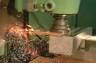

Greenleaf_Milling2.tif
Courtesy of Greenleaf
Roughing hardened tool steel with a facemill tooled with ceramic inserts.
“By machining after heat treatment, you not only avoid secondary operations, but also eliminate problems with workpieces being twisted, bent or otherwise out of shape due to heat treating,” Minton said. “This allows you to make a part with higher accuracy and better dimensional characteristics compared to parts heat-treated after machining.”

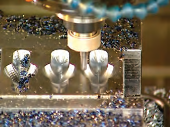

Micro_cavity_milling.tif
Courtesy of Makino Inc.
Hard milling miniature mold cavities.
“Due to the high level of energy needed to create a chip in hardened steels and the abrasive action of the workpiece, you need a tool with a lower-volume cobalt and fine-grain substrate to endure the high loads and temperatures seen in dry machining,” he added.
Coated carbides offer a good trade-off between heat and wear resistance and between strength and toughness, according to Wells. “It’s all about compromise. Ceramics and PCBN definitely have good heat and wear properties, but are more fragile when it comes to shock and imperfect cutting conditions.”

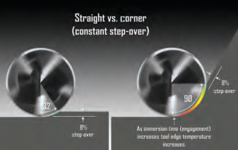

Straight vs Corner Constant Stepover Split stock.psd
Courtesy of Surfware
Constant cutter engagement is critical in hard milling operations.
When hard milling, it’s important to avoid shocking the tool, especially a ceramic one. This can be accomplished by reducing the feed rate on entry and exit, taking a circular toolpath into the workpiece and ramping into pockets and cavities. CAM systems do this automatically, according to Hill.
As proof, he related a story about a WESTEC show where he’d been struggling with tool life during a hard milling demo. “One of the CAM guys came over from a neighboring booth and offered to reprogram our toolpaths,” Hill said. “When he was done, tool life went from 15 to 20 minutes all the way up to an hour.”
Hill attributed this success to better control of tool engagement and adjusting for chip thinning. “You need to maintain a constant average chip thickness, and chip thinning can occur if the radial and axial cutter engagement of the cutter decreases,” he said. “As the chips get thinner, you need to increase the feed rate to compensate. Otherwise, you’ll end up rubbing the cutter to death.”
