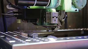

Toolmakers have embraced wire EDM for cutting PCD to make inserts. The EDM wire, a rotary table and a Renishaw probe
used to locate the surface of each PCD tip are shown inside a FANUC EDM.  Image courtesy of Methods Machine Tools.

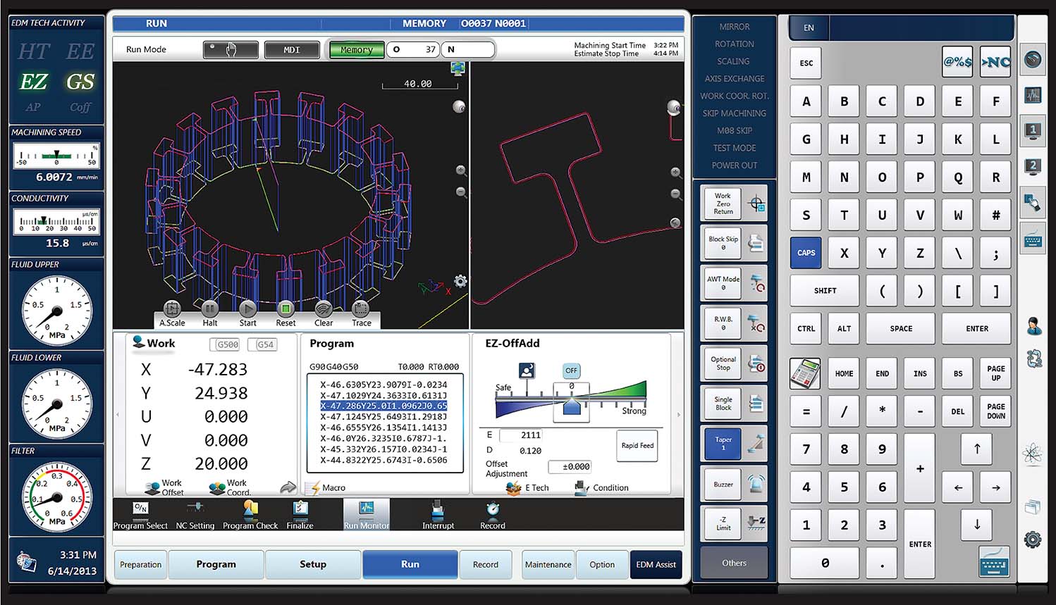

The major wire EDM builders are still in competition, of course, but on other playing fields. One is ease of use. Brian Pfluger, EDM product line manager for Makino, Mason, Ohio, believes that one reason end users have shown more acceptance of wire EDM in recent years is because all builders have strived to remove its stigma of being a “black art” that takes specialized, hard-to-come-by knowledge to do effectively. Makino and its competitors have adopted a more Windows-based architecture for their controls to make them more like a standard computer or smartphone interface, he said.
With Makino’s Hyper-i EDM control, for example, activities like programming are performed as they would be on a vertical machining center control. “You’re able to take an operator who knows milling and train him and transition him to run a wire EDM quickly,” Pfluger said.
Like the smartphone its interface resembles, the Hyper-i control can have numerous apps to assist the operator with challenging tasks. One example is E-Tech Doctor, which assists in making precise modifications to cutting conditions using a conversational interface. Based upon operator inputs, the machine automatically outputs a corrective setting without the operator needing expert-level knowledge of the many E-code element settings.
“The E-Tech Doctor helps an operator to improve surface finish, part straightness and corner accuracy,” Pfluger said.
Making controls that are easier to use and maintain is a “megatrend” in the industry, Pfluger added, explaining that it is widely recognized that the incoming generation of operators is likely to have less knowledge and experience than the preceding generation.

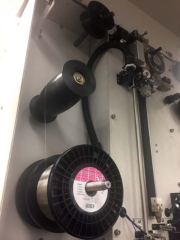

A Belmont Thermo SD wire spool is set up on a FANUC wire EDM.
Image courtesy of Belmont Equipment & Technologies.
Down to the Wire
In speaking of ways that wire EDM technology has advanced, one can’t ignore the EDM wire itself. Belmont Equipment & Technologies’ Tony Tyll discussed the range of diameter and material options available.
Wire diameter is the main criteria, Tyll said, with the most-popular sizes being from 0.008" to 0.012" (0.203mm to 0.305mm). “That’s the sweet spot for most applications,” he said. The decisions that drive the selection are usually geometry-related on the back of the workpiece. Details or smaller radii on the workpiece can dictate the need for a smaller-diameter wire.
The manufacturability challenges of brass wire go up as the diameter decreases, he noted. There are some suppliers that make specialty wire 0.003" and 0.004" (0.076mm to 0.102mm) in diameter.
