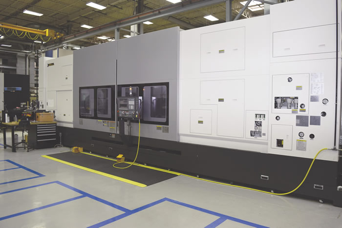

The technologies of the MULTUS B750 limits operator intervention and work handling. Previously, operators had to remove a component from a machine and flip it to machine the opposite side, but, with the twin-spindle capability of the new 6-axis horizontal lathe, the work can be transferred from the first spindle to the second one automatically. Cheek added that theNorthstar improved part handling by 50 percent and overall operation efficiency by 30 percent.
Northstar Aerospace produces helicopter transmission parts hardened up to 60 HRC on its Okuma MULTUS B750 horizontal lathe. Image courtesy Northstar Aerospace.
To overcome issues Northstar was experiencing with part distortion on its previous machines, the company worked closely with Okuma and Morris application engineers to fine-tune the cutting processes. Northstar discovered by changing the order a part is cut, it could minimize distortion.

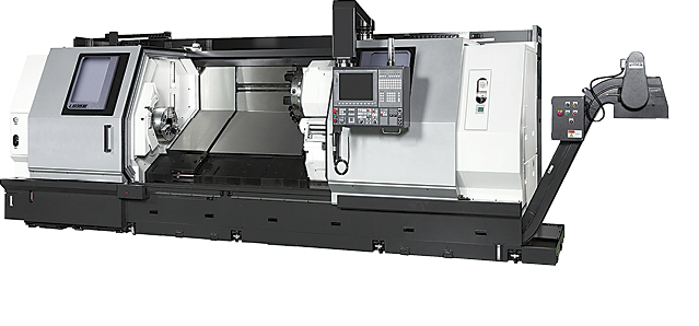

Besides the MULTUS B750, Northstar purchased an Okuma LB35III single-saddle horizontal lathe. Image courtesy Okuma America.
In addition to the CAD/CAM software, the setup on the B750 also includes other efficiency-improving technologies from Partners in THINC (a collaboration among Okuma and suppliers of cutting tools, software, workholders and other manufacturing equipment). These include: a probe from Renishaw Inc. for in-process gaging, which allows the machine to check the part itself without operator intervention; a high-pressure coolant system from MP Systems Inc., which enhances coolant flow to the cutting tool and helps extend tool life; and Tool Monitor Adaptive Control from Caron Engineering Inc., which monitors electric current load to the spindle and stops the machine if the load exceeds its established value. TMAC also has an adaptive feature that increases or decreases cutting feed rates if a load is within a safe cutting range. Northstar also turned to Sandvik Coromant Co. for toolholders and inserts.
