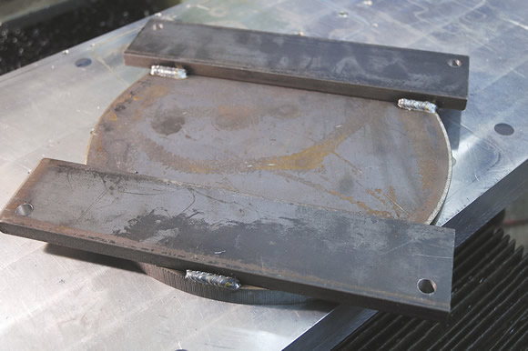

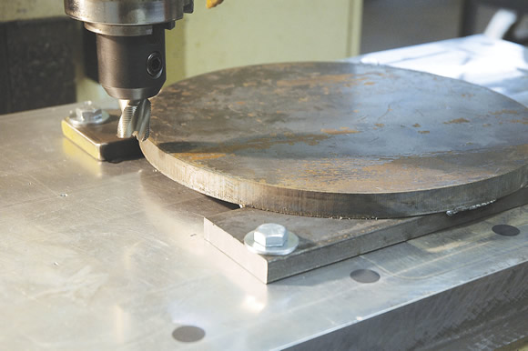

With certain kinds of profiling (above), weld a part to the hold downs without the need for extra holding stock. Welding from the backside (below) also provides a little chip clearance and room for drill penetration under the part.

■ With certain kinds of profiling, you can weld a part to the hold downs without the need for extra holding stock. Once the profiling is complete, remove the hold-down bars or tabs and surface the second side. This technique keeps the blank thickness close to the finish size, eliminating the large amount of holding stock that makes surfacing the second side an effort. This method works well for open shapes like “C” and “H,” which could be distorted from heavy clamping pressure.

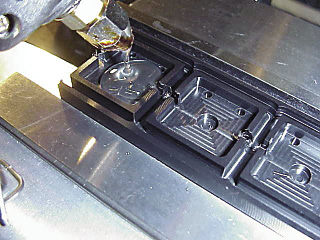

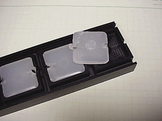

Top: Use hot-melt glue to support a part for secondary operations. Bottom: On most smooth machined surfaces, this glue can be plucked off without leaving a residue. Apply a little spray mold release to make removal even easier.

■ I’ve been using a trick I learned from a buddy with great results. Use hot-melt glue to support a part for secondary operations. For example, if the part floor is thin and the back was surfaced over the thin floor, chatter results and an unacceptable finish is imparted. By filling and supporting the thin floor with hot glue, the second side comes out flat with an excellent finish. Thin webs, floors and overhangs can be supported with this cheap material. On most smooth machined surfaces, this glue can be plucked off without leaving a residue. Apply a little spray mold release to make removal even easier. Denatured alcohol also helps separate the solidified glue from delicate features. CTE
