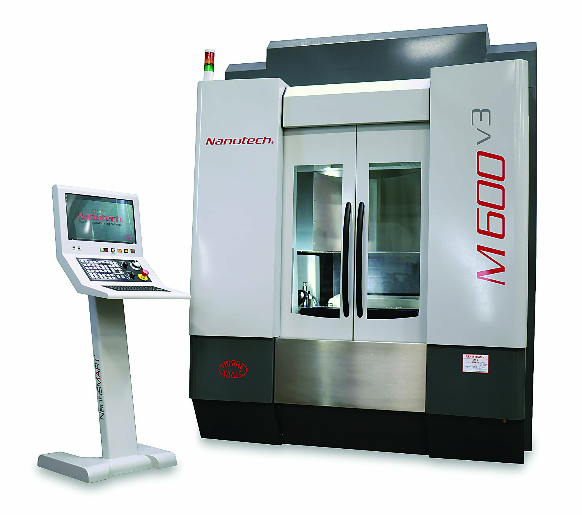

M600 jig grinder
An enhancement offered by the new M600 jig grinder is the integration of the conversational and customizable NanoSMART operating system.Image courtesy of Moore Nanotechnology Systems

For shops that are tackling the jig grinding process, the latest machines are designed to deliver top-notch results while also making the job easier. One example is the M600, a state-of-the-art jig grinder co-developed by Moore Nanotechnology Systems and its sister firm, Moore Tool Co. Inc. in Bridgeport, Connecticut.
Officially introduced last year, the most recent version of the M600 includes a number of design elements aimed at boosting accuracy, repeatability and surface finish. According to Slaughter, these include increased rigidity at the wheel point where grinding takes place. Also new is a “counterbalance” for the machine’s Z axis. Thanks to this feature, “as the spindle motor, accelerates, decelerates and reverses in its reciprocation stroke, we have zero inertia, effectively putting no forces through the machine and giving us that ability to achieve greater accuracy and better surface finish,” he explained.

Slaughter also pointed out that the frame of the latest M600 is a granite monolithic structure, setting it apart from machines with frames made of cast components. This change is meant to improve accuracy by eliminating thermal expansion and contraction.
As Slaugther sees it, however, the main enhancement offered by the new M600 is the integration of the NanoSMART operating system used by all of the company’s other machines. As a former operator of conventional jig grinders, he believes the conversational and customizable NanoSMART system will be a welcome change for current operators who have long been dealing with specialized and difficult-to-master jig grinding controllers. “It’s a big step forward in ensuring that the machine is operator-friendly and attractive to users who are familiar with other machine tool types,” he said.

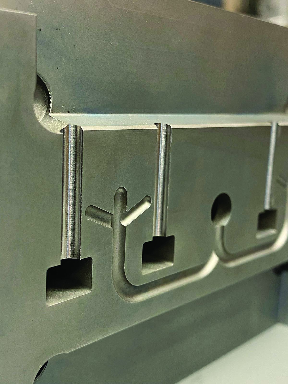

Excellent surface finish is one of the main upsides of jig grinding.
Excellent surface finish is one of the main upsides of jig grinding. Image courtesy of White Jig Grinding

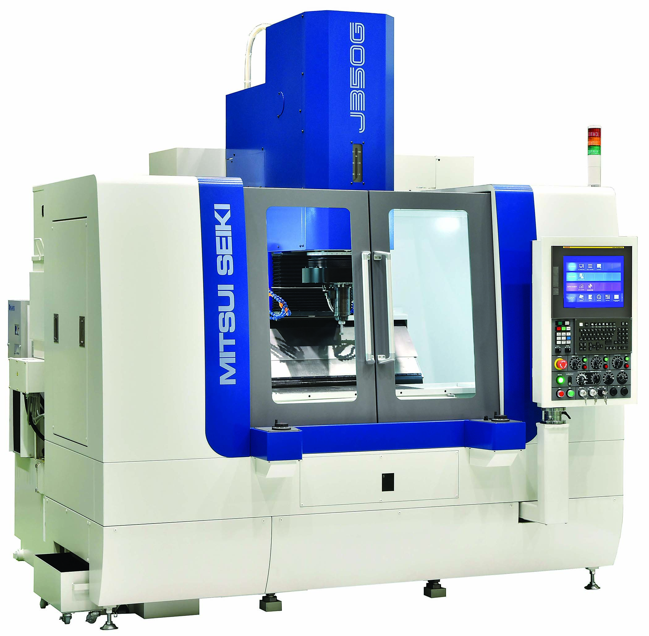

Another modern CNC contender in the jig grinder market is the J350G from Mitsui Seiki USA Inc. in Franklin Lakes, New Jersey. The J350G, according to the company, offers the largest grinding infeed stroke available among competing machines, with a U-axis range of -3 mm to 50 mm relative to the spindle center. Mitsui Seiki says this allows the machine to grind both small- and large-diameter holes, as well as multiple features, using a single wheel in a continuous automatic mode.
The J350G’s Fanuc 31i-B control includes a 15″ touch-panel LCD screen and is preloaded with G-MAPS conversational-style programming software. In addition, the control allows easy manual programming using graphic icons, data entry or conventional methods, the company notes.
Mitsui Seiki also touts the machine’s 3m2 footprint, which is said to be 50% smaller than that of its predecessor. Hand scraping and custom-designed Heidenhain scales contribute to ±0.0007 mm accuracy along the X, Y and Z axes, according to the company.
The J350G jig grinder
The space-saving footprint of the J350G jig grinder is 50% smaller than that of its predecessor. Image courtesy of Mitsui Seiki USA
