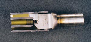

Figure 2: The cutaway (left) shows the finished bore of the outer barrel and the chamfer of the internal tube, which TFT cuts with a carbide-insert tool it produced in-house (right).
This forced TFT to mix and match finned parts and barrels to find ones that fit together properly. TFT asked the anodizing company to tighten the coating tolerance. It couldn’t. So the nozzle manufacturer’s engineers and machinists redesigned the two pieces as a single extrusion. This eliminated the press-fit problem, the costly sorting and a final assembly operation.
But it also presented a challenge: figuring out how to machine the ID of the outer barrel and center tube features as a single part. The baffle-side section of the barrel bore and center tube needed to be machined. All of the conventional trepan tooling TFT looked at was too large, and a custom tool was too expensive.
A short time before the challenge presented itself, some of TFT’s employees had learned to operate a wire EDM. So they cut an insert from C-6 carbide and machined a holder from prehardened 4140 steel (Figure 2).
This custom tool now machines the barrel bore and the center tube’s chamfer feature in one pass. A conventional threading tool is used to machine the internal tube thread. The single-piece extrusion is then sent out for anodizing and returns ready for assembly.
