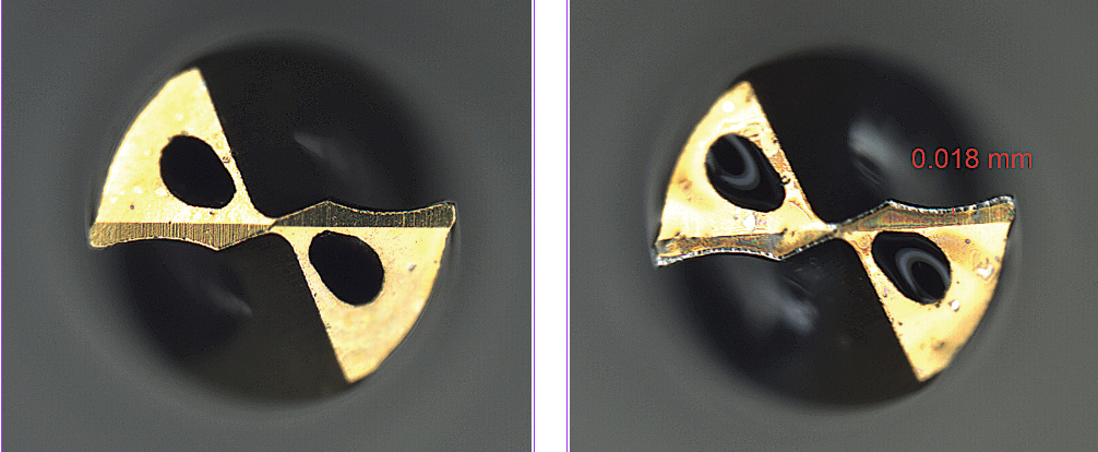

A new 1-mm drill (left) and tool wear of less than 20 µm
A new 1-mm drill (left) and tool wear of less than 20 µm after drilling 3,421 holes in stainless steel using Blasomill GT 8 X coolant. Image courtesy of Blaser Swisslube

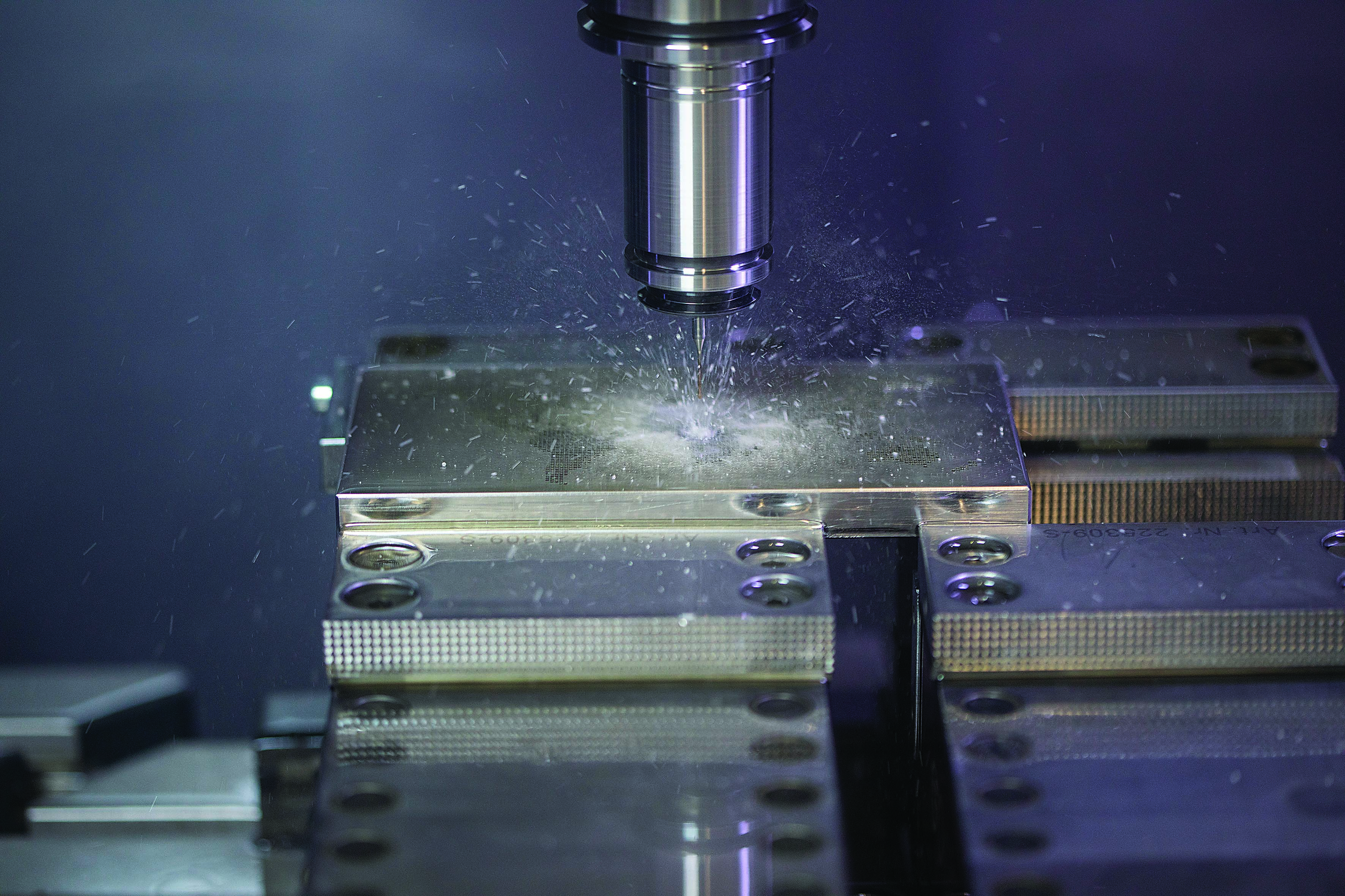

In addition, the Blasomill GT 8 X is suitable for producing small holes with the addition of a high-pressure oil delivery system. Its fast air release properties and unique additivation package, provides effective heat dispensation and optimal lubricity at the cutting edge, Blaser Swisslube reports.

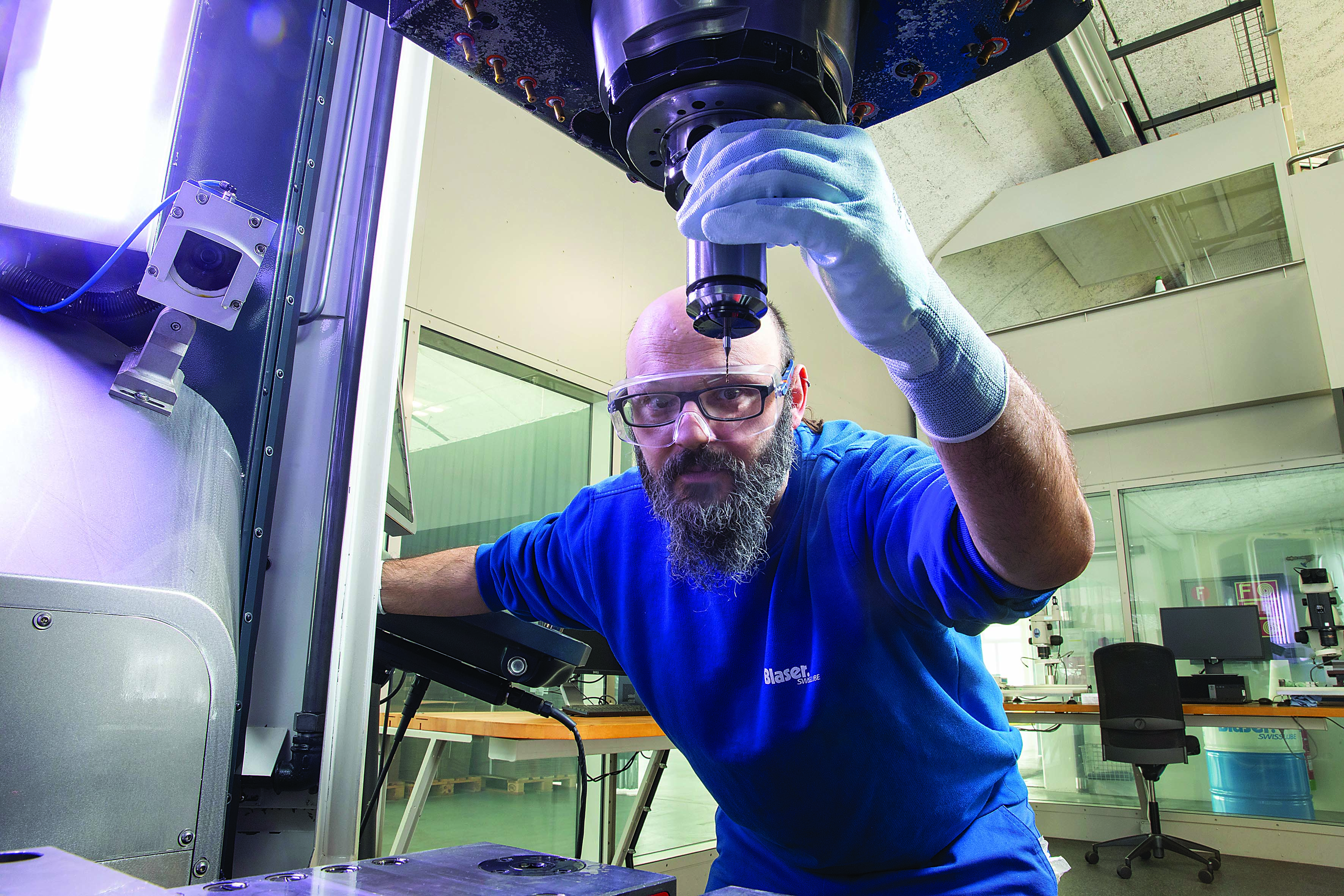

Philipp Marschall, a technician at Blaser Swisslube's technical center
Philipp Marschall, a technician at Blaser Swisslube’s technical center, prepares a small drill for holemaking with the company’s Blasomill GT 8 X coolant. Image courtesy of Blaser Swisslube

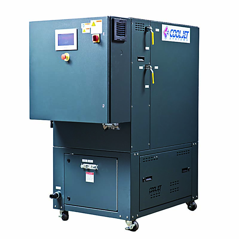

To meet a variety of customer metalworking fluid delivery requirements, the CoolJet high-pressure coolant system from ATS Systems provides “complete functionality,” said Tim Schneider, the company’s vice president.
One element is the modular design that enables a customer to add an aftermarket chiller or mist collector or both on the same footprint, he explained. “When you have an automated process, you have to have temperature control with your coolant, good filtration and mist collection all built into one platform.”
That capability enables a manufacturer that just purchased the high-pressure system to add a chiller, for example, if thermal issues occur, Schneider said. “It’s a plug-and-play option.”
CoolJet high-pressure coolant systemATS Systems reports that its CoolJet high-pressure coolant system enables end users to increase their speeds and feeds by at least 20% and tool life 3 to 10 times. Image courtesy of ATS Systems” data-entity-type=”file” data-entity-uuid=”675085e1-f18e-4c82-9412-abf61c2c3ee9″ height=”561″ src=”/wp-content/uploads/legacy/inline-images/Cooljet%20base%20model.jpg” width=”561″ />
In addition, the system is available with a fixed or variable coolant flow. A fixed flow is suitable when an end user is using the full volume, for example, of a 9 gpm system, he noted. However, if only 4 gpm are going through a cutting tool, 5 gpm travel through the bypass mechanism. “That creates 750 watts per minute of additional heat that goes back into your coolant. It can create thermal issues.”
In contrast, the variable-flow system automatically pumps the volume of coolant required to maintain the specified pressure, Scheider added. Although the variable-flow design costs $3,000 to $5,000 more, it reduces power consumption, making it less costly to operate than the fixed-flow design. “So, instead of, say, running at 60 Hertz all the time, it’s going to run at 15 or 20 Hertz.”
Having a variable-volume unit is beneficial when a machine tool uses a large number of cutting tools, he noted. “The simple rule of thumb is always use variable if you’re going to have wide variety of tool orifices and sizes. You can go with a fixed-flow system, and if you’re using all the volume, you’ll never have any issues with heat.”
One customer, however, had a fixed-flow system on a small gundrill but was experiencing thermal issues, Schneider said. The regional manager inquired whether he should sell him a variable-flow system to fix the problem, which would have fixed the situation but at a significant price. Instead, ATS calculated how much volume was going through the drill and then put a T-fitting in the high-pressure line with a correctly sized bleeder orifice.
“The drill was using two gallons a minute, and we put a bleeder orifice on for seven gallons a minute back to the machine tank and now he’s using all the volume, still drilling the hole but not creating heat,” Schneider said. “We solved this problem with a $5 Home Depot fix.”
