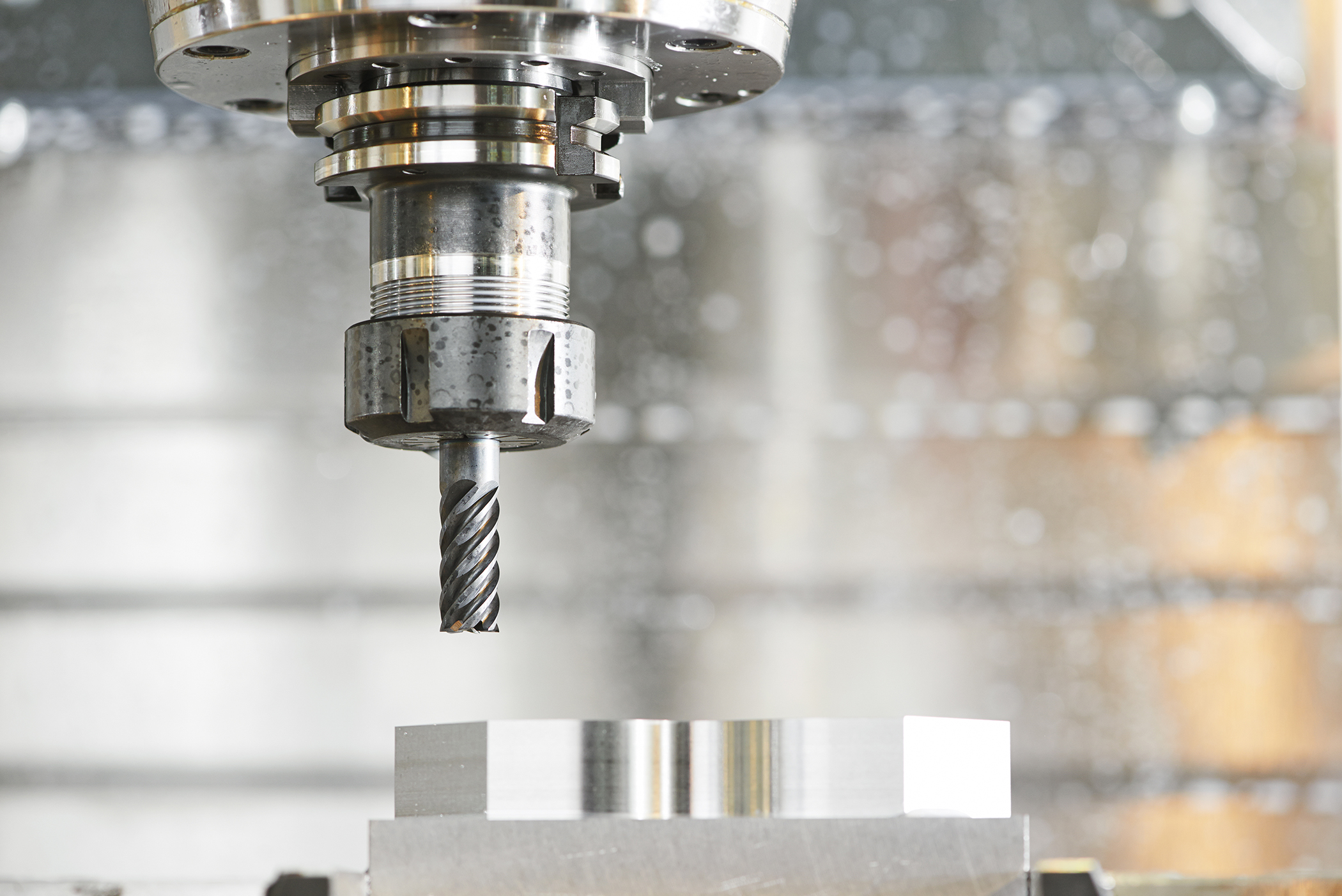

Again, a well maintained and accurate machine is the first step to combating and eliminating runout. If the milling spindle is sloppy, there is nothing that can be done to overcome it. Every tool placed in the spindle, at a minimum, will have the same amount of error as the spindle.
Selecting the appropriate toolholder is the next step. This is one of those machining topics that can ignite some serious debates. I have had tool manufacturers tell me they would not warranty tools or guarantee a process if I were not using a specific type of toolholder. The best advice is to use the holder that is best for the job. If you are drilling 0.500″ holes in hot roll plate with a +/-0.030″ tolerance, then a state-of-the-art toolholder is probably not necessary. If you are milling the final details in a die set that is worth $100,000 using a 0.0625″ diameter endmill that is 6″ deep in the pocket, you should probably be using the best toolholders money can buy. It’s all about risk.
Like all things in machining, there are lots of toolholders to choose from. For most milling work a collet chuck is going to be sufficient. ER style collets are the predominant technology today and runout of a standard issue collet and collet chuck is 0.0004″ to 0.0008″ depending on the grade and manufacturer.
If the holder is running out 0.0004″ at face, then the end of a long tool is likely running out a lot more. It is difficult to ream a hole that has a 0.0005″ tolerance with a reamer that is running out over 0.0004″. More precise holders are needed in these situations. Sometimes this can be overcome by purchasing a “precision” collet and toolholder rather than the “standard” grade.
Other times the tool can be adjusted. Turning the tool in collet will sometimes displace the “bad” spots on the collet and the tool and provide acceptable runout. I have shimmed between the tool and the collet to give acceptable results, but I only do this when it is absolutely necessary. It also is possible to purchase adjustable toolholders that allow the user to compensate for axial and radial runout of a tool. These toolholders allow the user to dial out all of the runout.
As you probably expect, adjustable toolholders are expensive and can be finicky. They are typically reserved for high production environments like automotive manufacturing. A simple cost-effective way to get adjustability in a pinch is to use a boring head. While it might take some finagling to get the tool mounted, it does allow the user to remove radial runout from tools like reamers. Running a reamer in a boring head looks wonky, but it is effective.
Milling holders are the best option for endmills. These holders use a collet but unlike ER and similar styles, these collets are size specific. Mill holders are reasonably accurate at 0.0005″ runout and provide the grip strength needed for aggressive milling, but they are beefy and it can be hard to get them in confined spaces.
Heat shrink holders are the most accurate option available for milling. Heat shrink holders can repeatably drive runout into the 0.0001″ range. Not only do they provide the best runout characteristics they also provide the strongest grip. When accuracy is paramount, heat shrink tooling is the first choice.
As expected, they are expensive and require expensive hardware to heat the holder and set the tool. The life of these holders is limited by the number of heating cycles they can endure, whereas a collet chuck has an indefinite life.
