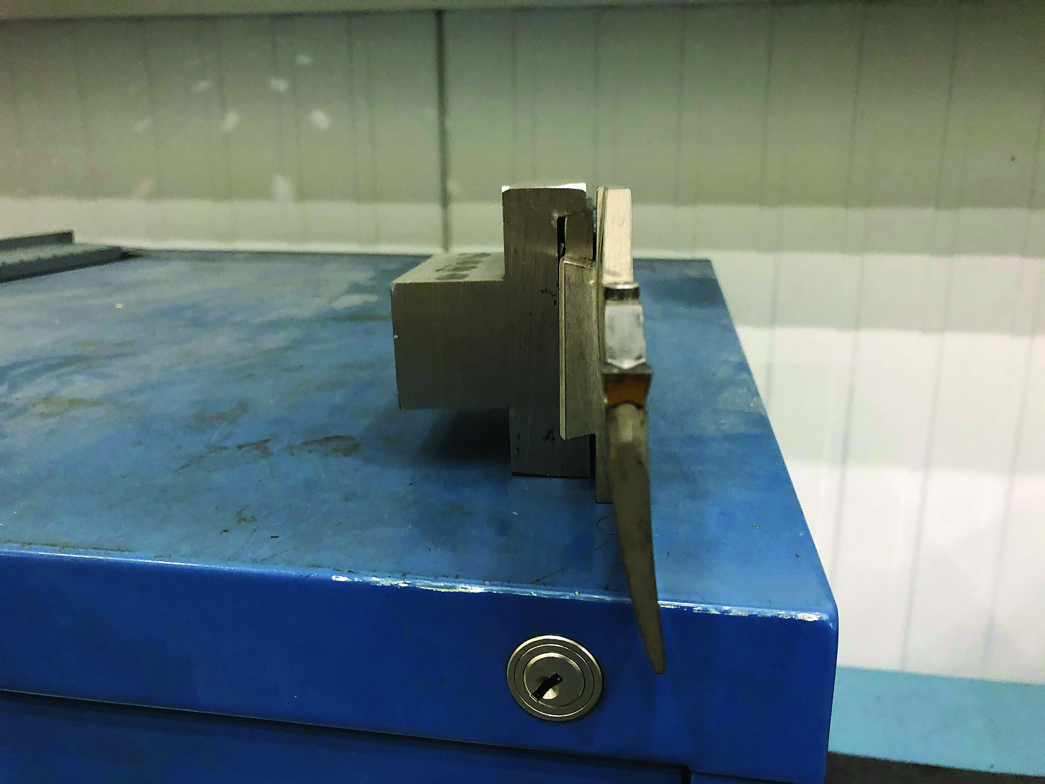

Lesson five. Face grooving can be difficult, and success requires having the proper tools. I learned this while machining very deep face grooves in pump impellers. My first attempts were made with tools we had ground at my shop. (I was still in the process of learning lesson one.) Progress came when we purchased an indexable tool with carbide inserts that was made specifically for face grooves. A face grooving tool is made with a curved shape, so the heel of the tool does not rub the curved groove. Each tool is limited to a range of diameters, which means that one tool cannot be used on all face grooves. If tools are used for diameters outside their design limits, they rub and damage a part. I also realized that face grooving tools with clamps held in place with a screw are much better than the other styles in which the insert is pressed into a slot.
This face grooving tool is used for very large-diameter grooves. The curved blade creates clearance between a tool and part. Image courtesy of C. Tate
