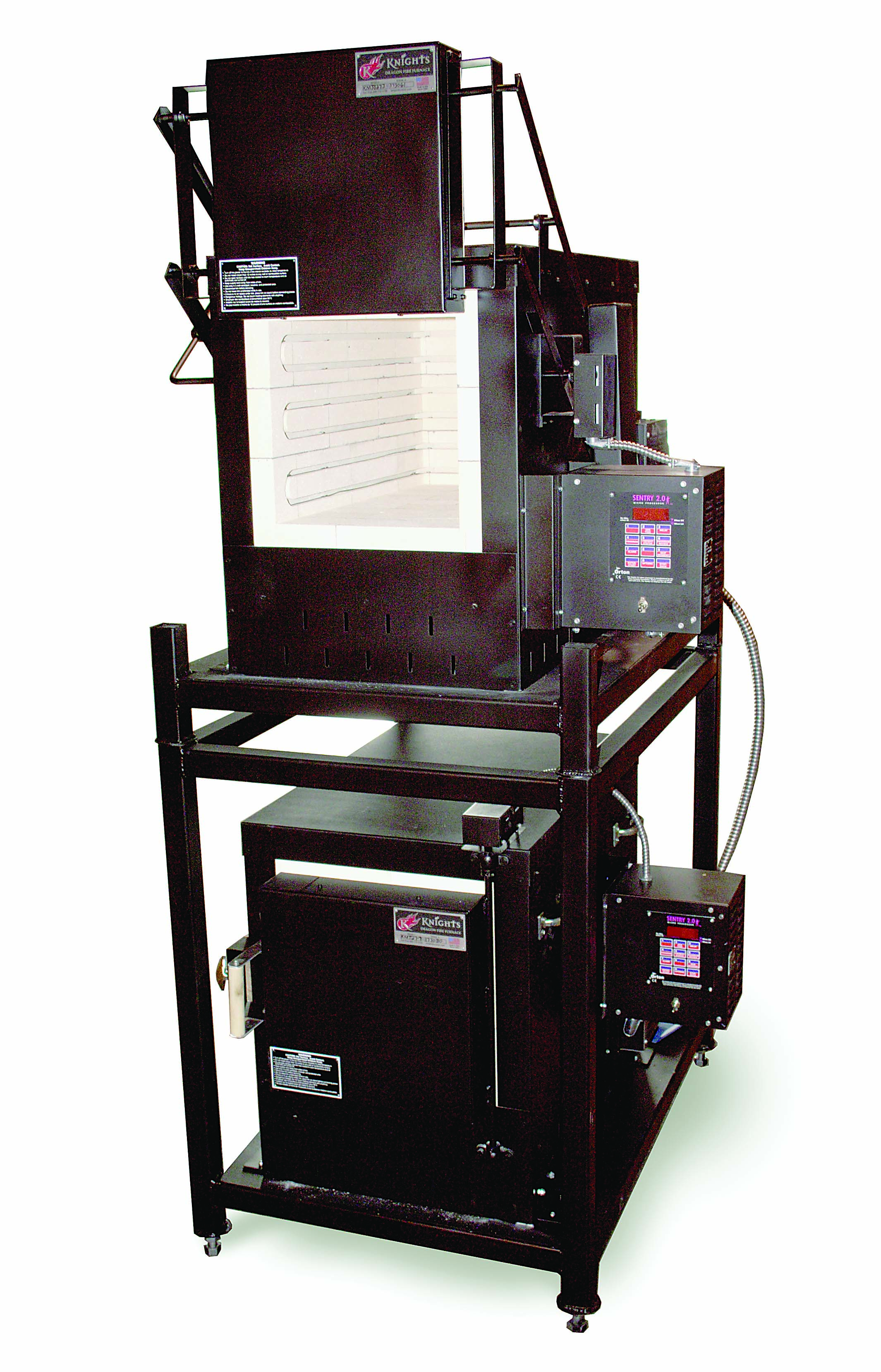

The KMTG-27 fire box furnace from Knights is equipped with a guillotine-style door. Image courtesy of Knights

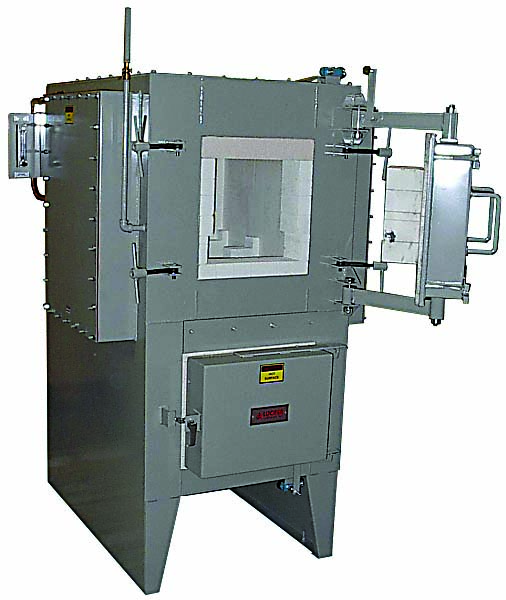

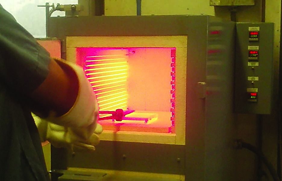

A worker heat-treats a part in a furnace from Lucifer Furnaces (top). Lucifer’s Model HS82GT-K18 dual-chamber, space-saving furnace (above is for hardening and drawing HSS and ceramics. Images courtesy of Lucifer Furnaces

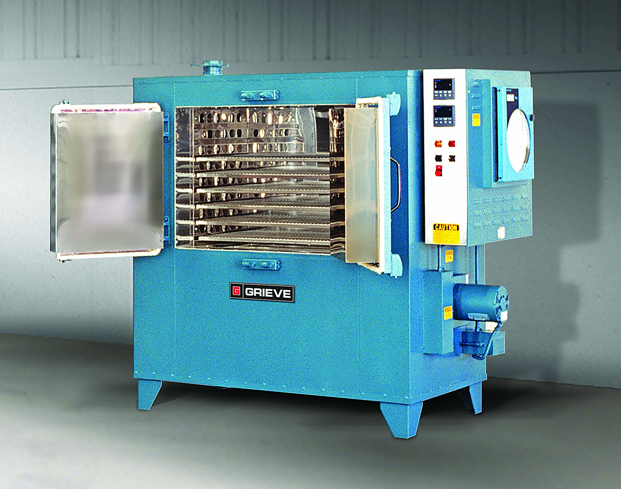

The No. 934 from Grieve is an 850° F cabinet oven that has 6″ insulated walls, an aluminized steel exterior and a stainless steel interior. Image courtesy of Grieve
