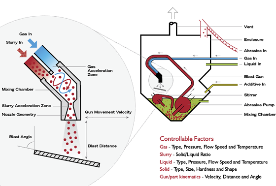

Cleanliness is next to godliness when preparing a cutting tool substrate for CVD or PVD coating deposition. The Sabre wet blasting system from Vapormatt Ltd. achieves a level of cleanliness that dramatically improves coating adhesion by removing the outer substrate skin and creating a “satin sheen” while imparting an anchor pattern, according to Managing Director Robin Ashworth. He added that the cleaned surface would reveal “nooks and crannies” when viewed under a microscope, with the average distance from the top of peaks to the bottom of the valleys equal to a third to a half the thickness of the coating being deposited.
In addition, the system produces consistent and controllable edge hones up to 100µm (0.0039") and other edge preparations, achieving edge radii within a ±5µm (±0.0002") tolerance, the company reported. Its wet blasting process combines solid media, liquid media and gas into a jet that can be directed at different angles and distances, then traversed over the faces and edges to be treated. “It’s a kind of loose-abrasive grinding process,” Ashworth said.

Vapormatt’s wet blasting process combines three phases of material (solid, liquid and gas) into a jet that can be directed at different angles and distances, then traversed over the tool surfaces and edges to be treated.

When processing round-shank tools, three boron-carbide nozzles, or guns, move in a choreographed manner on the Y and Z axes as they blast tools supported and rotating on 12 satellite turntables around the periphery of the main turntable, Ashworth explained. For inserts, an eight-gun head, or crown, on the X-axis blasts up to four pallets. The servocontrolled axes reportedly provide fast and accurate kinematics and positioning, with turntable speeds up to 40 rpm.
