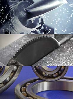

A PVD coating can extend the life of cutting tools,
such as drills and saws, as well as bearings. Image courtesy of SurfTech.
