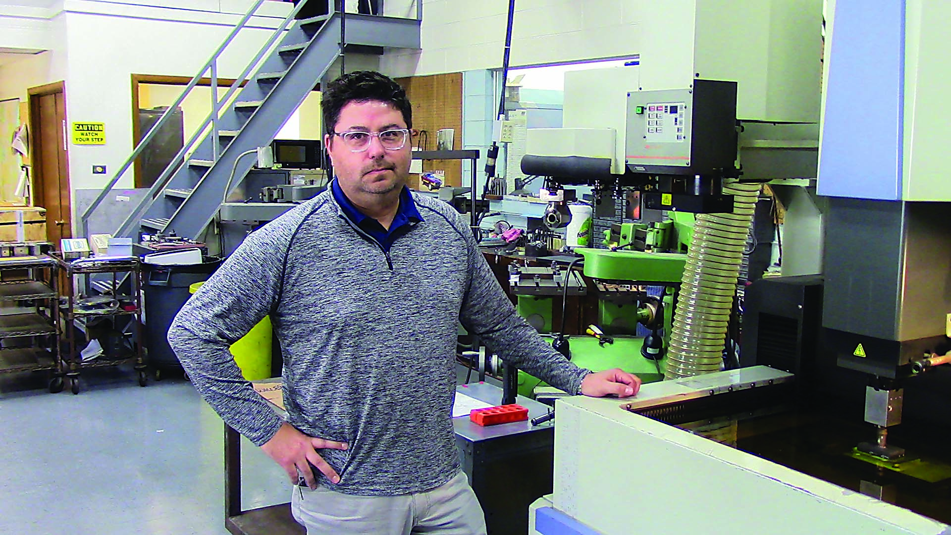

Pete Kambouris, vice president of Wisconsin Engraving, started working at the company as a summer job while in high school.

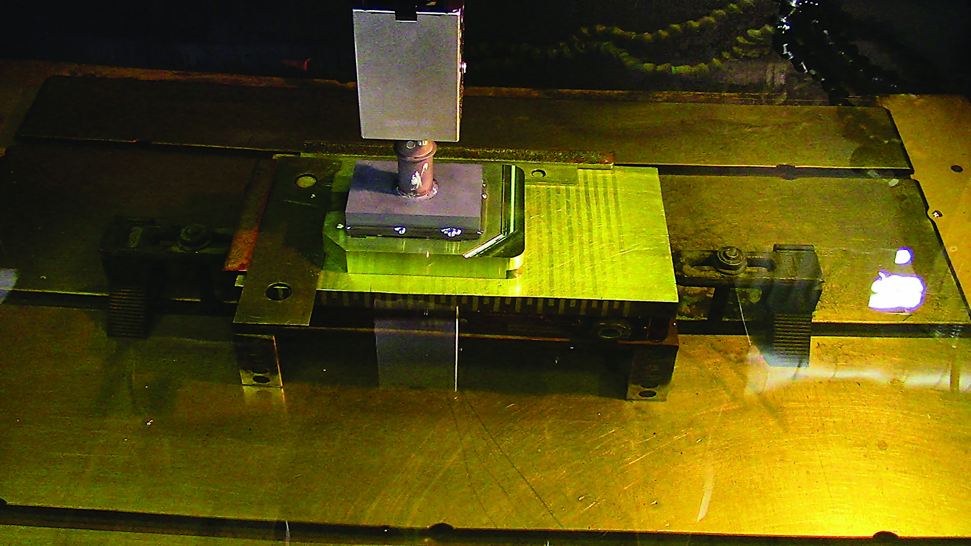

A part is EDMed at Wisconsin Engraving.
Due to electrode wear during EDMing, roughing and finishing electrodes are needed. Kambouris explained that the shop might begin roughing with a slightly oversized electrode to perform most of the burning and then switch to a more detailed electrode to sharpen the corners and “iron everything out.”
The required number of roughers and finishers depends on the application. If a customer requests a large number of roughers and finishers, say 20 of each, Kambouris said he will ask to see the CAD data and inquire about the workpiece material. With that information, he’ll discuss it with others at the shop. If they suggest that fewer roughers and finishers will do, Kambouris will tell the customer that if Wisconsin Engraving does the job in-house, the desired results may be achieved with as few as two of each.
