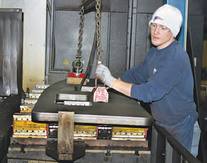

Webb said magnetic workholding was a good fit for TMF. “Their parts are very large and unusually shaped, and they have a lot of different sizes. They really needed something modular in its design and setup.” The MagVISE system enables users to selectively place the magnets as needed, he added. TMF decided to use 15 MagVISE ECB 120 magnets to hold the side plates. A turn of a handle activates or deactivates a 7 “×4 “×4 ” magnet. Each magnet provides a holding force of up to 2,640 lbs., depending on workpiece size and thickness.
Courtesy of Techniks
A TMF employee loads a large steel side plate onto an array of MagVISE ECB 120 magnets from Techniks.

To determine how to arrange the magnets on the machine table, shop personnel “laid all the parts on top of each other in ProE CAD software, then came up with the best pattern of magnets underneath the side plates to get maximum holding and maximum clearance for tools that go through the part,” Martin said.
With the magnets holding the side plates, individual setups for the seven different parts in the family were no longer necessary. Changeover time between machining of similar parts dropped from 20 to 5 minutes, most of which was consumed moving the parts to and from the machine.
“Now, when you release the magnets, the chips are free, so it takes a lot less time to blow them off the fixture,” Martin said. “Then you just turn a handle to lock each magnet down again. That’s what got us down to 5 minutes.”
