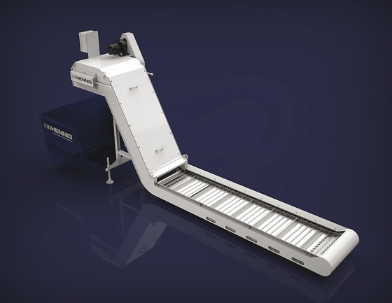

The sawtooth edge on a hinged-belt conveyor helps grab stringy chips and pull them out of a machine. Image courtesy Hennig.

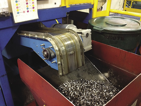

For shops that primarily machine ferrous materials, magnetic conveyors are commonly method of chip disposal. They use a series of rare earth or ceramic magnets mounted beneath a stainless steel conveyor belt to pull scrap up an incline. At the top, the magnets retract to release the scrap, which falls into a waste bin or another conveyor system.
Suderman said magnetic conveyors have no external moving parts, making them relatively jam-proof. By running the conveyor at a low speed, much of the cutting fluid that would otherwise be carried with the chips drains back into the machine. A basic system starts at around $10,000.

Machine protection provider Hennig Inc., Machesney Park, Ill., also makes and sells conveyors. Scott Cooley, chip conveyor and filtration system business manager, said the company offers several flavors, including magnetic conveyors, scraper-type conveyors for cast iron, bronze and brass machining, and general-purpose, hinge-style ones. Of these, hinged conveyors account for 90 percent of Hennig’s conveyor sales.
“Job shops might cut Inconel one day, brass or aluminum the next,” Cooley said. “In this situation, a hinged conveyor works best. It can handle long, stringy chips from stainless steel machining, very fine chips from cast iron machining and anything in between.”
A MagSlide conveyor can carry more than chips. In this application, fasteners are removed from a cold heading machine. Image courtesy Bunting Magnetics.
As the name implies, hinged conveyors use a cleated steel belt that looks like the tread on a battle tank to grab chips and carry them out of the machining area. Like a tank, the belt is rugged and handles heavy loads.

A hinged chip conveyor from Hennig. Image courtesy Hennig.

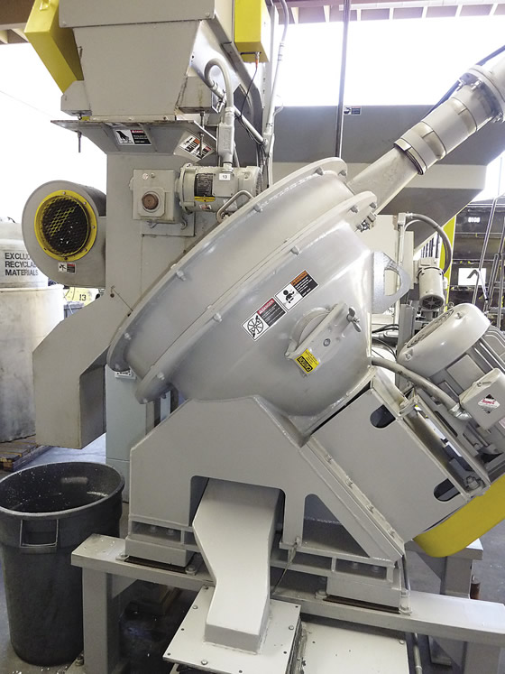

One solution is spinning. Centrifuges are the metal equivalent of heavy-duty salad spinners; they quickly turn wet chips into dry ones. Some shops keep it simple: Fill the chip carts on a regular schedule, pull them to a central processing system, dump them in the hopper and push the button. “There’s some manual labor involved, but it’s minimal,” Hook said. The alternative is an automated system that conveys the chips to the processing unit. Depending on the shop, this can cost $100,000 to $1 million or more.

A PRAB shredder and wringer combination unit reduces bushy wads of metal and separates fluids.

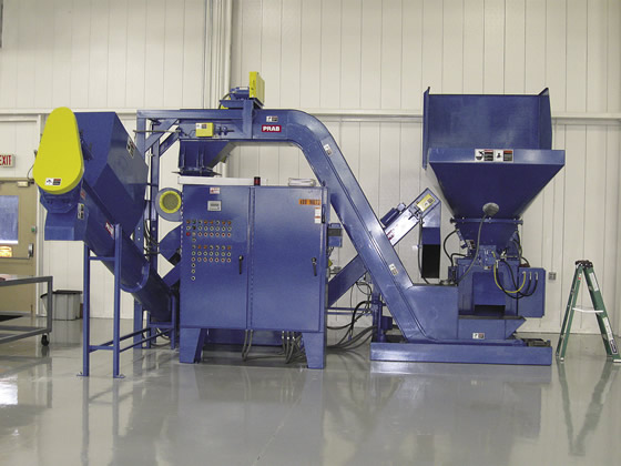

A complete, automated chip processing system from PRAB includes volume reduction, a shredder, a centrifuge and conveyors. Image courtesy PRAB.
“We have a customer in Iowa that machines a lot of aluminum,” Zeitz said. “Due to their large chip volumes, and because the scrap hauler was charging a fee for every pickup, the company invested in a system that shreds and compacts the material into briquettes.”
Depending on the briquetter, compacted aluminum briquettes weigh around 125 lbs./cu. ft. and are nearly 10 times denser than loose chips, saving considerable storage space. And scrap dealers sometimes pay two to three times as much for briquettes compared to noncompacted material.

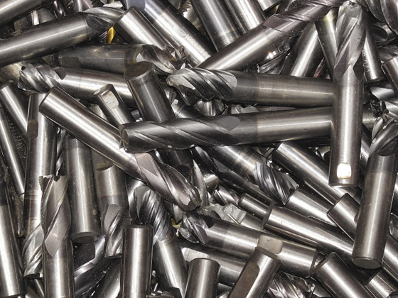

Only 5 percent of the world’s reserves of tungsten ore−the primary ingredient of cemented carbide cutting tools−are in the U.S. Some reserves are located in Russia, Canada and other countries, but China holds 60 percent of the planet’s tungsten reserves, according to the U.S. Geological Survey. Bill Walter, president of carbide recovery firm Carbide-USA, Elmira, N.Y., said this is a darned good reason to recycle carbide in the U.S. “The Chinese already have most of the ore. Domestic recycling gives us more raw material to work with at home.”
Carbide-USA quotes recycled carbide and accepts shipments of carbide scrap materials that weigh under 70 lbs. (31.8 kg). It also accepts carbide sludge from oil- and water-based coolant filtration systems, as well as cartridge-type filters. Carbide sludge is typically shipped to Carbide-USA in barrels.
Broken and worn carbide endmills are ready for recycling. Image courtesy Carbide-USA.
Cemented carbide is tough stuff. For those wondering about the monstrously powerful process used to mash scrap inserts and endmills into tungsten powder, it’s not that exciting. It ‘s called zinc processing and works when graphite “boats” are loaded with scrap carbide, then filled with molten zinc. The carbide gradually swells like a marshmallow over a campfire, leaving a porous cake that is ground into tungsten-cobalt powder, suitable for blending with virgin tungsten.
The other recycling process is electrochemical and breaks cemented carbide into its constituent components. It’s a bit more complex, but yields tungsten powder indistinguishable from its original form. “It becomes virgin material again,” Walter said. “You can use it to create anything−endmills, drills, inserts, whatever. It’s more expensive than zinc recycling, but gives you greater flexibility with the product.”
Whatever the extraction process, Walter said there needs to be greater effort towards recycling. “At current rates, shops can get around $8 per lb. or more for clean scrap carbide, but most figures show recycling rates at only 35 percent. It needs to be much higher. It’s good for the environment and, provided we keep it here, good for the U.S. as well.”
