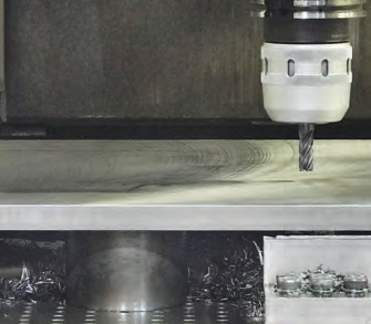

Alpha Machining and Grinding applies Gorilla Mill endmills along with A-Pod permanent electromagnetic workholding from Alpha Workholding Solutions to cut costs and improve productivity when machining steel plates.

The A-Pod system consists of portable, round magnetic poles 3.8" in diameter and 2.8" tall, which each create 1,450 lbs. of vertical clamping force. Unlike traditional electromagnets, A-Pod permanent electromagnets require only a short charge of electricity to activate or deactivate grip, assuring workholding security if power fails.
Murawski noted that the magnetic force penetrates upward only about 0.3" into the workpiece, so chips don’t stick to the top or in pockets and slots, eliminating the possibility of chip recutting. Machining time is greatly reduced as well, because the entire plate periphery can be milled without stopping to reposition workholding clamps.
The A-Pod magnets bolt into and slide along the T-slots of the machine table for positioning. When Greg Thibodeau, operations manager, looked to streamline part changeover, AMG manufactured a subplate for the table of the gantry mill where the plates are machined. The subplate is drilled and tapped 1" on center with 3⁄8" holes to match the bolt hole on each A-Pod magnet. AMG bolts the magnets to the subplate in a pattern that enables all plate sizes to be machined without changing the workholding setup. Depending on the plate being milled, eight to 24 magnets are employed.
After workholding issues were addressed, Thibodeau consulted Dick Hagenbuch, sales engineer for manufacturing services company Turning Concepts, Matthews, N.C., to find ways to speed up the plate machining operations. Hagenbuch suggested application of Gorilla Mill endmills from CGC Tools Inc., Waukesha, Wis. Gorilla Mills combine variable flute spacing with variable helix angles to minimize harmonics that generate vibration. According to CGC Tools President Kevin Cranker, the resulting smooth cutting action permits milling at higher feed rates and extends tool life.
For pocket and slot milling, Thibodeau replaced 4-flute, ½"-dia., 1¼" length of cut, variable-spacing-only, solid-carbide endmills with similar-sized tools from Gorilla Mill. For peripheral milling where chip clearance is less of an issue, 5-flute Gorilla Mills are applied.
Thibodeau said the new mills run at a 25 percent higher feed rate than the previous tools, reducing cycle time 25 to 30 percent. Applying the Gorilla Mills improved tool life, Hagenbuch said, adding “We’ve been able to reduce the cost per cubic inch of metal removal to a degree the shop didn’t think possible.”
