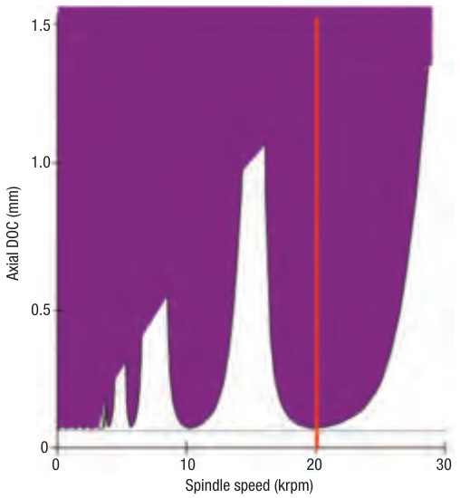

Figure 2. Stability lobe diagram measured for a short, 2-flute, solid-carbide endmill in a 20,000-rpm spindle. The vertical axis shows the axial DOC, and the horizontal axis shows the spindle speed. The shaded areas represent chatter, and the red line indicates the maximum spindle speed.

From a machine dynamics point of view, it is well known that the most stable speed—the biggest stable zone in the stability lobe diagram—occurs at the spindle speed where the tool passing frequency is equal to the natural frequency of the most flexible mode. For the 20,000-rpm spindle with a short, stiff, 2-flute endmill, this most stable speed would be:
05 Machine Technology 3.tif
As noted, 15,000 rpm is not the maximum operating spindle speed. It is less well-known that the minimum part of the stability lobe—the least stable speed—is about a third higher than the best speed. For this example, the speed 33 percent higher than 15,000 rpm is 20,000 rpm. The spindle designers’ rule of thumb and the selection of a short tool with two flutes have placed the worst spindle speed at the maximum spindle speed, the speed many users will select (Figure 2).
What can you do? In the absence of a measurement, make an educated guess. It is likely that the most stable speed for a short, 2-flute endmill in a high-speed spindle is about 75 percent of the maximum operating speed. A 20,000-rpm spindle often “prefers” to run at about 15,000 rpm, and the metal-removal rate is often much higher than at maximum speed. CTE
