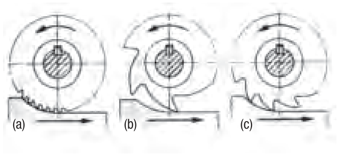

Figure 1. Effect of number of teeth, or inserts, on milling.
(a) Too many teeth in the cut may block chip evacuation because of too little space between the inserts.
(b) One tooth in contact with the workpiece will cause vibration and chatter, resulting in a poor surface finish, dimensional inaccuracy and excessive tool wear.
(c) Complete dynamic stability of the cutter is achieved when at least two inserts are engaged with the workpiece.
Dynamic stability when facemilling extends tool life and improves surface finish by preventing the cutting edge from chipping. Complete dynamic stability of the cutter is achieved when at least two indexable inserts are engaged with the workpiece (Figure 1c). The author developed a formula showing how the two inserts (Z2) would be in contact with the workpiece:

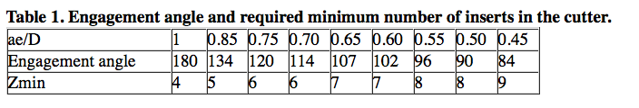

Z2 = Zmin × α ÷ 360° (1)
Zmin = Z2 × 360° ÷ α = 720° ÷ α (2)
Where Z2 is 2, Zmin is the minimum required number of inserts in a facemill and α is the engagement angle.

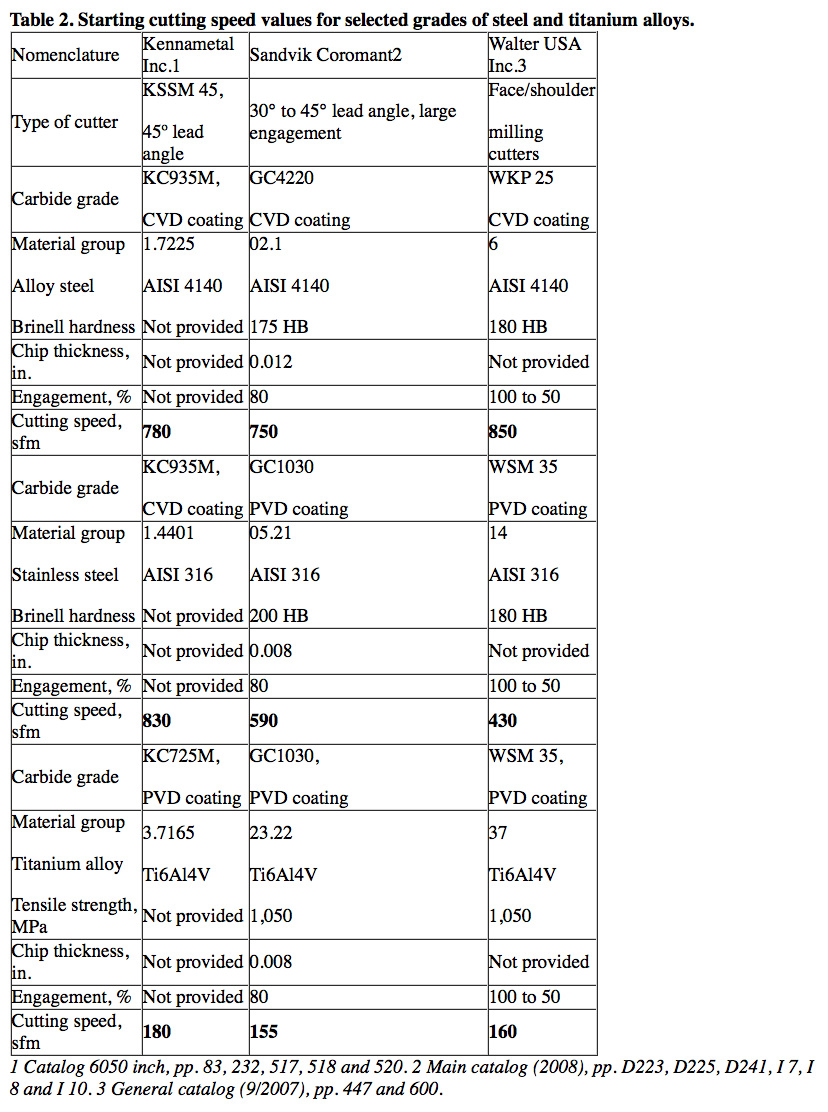

Cutting speeds vary greatly based on recommendations from cutting tool manufacturers (Table 2 on page 66). Cutting speed data is based on the type of work material, its hardness, cemented carbide grades, chip thickness and the ratio (ae ÷ Dc) of the radial WOC (ae) to the facemill diameter (D).

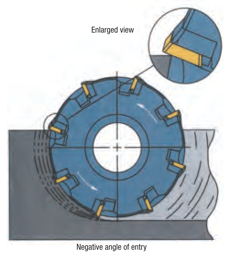

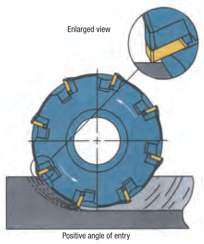

Negative angle of entry
Courtesy of Kennametal
Figure 4. A negative angle of entry is recommended whenever possible because the insert contacts the workpiece at its strongest part, which is away from the cutting edge.
Selecting cutting speed is a challenge. There are no set criteria for choosing cutting speed because too many independent variables are involved in milling. If machine shops are not sure about the cutting speed, they should contact their cutting tool supplier for recommendations.

4. Radial WOC defines the cutter’s angle of entry into a workpiece, which can be negative or positive. If the cutter’s centerline is on the workpiece (ae is greater than D ÷ 2), the angle of entry is negative (Figure 4). A negative angle of entry is recommended whenever possible because the insert contacts the workpiece at its strongest part, which is away from the cutting edge. If the cutter’s centerline is not on the workpiece (ae is less than D ÷ 2), the angle of entry is positive (Figure 5). A positive angle of entry is not recommended because the insert contacts the workpiece with the cutting edge, which is the weakest part. That can result in insert chipping. If a positive angle of entry is necessary, then a more shock-resistant carbide grade and a cutting edge with a T-land or hone are recommended.

Enlarged view
Figure5.tif
Positive angle of entry
Figure 5. A positive angle of entry is not recommended because the insert contacts the workpiece with the cutting edge, which is the weakest part. That can result in the insert chipping. If a positive angle of entry is necessary, then a more shock-resistant carbide grade and a cutting edge with a T-land or hone are recommended.
