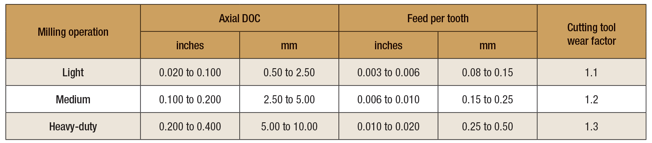

The cutting tool wear factor (Tf) is a dimensionless coefficient included in formula (2) to correlate tangential cutting force with increasing wear of the cutting inserts when milling. When applying new or just indexed cutting inserts for a short time (20 to 25 percent of tool life), the cutting tool wear factor (Tf) is 1.0; when milling until the inserts must be indexed or replaced (100 percent of tool life), the following cutting tool wear factors are recommended according to the type of operation (Machinery’s Handbook, 29th Edition, p. 1,086).
Table. Responses from metalworking professionals describing milling operations by optimal ranges of axial DOC and feed per tooth.
  • Light and medium facemilling: 1.10 to 1.25
  • Extra-heavy-duty facemilling: 1.30 to 1.60

5. Cutting tool wear factor, Tf = 1.1 (represents “light milling,” see Table)
