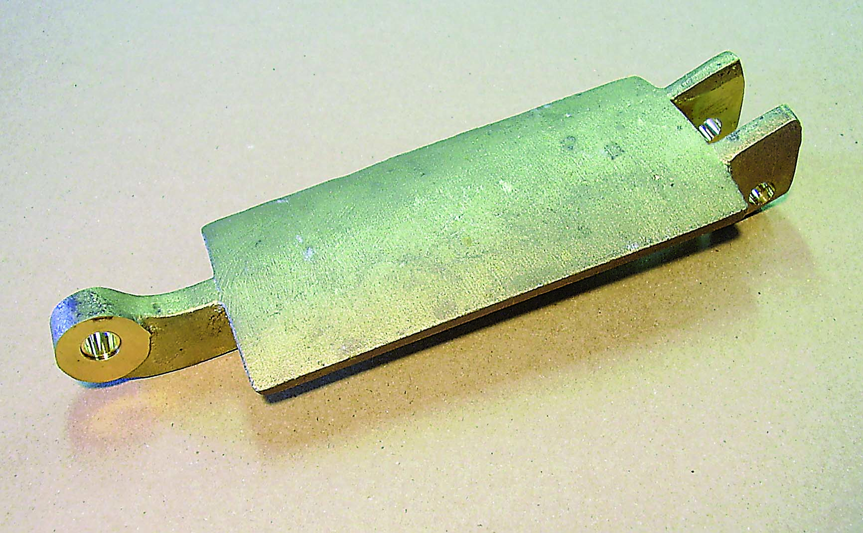

Workholding for milling parts with curved surfaces is challenging. This column will show how to use a milling vise to clamp a casting with a curved-surface datum (Figure 1). The datum surface is 76.2 mm × 157.2 mm (3″×6.189″) with a radius of 106.4 mm (4.189″).
The two ears on the right are machined on a parallel inside surface with a tolerance of 25.45 mm/25.4 mm (1.002″/1″) between the two. The ear on the left is machined on an outside surface 12.7 mm/12.6 mm (0.5″/0.496″) thick. The two cross-holes are reamed perpendicular to the machined surfaces. Parallelism and perpendicularity are 0.5°. This level of accuracy requires the part to be machined in one clamping. A computer graphics program was used to design the workholding and toolpaths and choose the tool.

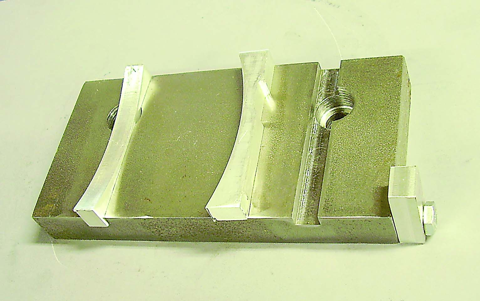

To hold the part in the vise, a pair of soft jaws were made from 19 mm × 76.2 mm (0.748″×3″) cold-finished 1018 steel. The front jaw has grooves that accept 9.5 mm-thick (0.374″) aluminum inserts with a 106.4 mm radius. The width tolerance of the casting can be +2.54 mm (+0.1″), so the center of the radius is 39.624 mm (1.56″) above the vise bed. A work stop is attached to one corner of the front jaw with a ¼-20 screw. Figure 2 shows the front jaw with inserts and the work stop.

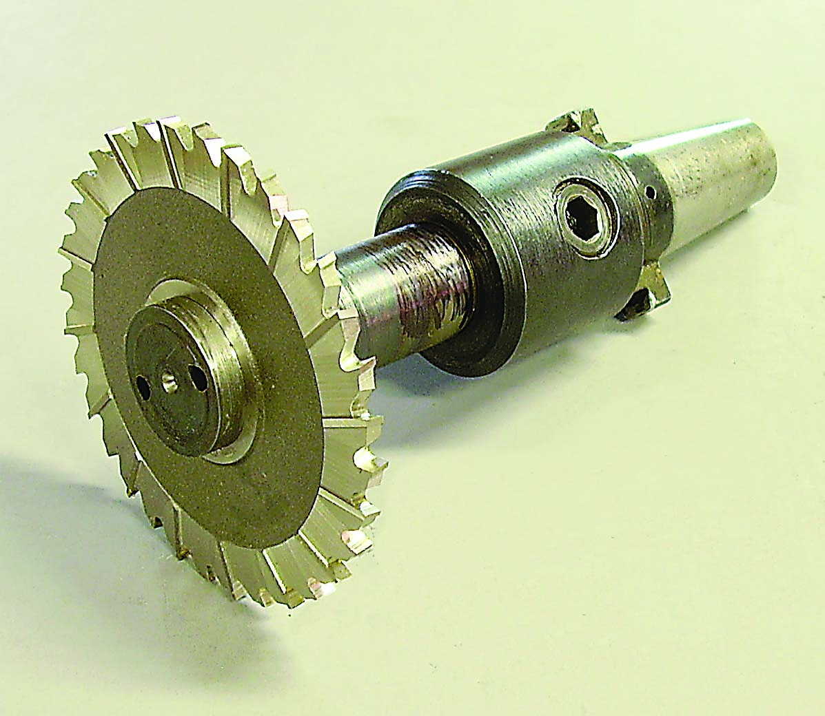

A 101.6 mm × 4.8 mm × 25.4 mm (4″×0.189″×1″) side milling cutter was applied to cut the flats. A special toolholder (Figure 3) was made to mount in a 25.4 mm endmill holder.

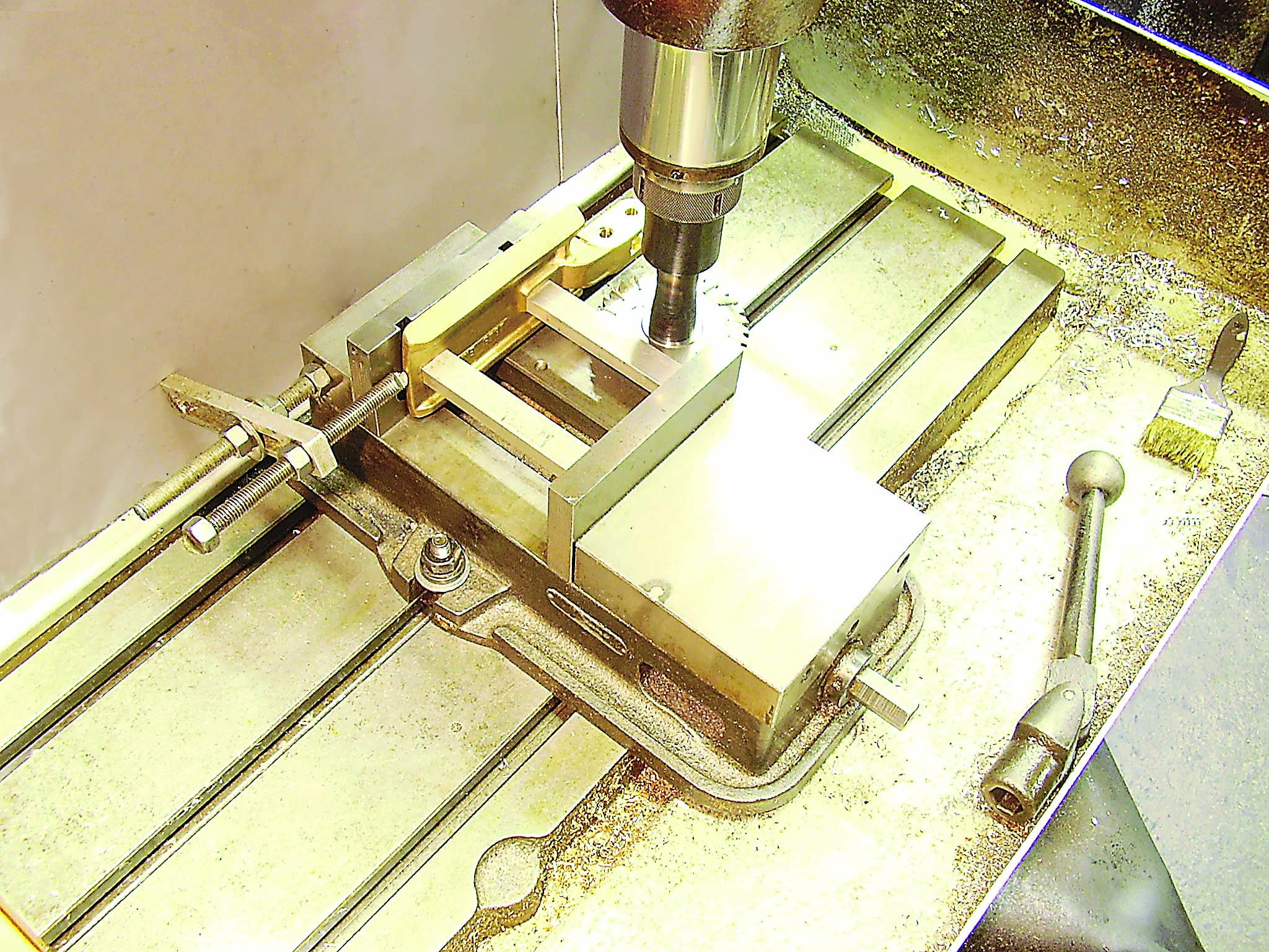

When using a vise setup with multiple clamping points, ensure that all clamping points are in compression. Workpieces vary in dimensions, which is especially true with castings. Figure 4 shows the clamping setup. To assemble for machining, first put a casting against the front jaw and determine the correct vertical position. Then position the struts, which are held up by spacer blocks. Snug the vise, but don’t tighten it. If a strut is loose, fill the gap between it and the back jaw with a feeler gauge. Then tighten the vise. A bunch of loose feeler gauges work well here.

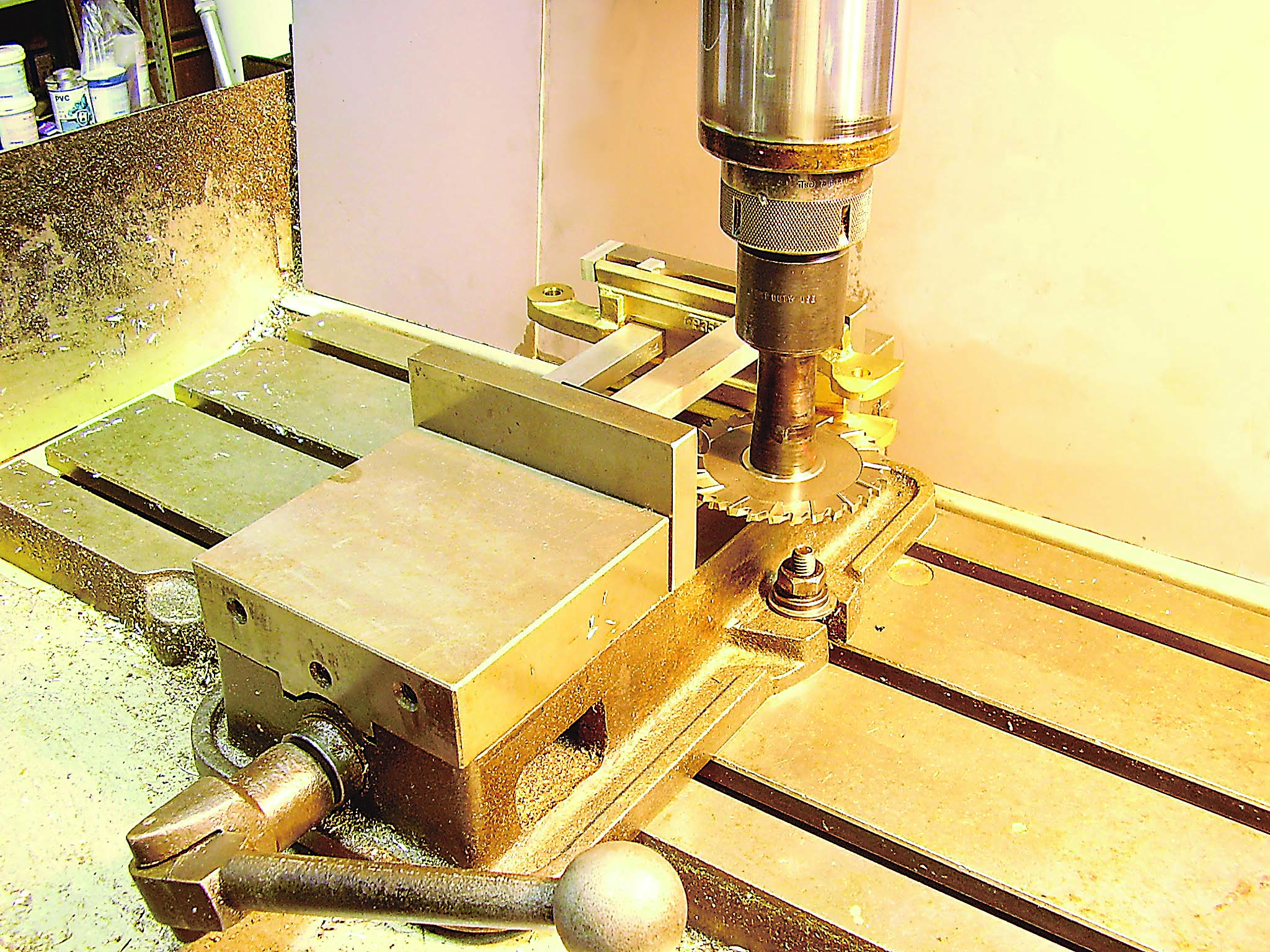

Once the setup is validated, document it with photos. Figure 5 shows the setup ready to roll.

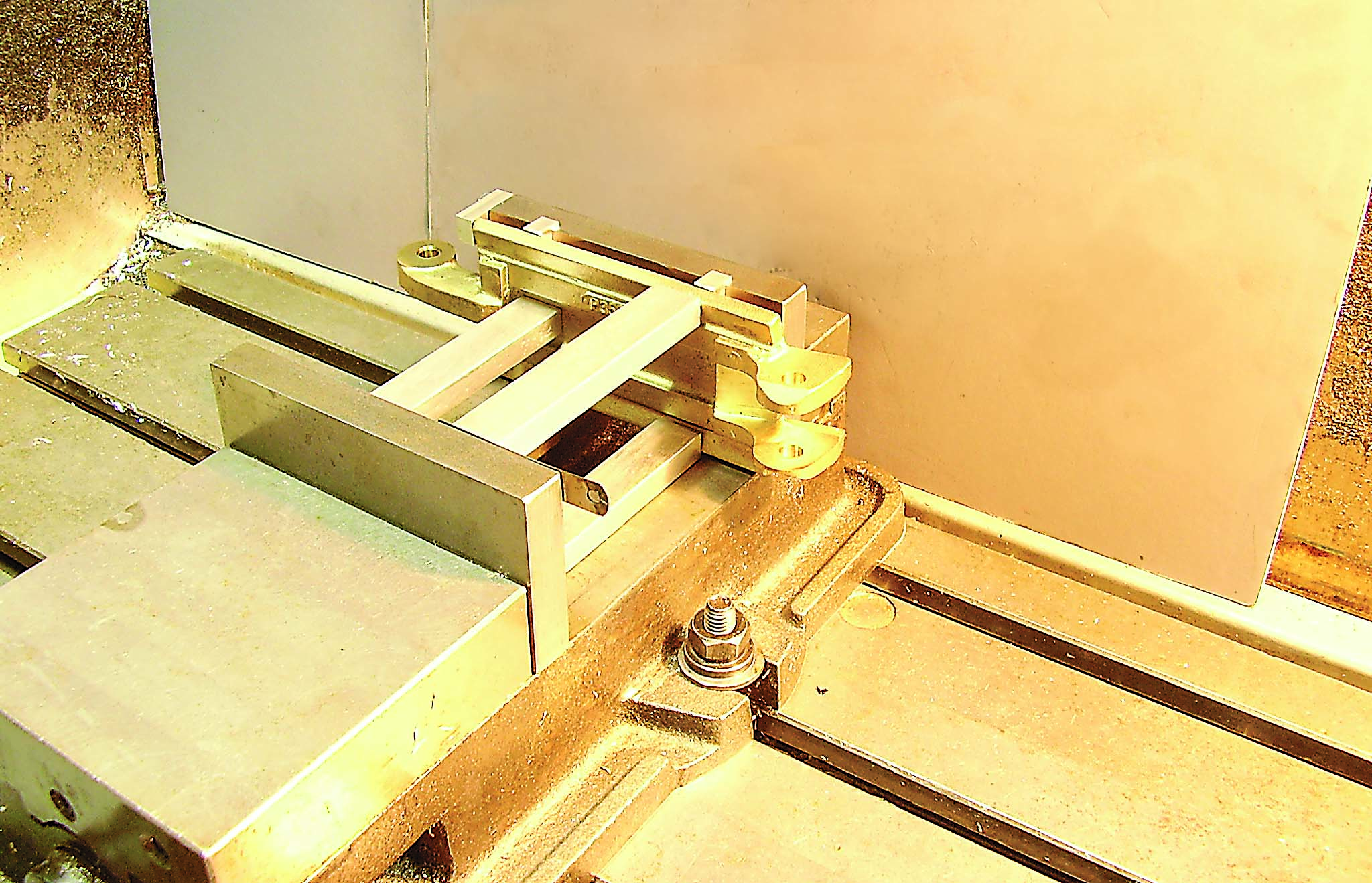

Figure 6 shows another casting being machined. It uses the same 76.2 mm-tall jaws but without the inserts. Two struts are between the back jaw and the workpiece. Here the cutter passes over and under the strut on the right.
This setup uses a different work stop that is versatile, rigid and easy to make. A ½-13 hole in the side of the vise accepts the stop. The stop is made from a piece of 12.7 mm × 25.4 mm aluminum bar, some ½-13 threaded rod, nuts and washers. If a workpiece hangs out from the side of the vise, it’s no problem.
