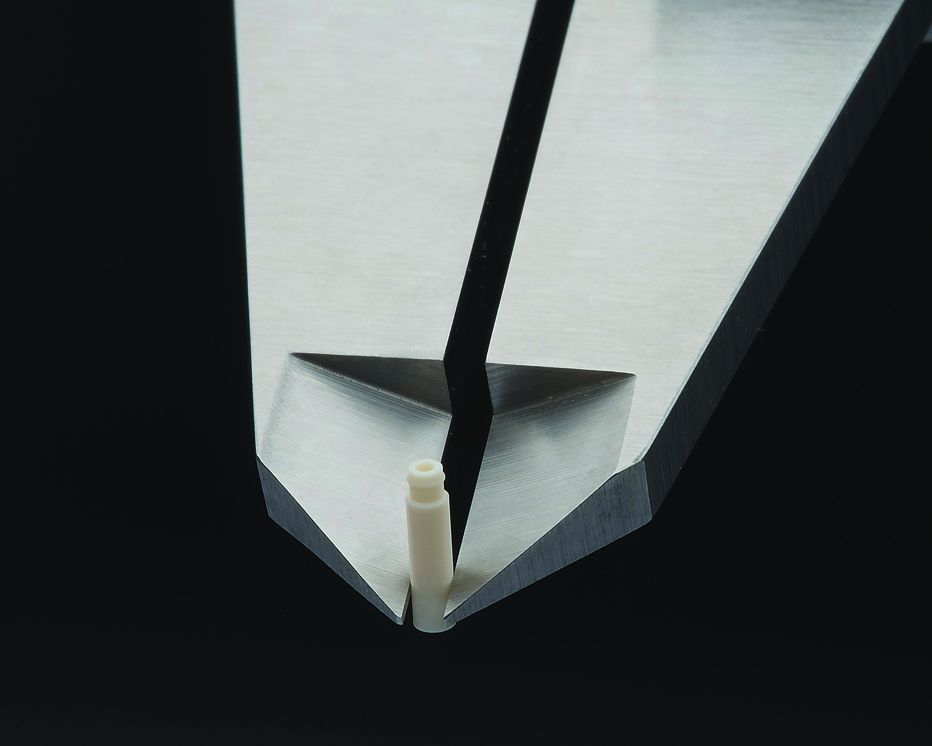

While Donatelle machines implantable-grade materials, East Coast Precision Manufacturing LLC, Chester, Conn., specializes in machining plastics. Small medical parts machined by East Coast include insulators for cabling used in medical device electronics. One such piece measures 0.020″ (0.508mm) in diameter, features a 0.008″-dia. (0.203mm) hole and was produced to a tolerance of ±0.0002″ (0.0051mm), noted Mark Rohlfs, company president.
To make such components, East Coast uses conventional CNC machines adapted to run small parts. An example of these adaptations is using coolant filters to help prevent machine operators from confusing chips with the tiny parts.
“If coolant with chips in it is flooding the parts, the chips can be as big as the parts,” Rohlfs explained. “We can’t sort the parts if we’re not filtering the coolant to make sure it doesn’t pick up chips of any consequence.”

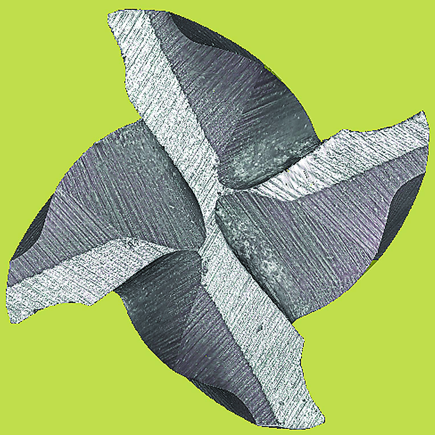

EDM Department’s 3D optical metrology system was used to produce this profile of a microtool. Cutters like this machine EDM electrodes used to create microscale medical parts. Image courtesy of EDM Department.
Another challenge the company encounters is using multiple microcutters that are supposed to be the exact same size but are not. Even minute variations in size matters For example, if EDM Department bought 20 tools that are supposed to be 0.0050″ (0.127mm) in diameter but half are actually 0.0052″ (0.132mm) in diameter, the company wouldn’t want to use all of them in a single machining run. That small difference in diameter would make a significant difference in the size of the machined EDM electrodes.
To address the problem, EDM Department uses a high-resolution metrology technology called variable focus to inspect the cutters it purchases. The technology produces 3D solid models of the cutters, with resolutions down to a nanometer. With such accurate measurement data, the company can then sort the 0.0050″- and 0.0052″-dia. cutters into two groups and use them in separate machining runs.
“We modify our NC program and use the larger cutters together,” Levy said. “We just need to know how much to modify the cutter compensation.”

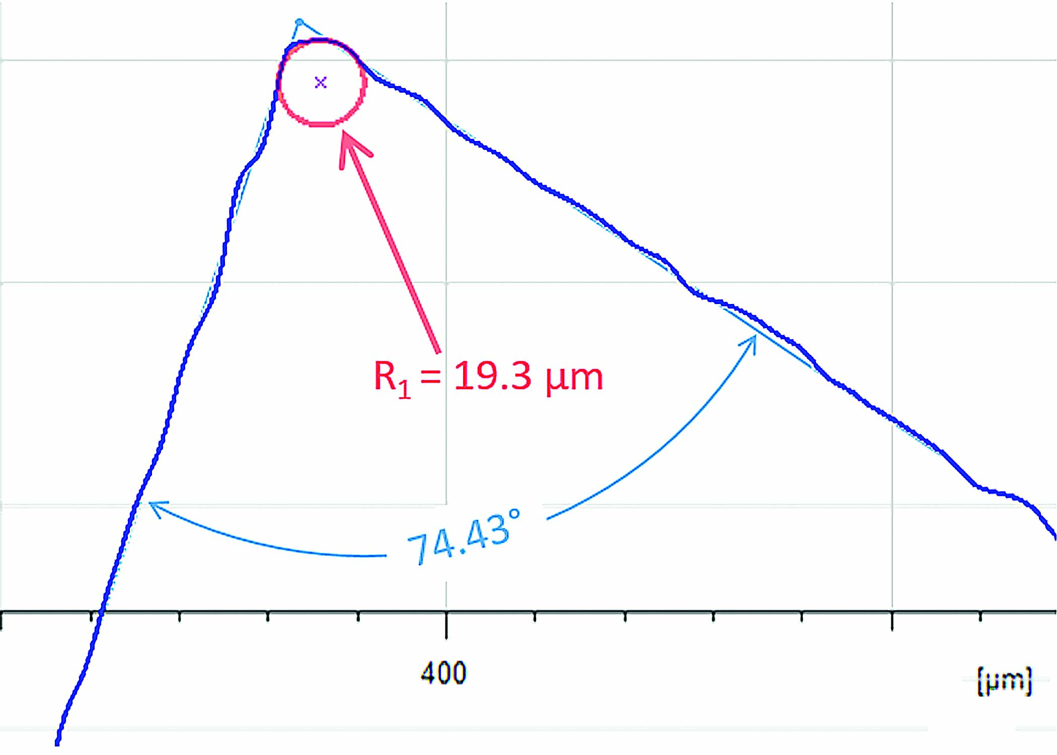

Using its 3D optical metrology system, EDM Department measured the corner radius of a micromedical component by automatically best-fitting a perfect circle (shown in red) to the 3D data set. The EDM wire size used to create this corner was 0.020mm in diameter. Image courtesy of EDM Department.
