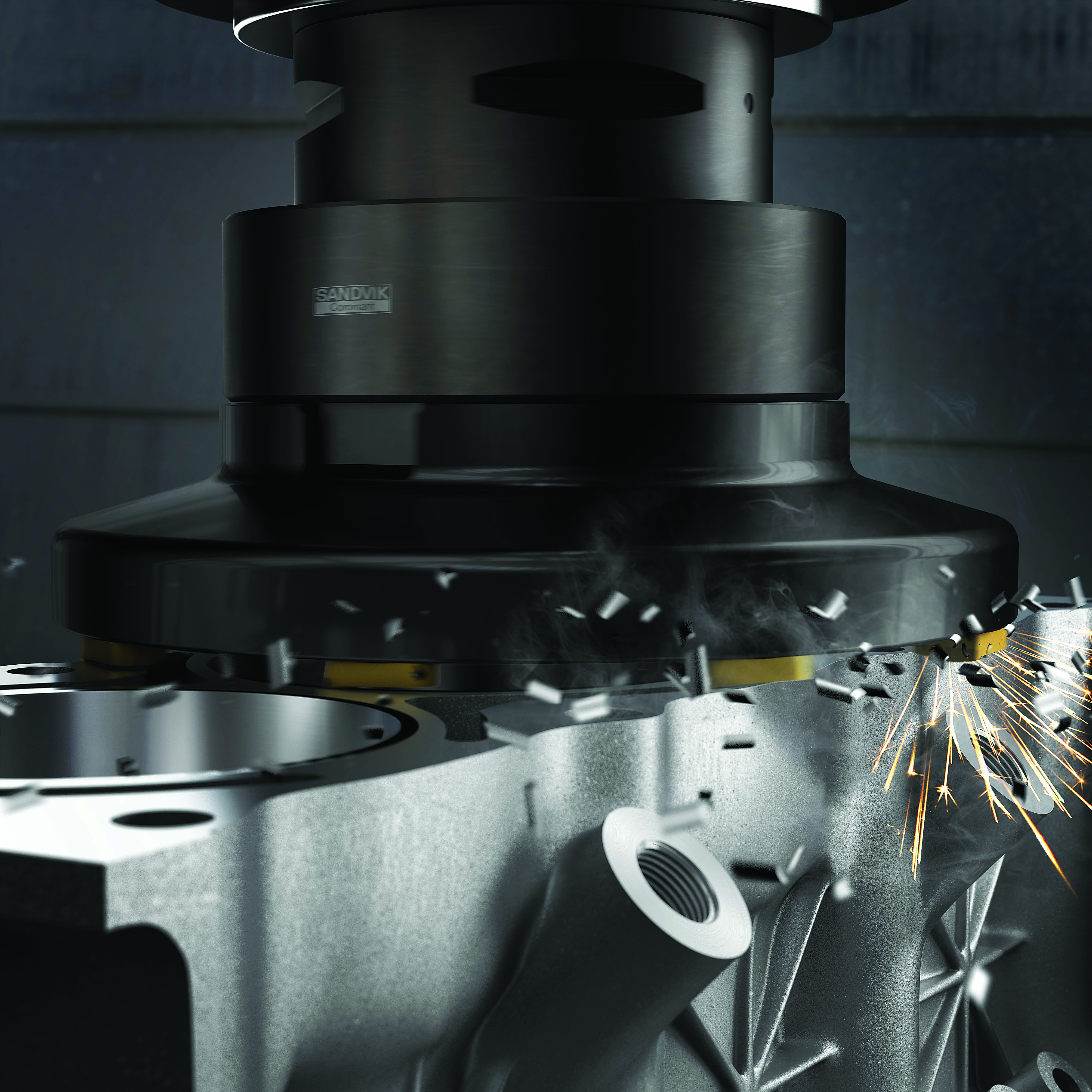

Sandvik Coromant’s new M610 bimetal cutter targets automotive engine applications for finishing aluminum blocks with gray cast-iron sleeves. Image courtesy of  Sandvik Coromant

Among the latest offerings is the M610 bimetal cutter targeted at automotive engine applications for machining gray cast-iron blocks with aluminum cylinder sleeves. Another, the M5B90, is aimed at all-aluminum applications.

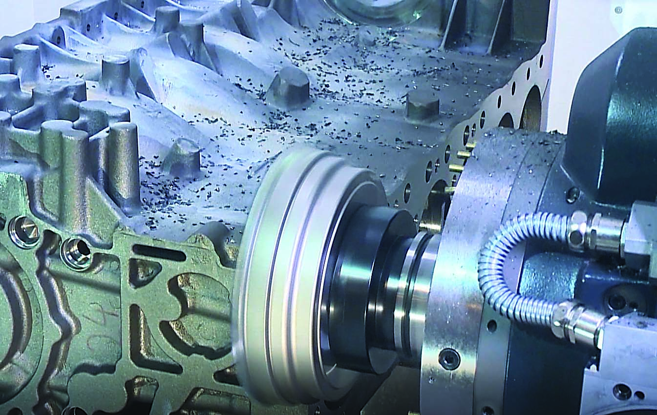

Ingersoll’s new insert series in the octagon facemill family, shown in an automotive finishing operation, includes several carbide, a silicon nitride and two PCBN grades. Image courtesy of Ingersoll Cutting Tool
Automotive engine blocks have two different types of material: cast iron and aluminum. DeRoss said the M610 cutter’s PCBN insert can cut both materials without leaving burrs and scratches on the surface. “It’s a real clean cut, and it’s a finishing operation, giving you a nice finish. It doesn’t flake the edges off of cast iron. Sometimes cast iron gives you what’s called frittering. The M610 eliminates frittering and also cuts the aluminum cleanly.”
In the past, DeRoss noted, the whole block would have been cast iron. Manufacturers didn’t worry about weight, even though it meant more fuel consumption. “Now everyone’s trying to go lighter, but all-aluminum blocks are not a great solution for longevity. So they are using aluminum with cast-iron sleeves.”
Whereas most cutters on the market have adjustments for inserts that need to be pre-adjusted up and down, the M610 cutter requires no adjustments. “This is just load it up and run it,” DeRoss said.

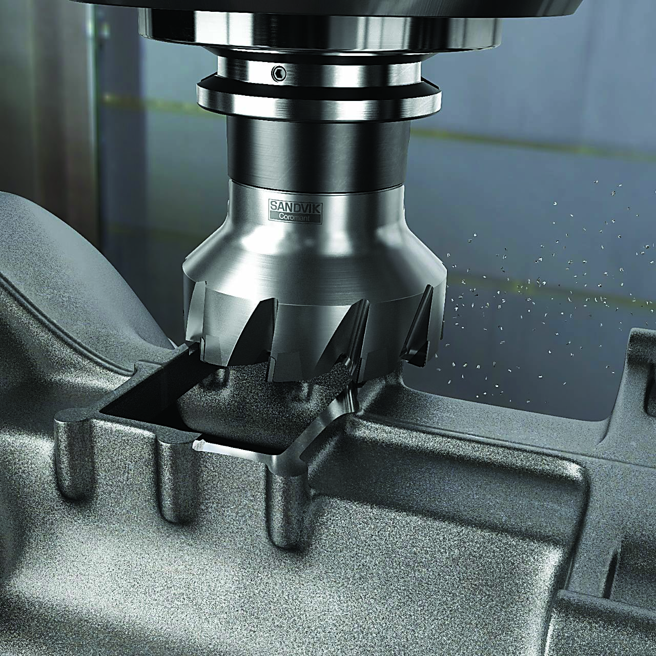

One of the new Sandvik Coromant facemilling tools, the M5F90, is shown facemilling an aluminum automotive part. This cutter enables roughing and finishing aluminum parts in a single operation, and machining parts without burring, scratching or chipping. Image courtesy of Sandvik Coromant

Ingersoll recently developed an insert series that includes several carbide, a silicon-nitride and two PCBN grades. According to Yordy, the PCBN inserts ave either a durable negative rake with a landed edge that can be broadly applied or a keen positive, laser-ablated rake face with a sharp edge for the freest possible chip formation. All the inserts—carbide, SiN and PCBN—sit in the pocket with negative axial inclination and provide a larger seating area than other designs that have the same inscribed circle size but with a positive axial inclination. For wear detection and to identify unused edges, both styles of PCBN inserts are thinly coated with gold-colored TiN.
