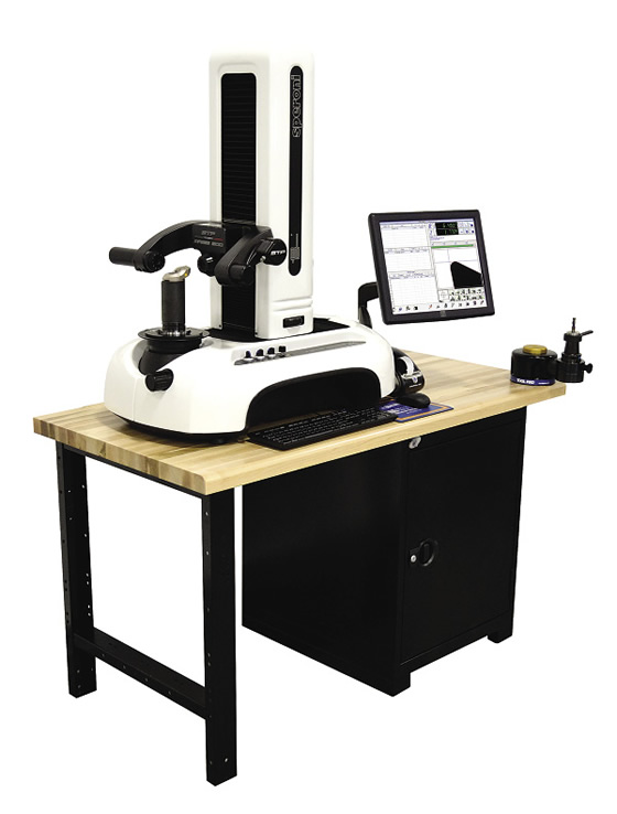

BIG Kaiser’s Speroni Magis “total tool setting solution” package features the addition of a workbench, storage cabinet, Tool Pro assembly device and a label printer.

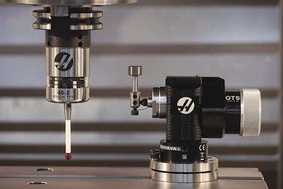

For machinists who are resistant to offline presetting, Haas Automation Inc. offers tool setting probes as a presetting alternative (see photo on below).
“The primary advantage of tool setting probes is the operator doesn’t have to measure the tools offline, then transfer those values into the machine tool,” said John Nelson, applications manager for the Oxnard, Calif.-based machine tool builder. “The time it takes to measure a given tool is relatively small compared to the additional labor that could go into putting each tool into the presetter, measuring it, marking the values and inputting them into the machine control.”
Haas tool probes can measure the length and diameter of the tool mounted in a lathe or mill. After making the initial setup, the automatic measurement cycle can be run at any time on any tool, ensuring tooling is still within tolerance during machining.

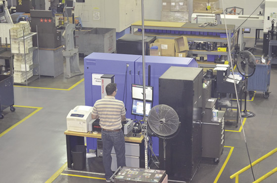

A machine operator in Parlec’s in-house machine shop measures a tool on a Parlec series 1550 TMM presetter.
