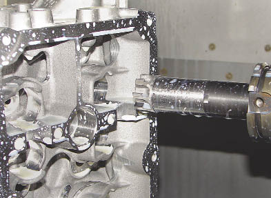

The steel bucket rides in a bore cast into the head. Machining of the bore includes an ID roughing pass, which also creates the spring seat, followed by a finishing pass to achieve a tolerance of ±15µm and 0.8μm Ra surface finish.
Courtesy of Mapal
PCD-tipped, replaceable-head HPR reamers from Mapal extend tool life and permit higher cutting rates in an aluminum machining operation at Ford’s Lima Engine Plant.
The plant originally finished the bores with PCD-tipped reamers mounted in shrink-fit toolholders. The reamers had nonadjustable, fixed flutes. When worn, Ford returned the entire reamer to the toolmaker for resharpening or retipping.
The problem with the tools was inconsistent performance. “Occasionally,” Burgei said, “a flute was too far out of concentricity with the rest and you would get ugly retract marks in the part because the tool would flex back when retracted.” In addition, new tools sometimes chattered upon initial application because of thin walls in the part and manufacturing inconsistencies in the tools.
As a result, tool life was shorter than expected. The Cross Hüller CNC machine tools used to process the heads were programmed to run each tool for a certain amount of cutting time. “A lot of tools were not reaching their programmed tool life because they would start to chatter or the retract lines would get bad,” Burgei said. “You had tools that didn’t run right from the start, and then you had tools that could not reach their programmed life. Those were the two major reasons for pulling the tools early.”
Seeking to improve the finishing operation, Burgei consulted with the local sales representative for toolmaker Mapal Inc., Port Huron, Mich., who recommended HPR reamers. The tools have a PCD-tipped head that is clamped to a monoblock shank with a threaded spindle, which pulls the head into the shank. Positioning repeatability is within 2µm when a head is replaced, and presetting isn’t required when the tool is put back on a machine. Ford returns worn heads to Mapal for lapping or tip replacement. In addition to PCD, the heads can be configured with PCBN, carbide and cermet blades and applied in materials other than aluminum.

The new reamers improved machining performance and lowered tooling costs. “We’ve gotten about four times the life that we were getting from the PCD-tipped reamers,” Burgei said. “Where we ran maybe for 4 or 5 weeks with the other tools, we are now running 4 or 5 months.”
Cutting rates improved as well. “We are running at 5,500 rpm and an 8,620-mm/min. feed, two times faster than what we did with the previous reamers,” Burgei said.
