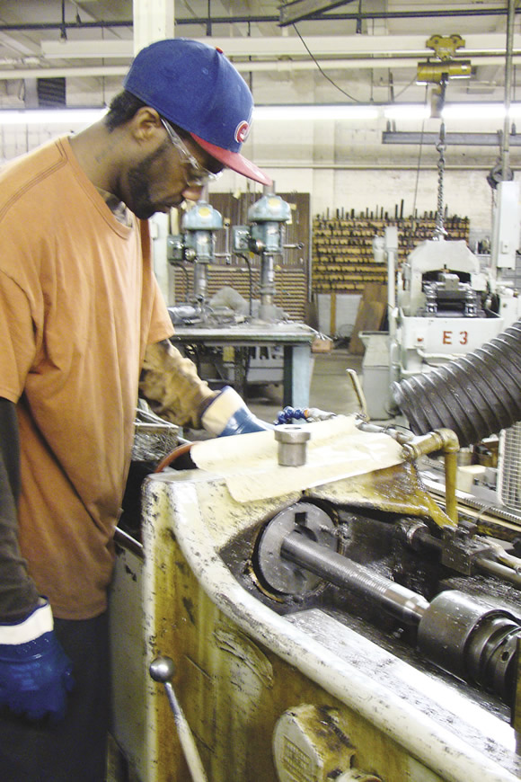

Operator Salvador Leanos at V W Broaching Service sets up a ball valve to broach an internal spline.

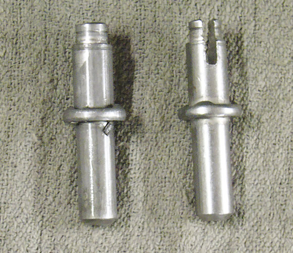

“I miss the old days of having jobs like broaching 11.5 million seat belt pins that held seat belts into a carriage,” Roschman said. “Those were wonderful days, when the customer would literally back up the truck with broaching jobs for us.”

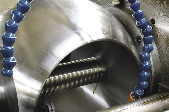

DSC00810.tif

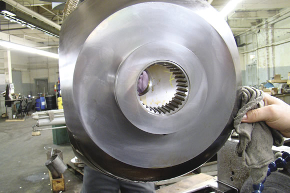

V W Broaching used a horizontal broaching machine (above) to cut an internal spline on this 24″-dia. ball valve. Below: In a few seconds, this spline was broached.

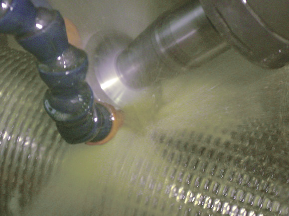

The secret to a fine finish, said Tim Espy, production manager, is in the gradual increase of tooth height over the length of the tool. This rise per tooth determines the amount of material removed and chip size. The rule of thumb for rise per tooth is 0.0025″, he added, but varies according to finish requirements.

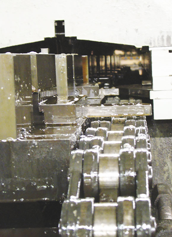

DSC00830.tif
The chain on a continuous-chain broaching machine pulls parts through the work envelope (above), where multiple cutting tools remove stock. Below: A part before and after a slot is cut on the tip using a continuous-chain broaching machine.

Horizontal broaching was the first broaching method developed and is still the most common way to cut internal shapes and forms, such as keyways. The company has several of these machines, each distinguished by its length of cut, which is a direct function of its total stroke and tonnage. In a typical horizontal broaching of an internal feature, the workpiece is fixtured to a base plate and the cutting tool is pulled through the piece. “We can cut up to 84″ in length using one pass, with a maximum of 25 tons,” Hanna said.
On a recent project, Hanna and his team used an old Colonial horizontal machine to broach an internal spline on a 24″-dia. stainless steel ball valve. While this valve is large, the company can broach larger products, including a 48″-dia. valve that required removal of the machine’s front panel to set up the workpiece.

“The internal spline on that valve takes about 10 seconds to complete,” Hanna said. “If that were on a gear-shaping machine, it might take a couple hours.”

A high-speed broaching method often employed at V W Broaching Service is continuous-chain broaching, which Espy refers to as “a train.” This train consists of a series of workpieces mounted to “cars” that enter an enclosed cutting envelope. The workpiece is chain-pulled past the cutters, each of which removes a small amount of stock. One recent job called for a deep slot to be cut into the tip of a part, reaching the required 3⁄8” depth with the help of 18 modular cutting tools.
This method is geared to high-volume production of external features and is extremely fast and efficient, Espy said. Another benefit is that it does not require a one-piece, solid broach; instead it uses smaller, modular cutting tools. “Instead of ordering a $10,000 broach and waiting weeks for it, we can make this tooling package in-house for a nominal fee and be up and running that day,” Espy said.
