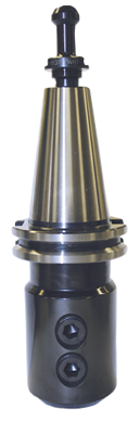

A toolholder from Briney Tooling Systems is tooled with a high-torque retention knob from JM Performance Products. Image courtesy Briney Tooling Systems.
JM Performance Products Inc., Fairport Harbor, Ohio, then informed Briney about its high-torque retention knobs. According to JM Performance Products, a conventional retention knob, when installed in a toolholder, will deform the precision taper because of the elastic nature of a toolholder's thin walls. This taper deformation prevents a toolholder from properly mating with the spindle of a CNC machine. When the toolholder expands, taper contact can be reduced by as much as 70 percent. When properly installed with a retention knob socket and torque wrench, the patent-pending design of the high-torque retention knobs prevents toolholder deformation.
London concurred that a conventional retention knob changes the taper form of a toolholder and creates a permanent deformation that, however small, negatively impacts machining performance, toolholder rigidity and tool and spindle life. "We have done our own internal study and found torque on toolholders as low as 15 ft.-lbs. could cause warpage," he said.
Briney switched to the high-torque knob and ran the program, London said. "At first it didn't visually look like there was much of a difference." However, it only required 15 minutes or less of polishing to impart the required surface finish rather than 60 to 120 minutes.
In another application on the same machining center, polishing time to achieve an 8-rms finish went from 28 to 2 minutes for a part made of YXR-33 HSS hardened to 50 HRC after switching to the high-torque retention knob. Again, London pointed out that the shop did not see the difference the knob made until an operator began to hand polish the part. "This reason alone was enough to switch over all of our milling centers to high-torque retention knobs," he said.
